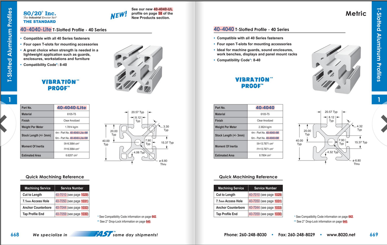

I was lookin at using something like this, but I would have to modify the laser cut base and top, and possibly use different bearings?
