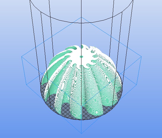

When loading a 260mm round part into Repetier-Host, it gives the Collision X and the part is enclosed in a Square Cube that is obviously outside the circular bed of the Rostock Max v2.
If I Scale the part drastically, almost half size, the "Collision" goes away and the Box is such that it fits inside the bed.
I have a 270mm Printable Bed, and want to print a 260mm Round Part.
How do I do this?
Is it the .STL drawing causing this?
Is there a Repetier-Host setting error? (I am quite sure they are set for the Rostock Max v2)
Should I use another Software? I like Matter Control, but I am not familiar enough with the settings to use it.
How do I do this?

I ran into the same problem when I first tried to print the Akemake Spiral Speakers. It is quite frustrating.
I found, with a lot of help from this forum, that a good work around is to just lie to Repetier about the printer. Repetier will believe you and proceed happily along. To do this:
1) Open Repetier.
2) Pull down the Config Tab and click on Printer Settings or press Control-P.
3) In the Printer Setting Window, click on the Printer Shape Tab.
4) Go down to the Printable Radius block and increase the number to a value that will enclose the corners of the part box.
5) Click OK and return to Repetier.
Proceed with Slic3r and if it protests telling you the part is too big, ignore it and tell it to proceed anyway.

Sorry, under the Slicer Tab, click on the "Configure" Button. When the page opens, click on the "Print Settings" Tab. Under this tab click on the "Skirt and Brim" line. When this opens, set the "Loops" register to "0".
