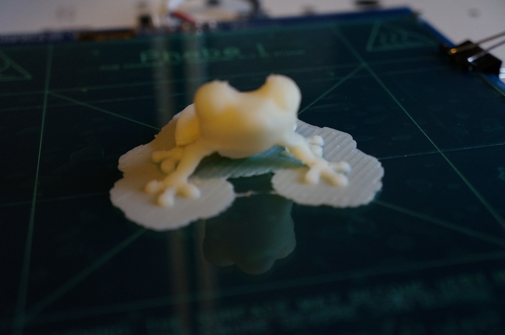

Something other than a calibration shape just for a change of pace.
The is using Ultimachine natural ABS, 240 degrees, 0.2mm layer height, it's a pretty good test of stringing, the front legs are a lot like the hollow pyramid, but the print is more interesting, this print is just finished and without any cleanup.
It's a fairly tricky print in ABS because of the steep overhang of the frogs belly.
Not perfect, but not bad for now.

Looking great, congratulations

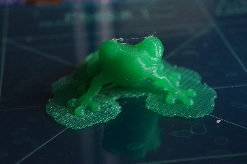

And once more this time in Ultimachine Green PLA
I've spent no time tuning the PLA setting, it's basically the same settings, but with the temperature set to 200 hotend, 60 bed.
For cooling I have 120mm fan to one side of the bed sitting on top of a 3 inch riser, running at 50% for the entire print, works pretty well, I think I'm going to try mounting a 200mm fan to the top plate angled so the air blows to the center of the bed.
Some strings around the legs, I'll probably drop the temperature to 190, increase the retract slightly, but again a pretty nice print.

Looks great, how much retraction are you using and what do you slice with?

I use KisSlicer for almost everything including this model, I'll resort to Cura if KisSlicer has an issue with the model which does happen occasionally.v8tony wrote:Looks great, how much retraction are you using and what do you slice with?
Tony
Those prints are 5mm retraction @ 55 mm/s, and 10mm of wipe, the PLA print has 0.3mm of Z-Lift.
Wipe is a KisSlicer feature, where the head backtracks over the previous print line after the retract, but before the move, getting rid of a lot of the nozzle dribble.

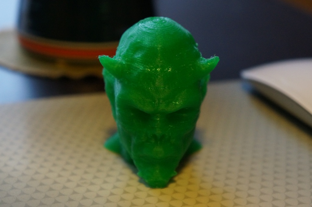

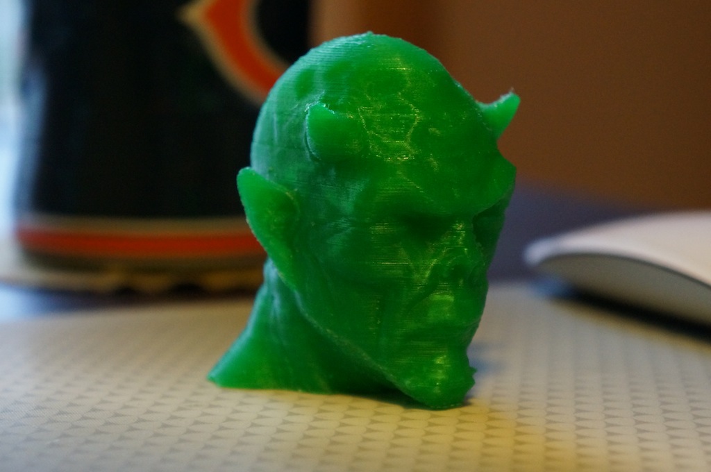

And another print from Sundays "messing with PLA" day, this is scaled to 70% of the original size, 0.2mm printed at higher speed than the frog, retract at 7mm but otherwise identical settings. I tried printing this at 190 and it failed, so the print is again at 200, there are a couple of perimeters on the model that didn't go down completely cleanly, which with the translucent PLA is usually a sign of not printing quite hot enough, so I'll prob ably go up to 210 with this plastic.
