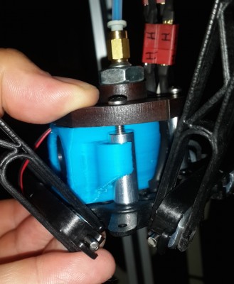

The fan shroud that i printed seems to be just a little bit too big. I would say about 2 mm or so. The fan just pops in, it is not a snug fit, and while trying to assemble it to the hot end, it seems like it may also be a couple of mm to tall.
It also seems to me that it is bending the hotend supports to the sides, they still fit, but i feel some stress on the nuts and bolts.

If that picture is shown with the two bolts for the aluminum spacers fully tightened the shroud is WAY taller than the aluminum spacers, then yes, it is definitely TOO tall.
I would take it out, pre-heat the bed and extruder, check the scripts VERY CAREFULLY, then do a complete calibration.

The nuts were not done up, but i was holding it tight. I saw no reason to do the nuts as clearly it would not have fit together.

Yikes! That doesn't look right...
The fan should be a pretty snug fit in the shroud. Usually I have to really jam those suckers in there.
That being said, I'd say double check your scaling in your slicer software, if you're using it. Too tall+too snug+too wide=scaled too large I would think.

Not snug at all. There is a 1 mm gap between the side of the fan.

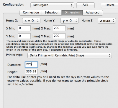

I noticed that before I had entered radius instead of diamater so corrected that...
Do I need to edit the X min and X Max?

Redoing everything now.
Z height was 336.98
now it is 389.385
Z height was 336.98
now it is 389.385

I used artexmg's method for calibrating and i feel that it was not only easier but also more accurate.
Part started printing fine. Finest print i have ever printed. But at %96 the part got detached.
But the dimensions were accurate and the fan fit in snugly.
