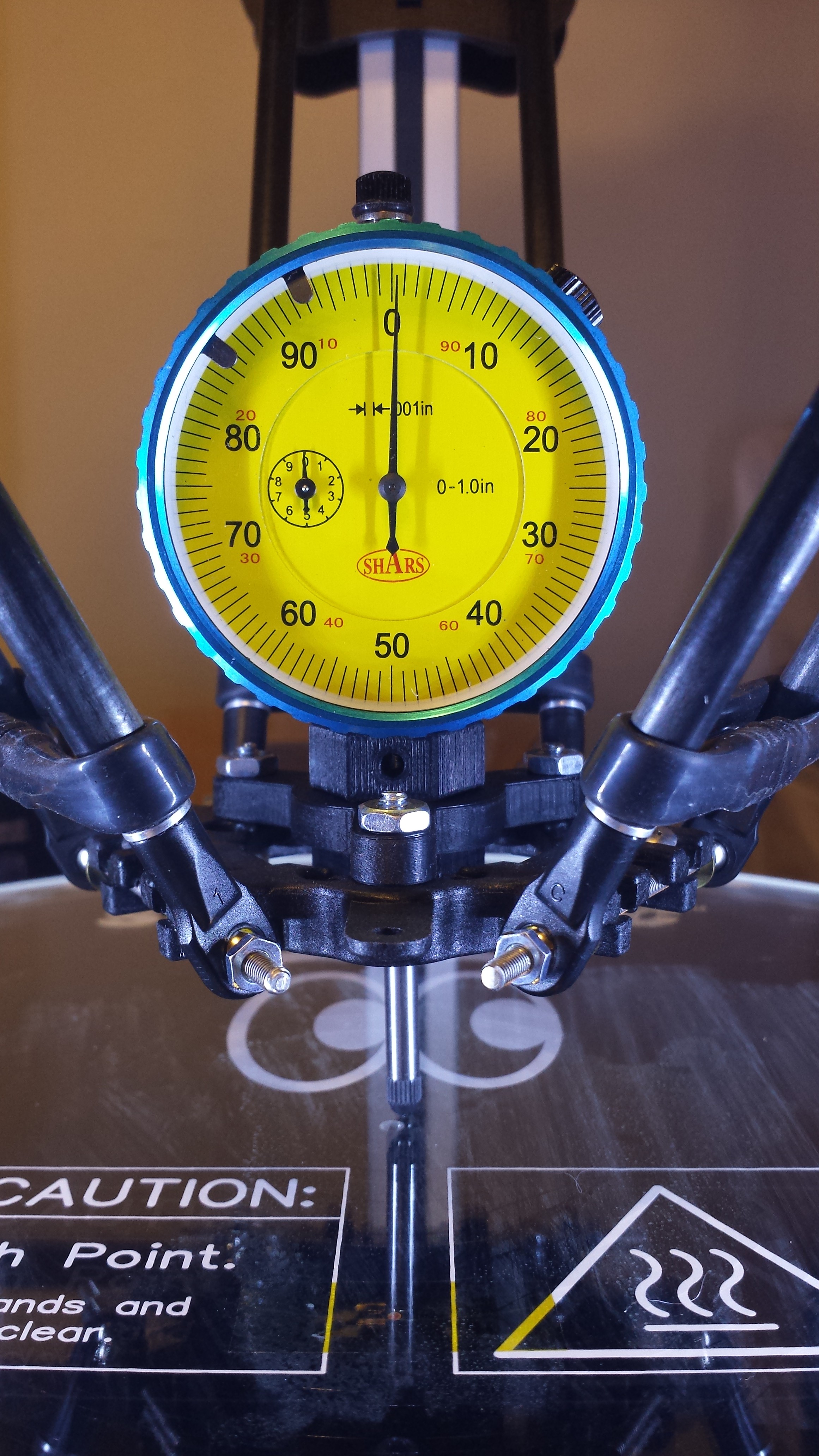

Mine went together in just under the 20 hours they predict. I went with the V6 head and have to say I love it! Though read up on PLA jams with all metal hot ends. Not a huge issue but one that must be kept on your mind while printing with PLA and the V6 head. I would suggest one purchase above all else. Spring for a cheap dial indicator and your life will be far easier and your prints will be out of this world! Keeping the calibration to within .001-.002" is easy with one and makes a huge improvement over the paper "feel" method. Let me know if you need a file for the mount. I can send over both the E3d V6 mount files and the one for the calibration dial which uses the same mount to keep things simple.

...and a source for the dial indicator itself. I love that yellow face. *laughs*

Here is the link for the dial.. http://www.ebay.com/itm/300916001666?_t ... EBIDX%3AIT It shows a white and yellow face but I liked what they sent over so did not bother to raise the issue.
Here is the file for the Dial mount
dial indicator holder e3d mount R3 flats.STL
The hole for the mount is TIGHT so it holds. I did a tiny bit of rat file and it slides on and off just right. it is made to go in the mount for the E3d V6
