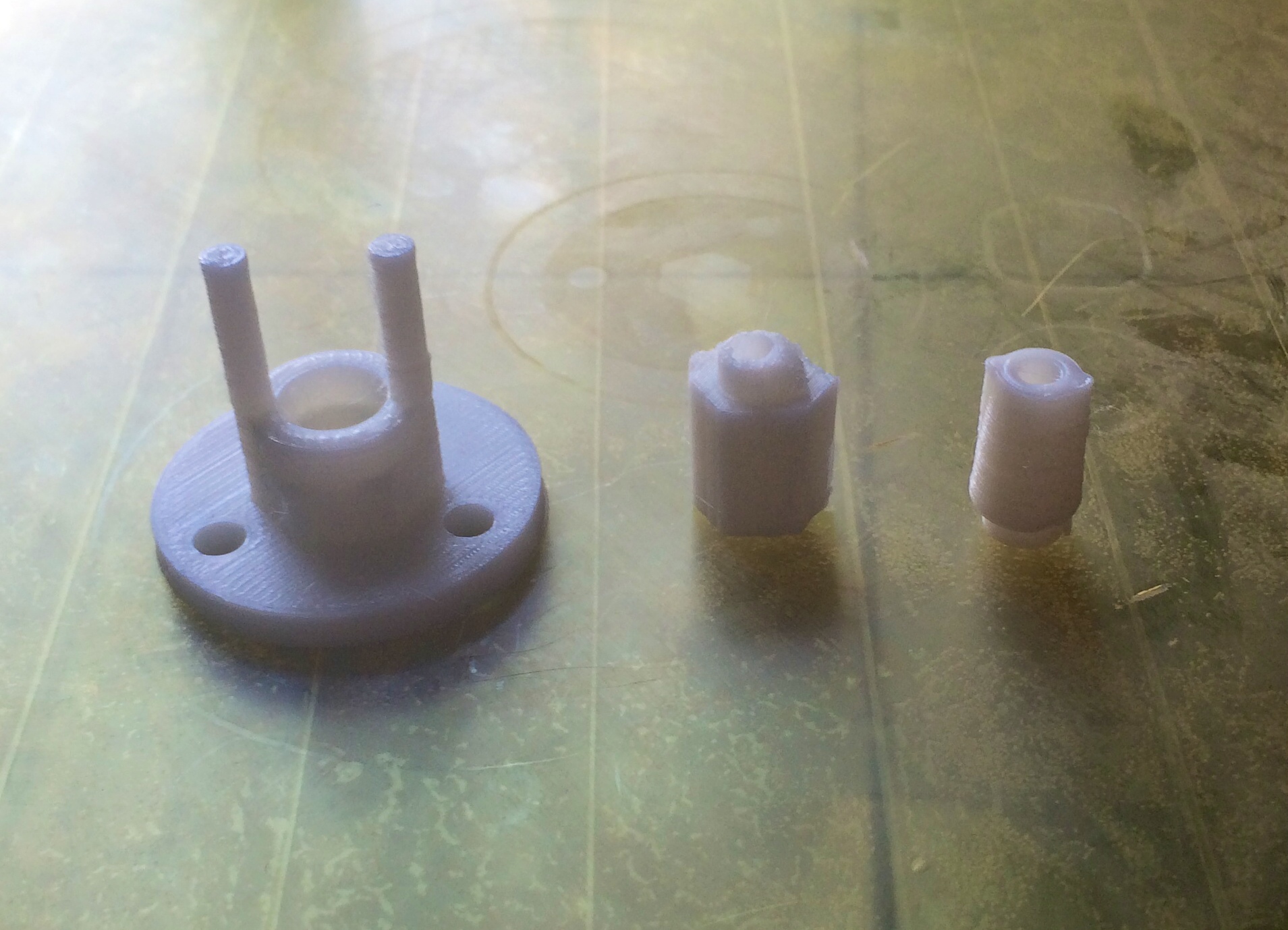

Ok, first up is the parts we need to print. There are 3 of them on the GitHub. I just confirmed with John how many we need of each:
Anti-backlash nut: 1
Bearing Bushing: 6
Eccentric Bushing: 4
John recommends printing a few extras of each of the last 2. I'm printing at 50% fill in PLA and they are coming out great. I'll post a photo when complete.
cheers,
Michael

YES, MAKE SURE you print the parts in PLA not ABS, as the resin can break down ABS parts if it gets soaked in the resin.

1 each of the parts to print.

Printed the parts. They look tiny but hey!
https://cdn.mediacru.sh/b2lnwYRpoAw1.jpg
