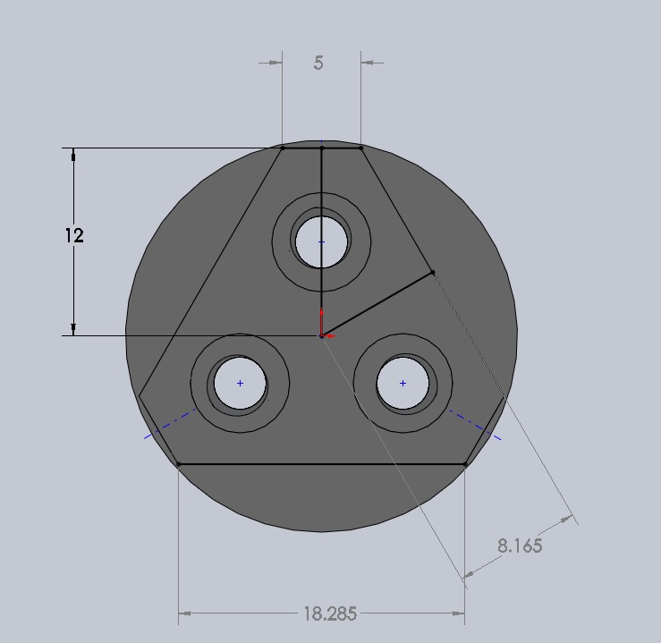

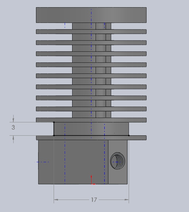

critical_limit wrote:@generic default:
is it possible to post your hotend adapter and fan mount in metric files instead of inches?
Have to change some small things for my effector.
Thanx
Dirk
I'll post the mounting dimensions so anyone can make their own effector for the Tri hotend. I'm shipping the Tri hotend with a mounting adapter for the SeeMeCNC Rostock plate, but people with different or modified printers need to know this stuff to design their own mounts.
There are two mounting parts of the hotend. The preferred one is the triangular part at the bottom, since it is ultra rigid and easy to press fit without fasteners.
The second one is a groove mount above the triangular part. Both are shown below.

Post by critical_limit »
THANX !!!!
Now I have to wait for the Hotend :-(
