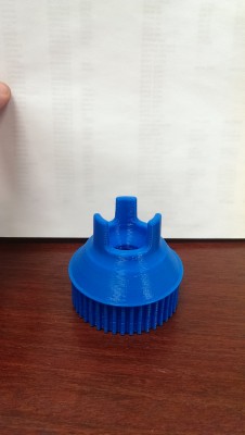

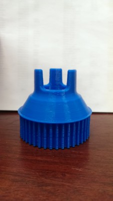

Generic Default wrote:If you want aesthetic prints with nylon, use a tiny nozzle and low layers. I noticed a big reduction in surface ripples when I switched to magnetic arms too.
Actually, I find just the opposite.
Interlayer adhesion is directly proportional to layer height/width (translation: nylon is much stronger when printed with bigger layers), and the low viscosity (relative) of nylon allows you to print higher layers while still maintaining good finish.
This part has .5mm layers...

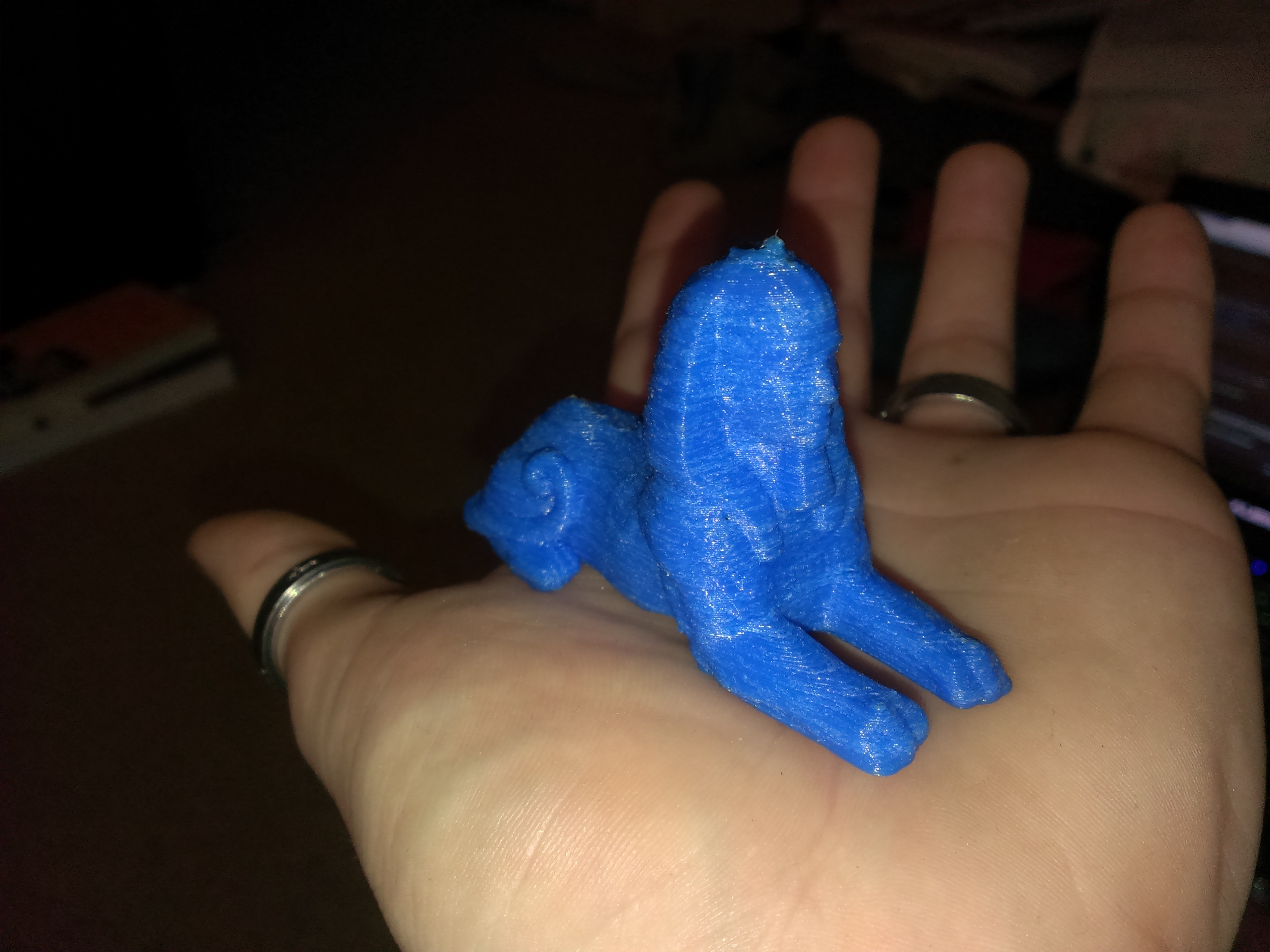

HA! I'm with you Gene, seems a bit funky to me! Just for the sake of furthering the topic though, I have managed to find 300-foot spools of Craftsman brand .065 in (1.651 mm) trimmer line at Sears for about 4 bucks and some change. At that rate, it's more expensive for a whole kilometer of the stuff, comparable to the size of a 1kg spool of our highly-prized filaments, but not by much.
http://www.sears.com/craftsman-065inch- ... 185604000P
It's twice as expensive online, but I remember walking out of the store, getting a chuckle out of the fact the the spool cost $4.20 :roll:
Here's something I printed with it, stock SeeMeCNC nozzle at about 235C if I recall.
