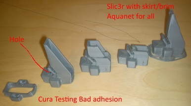

Tried printing the fan shroud. This one is a bit tougher. Problems with adhesion mainly. I tried Cura, but the speed was way to high and I don't think I have the right settings. Went back to slic3r and added a brim and then with the hairspray it worked OK. ABS is quite a bit trickier than PLA, so I have a lot to learn.
