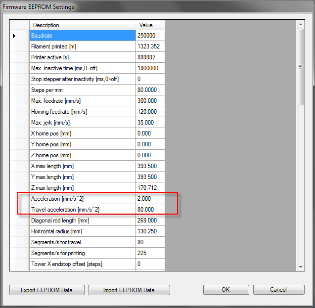

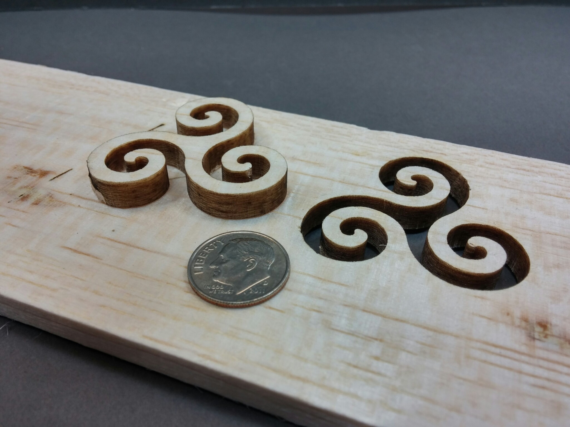

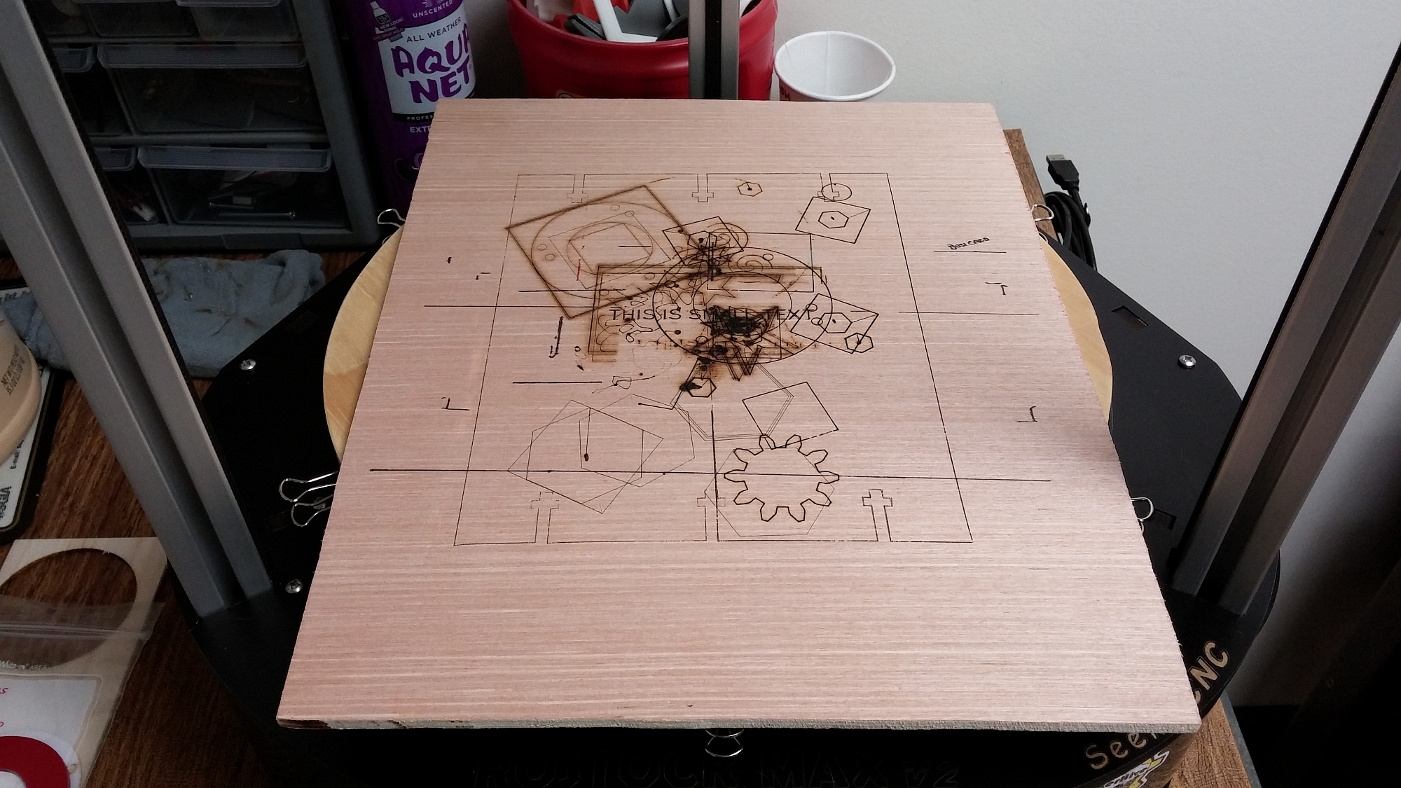

So some of you know that I have a 2w laser diode attachment mounted to my Rostock Max. The laser works fine but I'm struggling with printer speed. This printer was designed to go fast. I want it to go slow...really slow. I've been trying to slow it down to 2mm/s so I can cut acrylic but it doesn't want to go that slow. I can pass the laser through 1/8" and 3/16" thick acrylic sheet if I turn the laser on and manually feed the sheet by hand. I just can't get the printer to do that for me. It almost appears like there is a minimum feed/travel rate locked into the printer somewhere, either in the firmware or in Repetier software. Is that a possibility?
Here's what I've cut today. 1/4" balsa. 10 passes to get through it. I'm guessing it took 3-4 minutes to cut (wasn't paying attention to time).

There are constants defined in the firmware and in the slicing program to limit the minimum speed. Just search for them.
How are you getting the slicing program to only draw an outline around the object?

If you can't slow it down any further, just do a couple of passes.

If I use Repetier/Slic3r to do the slicing then I tell it to not print the top and bottom and turn my infill off. That gets just the perimeter of the shape (along with any holes or cutouts if I have those). My stl file will have the same thickness as the material I'm cutting. I might set my layer height to .05 or .1mm. Nozzle size .1mm. There are a few other settings too but that's the basic stuff. I actually do not prefer using a slicer for laser cutting. There are a few things that do not work very well. Namely, I haven't figured out how to step the Z down with each pass. Also, the laser wants to stay on all of the time, engraving a path where it travels.
My preferred method is Inkscape. I draw the shape, center it on 0,0, convert the shape to a path, flatten beziers, export the gcode. I manually change the Z0 in the code to equal my material thickness. In the case of my 1/4" thick balsa above, I set Z0 to Z6.55. This ensures that the laser has the sharpest focus dot on top of my material. With each pass, the code steps the Z down about .1mm. It should only take about 7 passes to get through 6.6mm stock but since I can't slow the printer down enough I run a few more passes. I plop that gcode into Repetier and print over USB. Very simple process. I intend to make a YouTube video of my workflow but I haven't had a chance to record it yet.
If I can't slow the printer down then my alternative is to add more passes. I don't know what else to do. So far the only thing that helps is moving the feedrate slider from 100% down to 25% in Repetier.

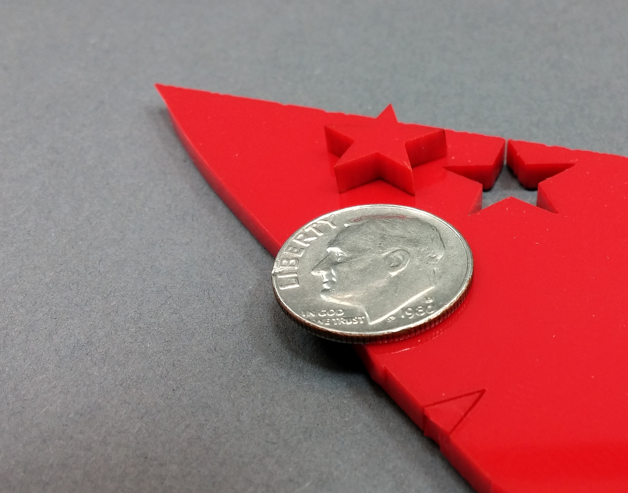

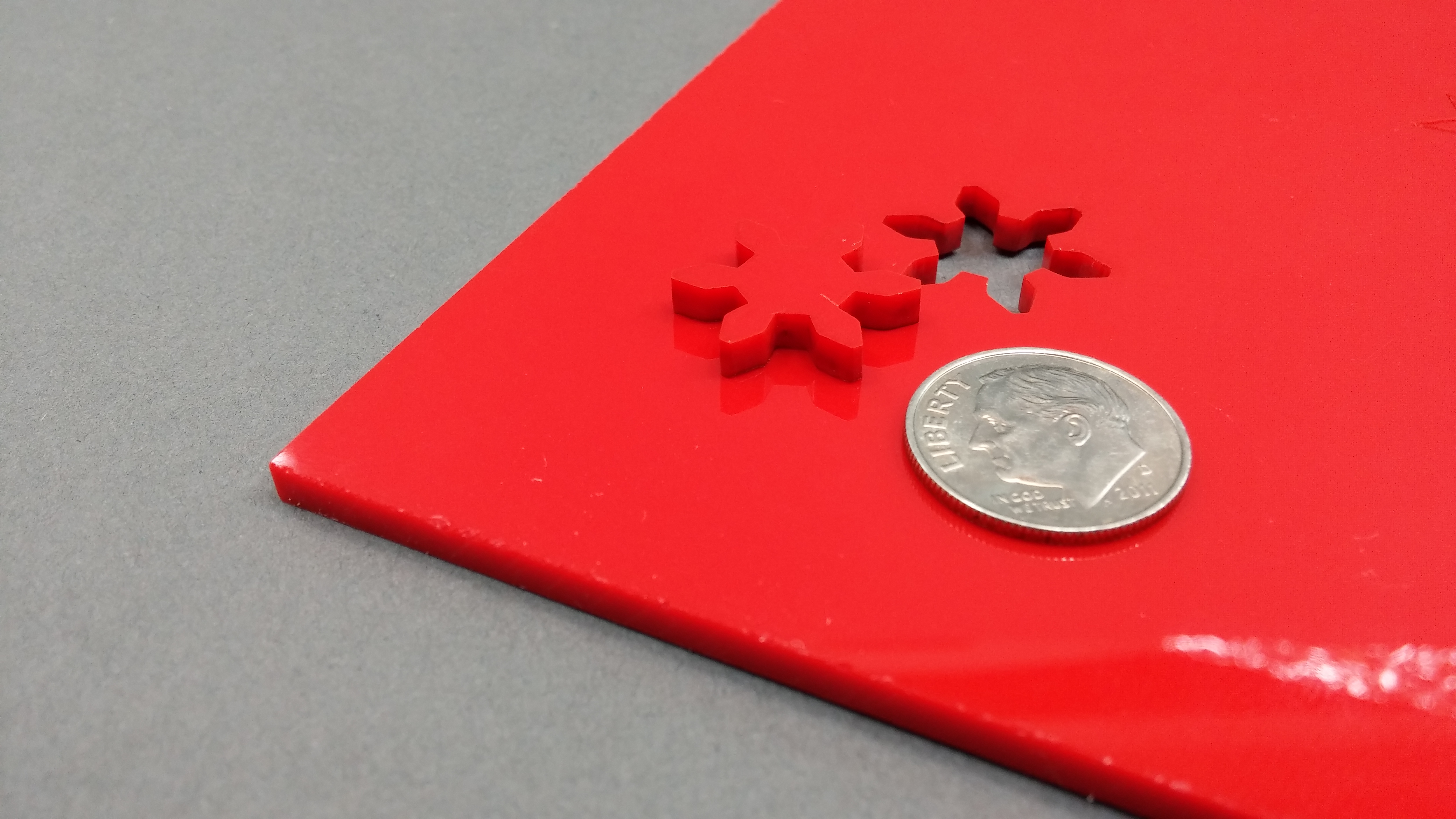

I was able to cut 3mm thick acrylic today but it took 60 passes. I can't seem to run the printer any slower than I've managed to run it. It took 19 minutes to cut this and it didn't cut cleanly. I had to use an xacto knife on the backside to cut the slivers. Also, my laser path was too thin. I thickened the cut by cutting two paths, one that was offset by a stroke thickness. That doubled the cutting time but increased but help with the rebonding issue.

Post by Polygonhell »
There's nothing mechanical limiting the minimum speed, the firmware has to pick something to avoid accumulating too much error.
This is the code that sets it
minimumSpeed = accel*sqrt(2.0f/(axisStepsPerMM[X_AXIS]*accel));
So you can reduce the minimum speed by reducing the acceleration in the firmware but it only changes with the sqrt of the acceleration.

The code uses a cached value, so I wouldn't bet M201 will work, it might.
It's easy enough to change the value in the EEPROM settings, you might have to reset the board after the change. You can probably set it very low, since you'll always be running slower than the Jerk setting when cutting, 0 might even work, but I wouldn't bet on it.

Polygonhell, you're a genius! :)
I just tried changing the Acceleration and Travel Acceleration values in the eeprom and I have a buttery smooth slow speed. Problem solved! Thanks a bunch.
Update: I jut cut the star shape out of 3mm acrylic again with these new acceleration settings. Running the bot this slow makes it nearly inaudible. One can barely hear the stepper motors. Anyway, I was able to drop the passes down to 10 from 60 and it cut cleanly through. This works much much better.

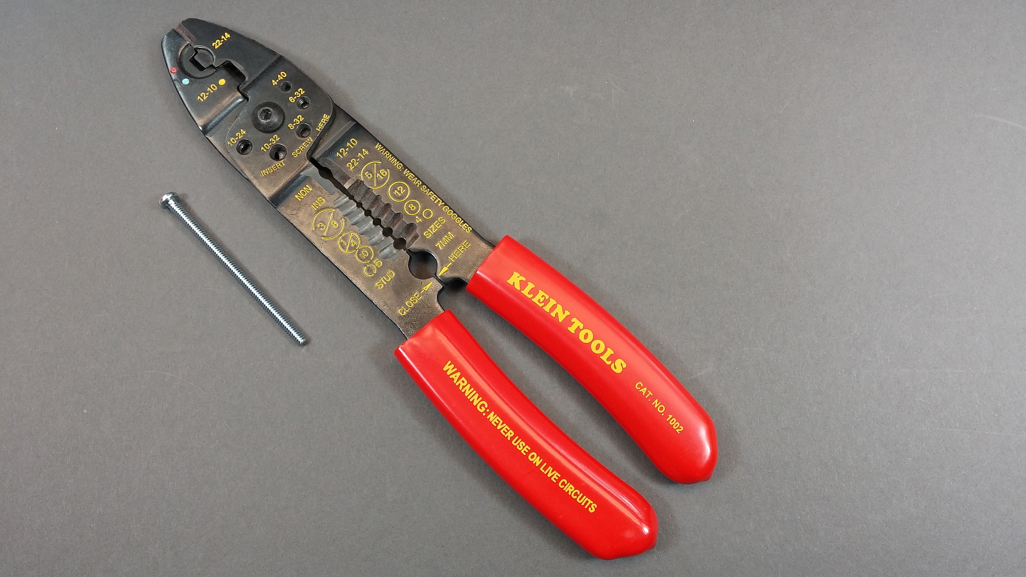

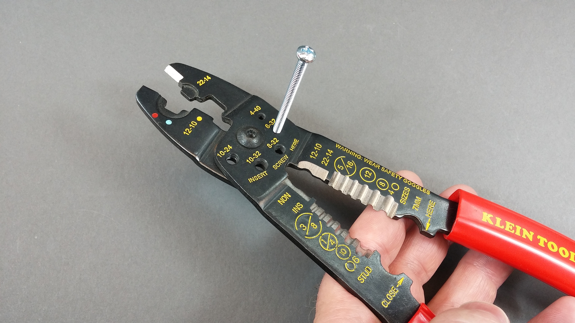

I ordered the 6" screws from McMaster and then cut them down to size with my wire strippers/crimpers. (http://www.mcmaster.com/#machine-screws/=tdo4z6) Pan head zinc coated should suffice and they are easy to cut. I think you get 5 of them. You'll need 4 with my mount. The rest of my fasteners I get next door at Fastenal. They're like 75 yards away from my office. Any hardware should have these though.

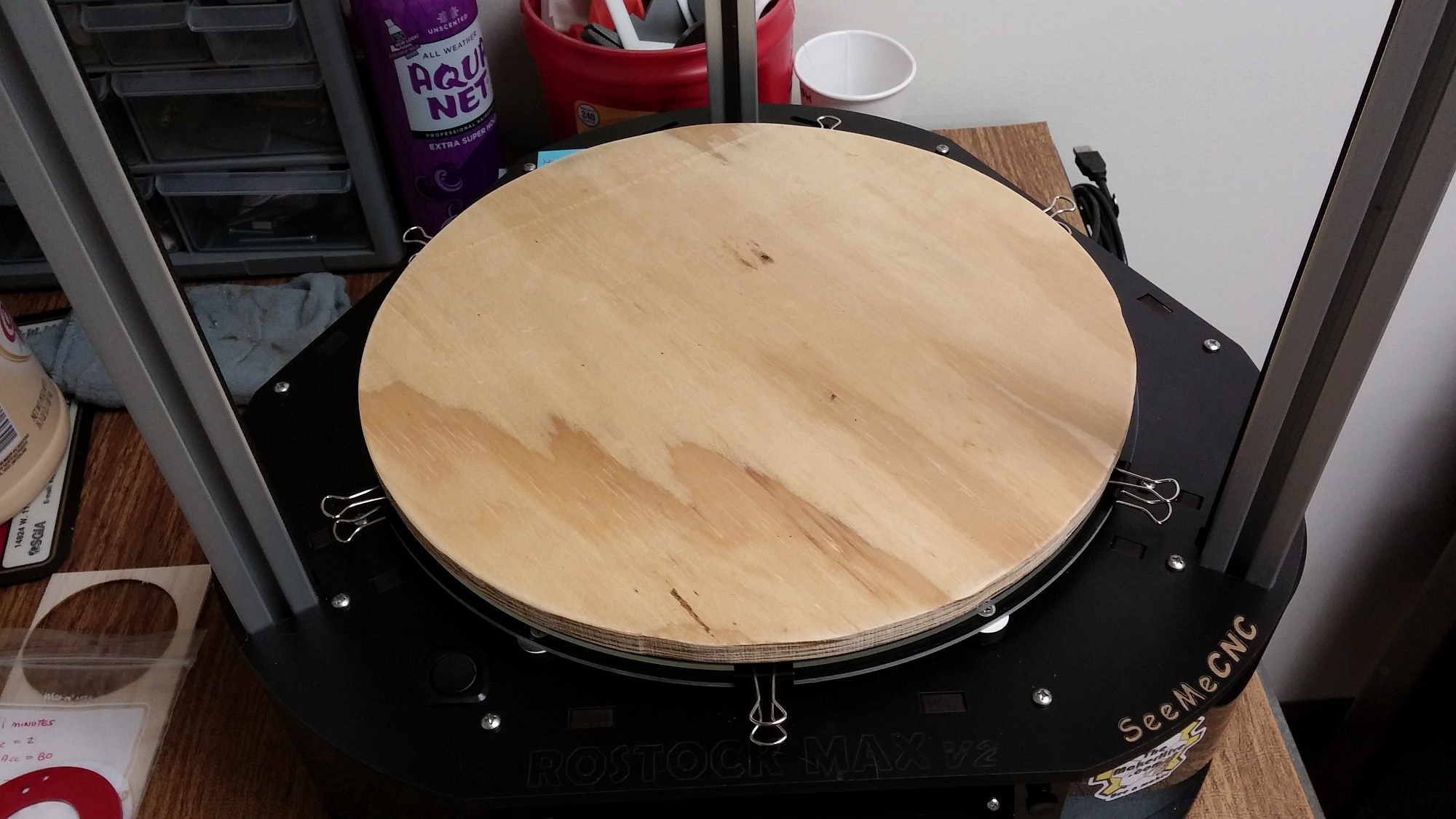

Any number of things will work. I had cut a piece of cardboard and 1/2" thick wood long ago to protect my glass bed when I was working on my hotend. I also leave it on there from time-to-time to keep the dust off of it when not in use. On top of that I slide a piece of 1/4" luan (cheap) as my safety surface. The laser burns into it but doesn't cut...very deep (if you leave your laser on it will eventually get through it). The main thing you want is the surface to be flat. If the wood or other material is warped then you will get uneven cuts. Stay away from the warped stuff. The wood and cardboard is freely available at my workplace and that's why I used it. One day, I'd like to get a 11" round aluminum plate made or something equivalent.
