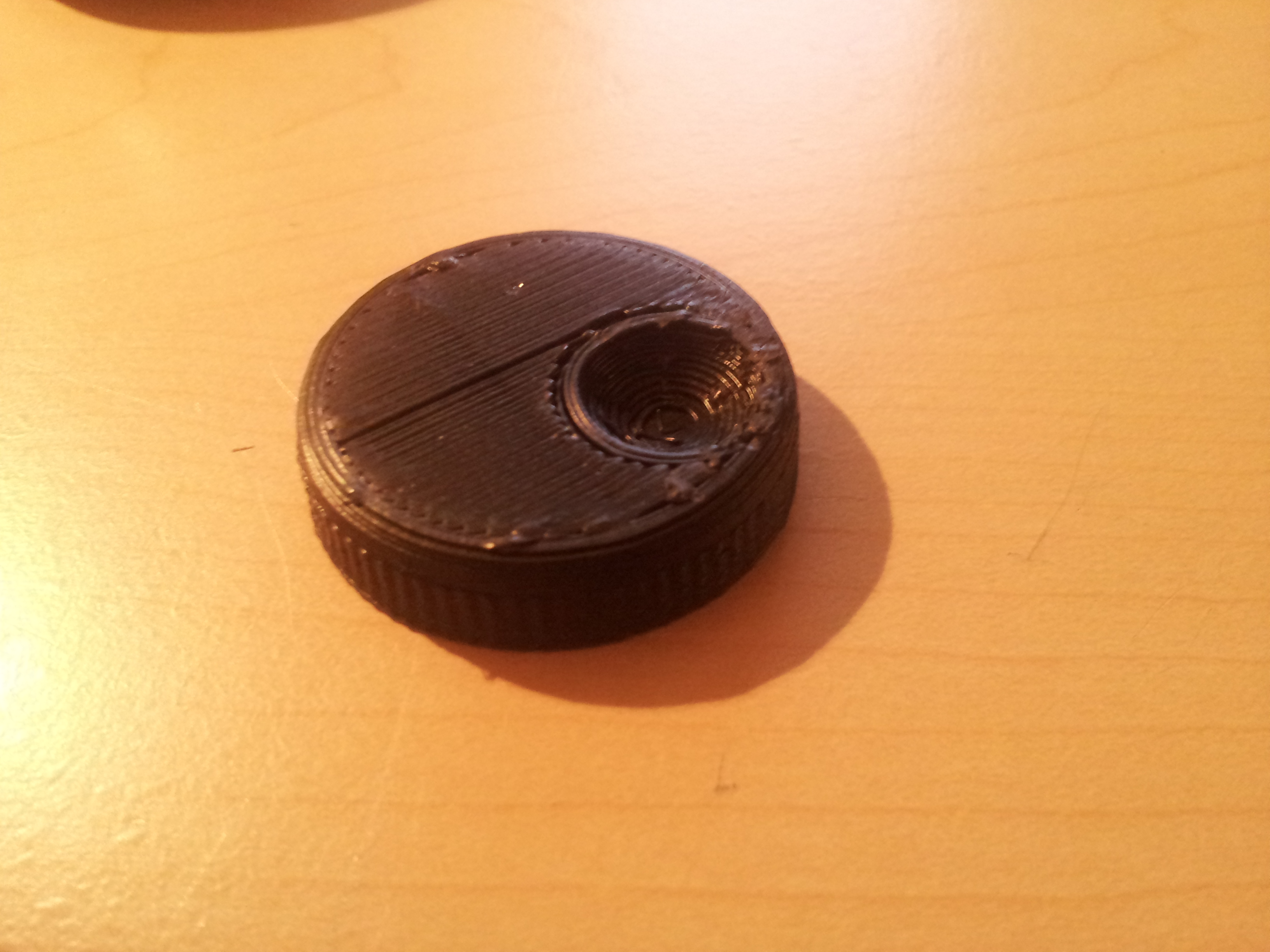

ps. these are pics of my first completed print (as in the first to not back up in the middle of the print)
