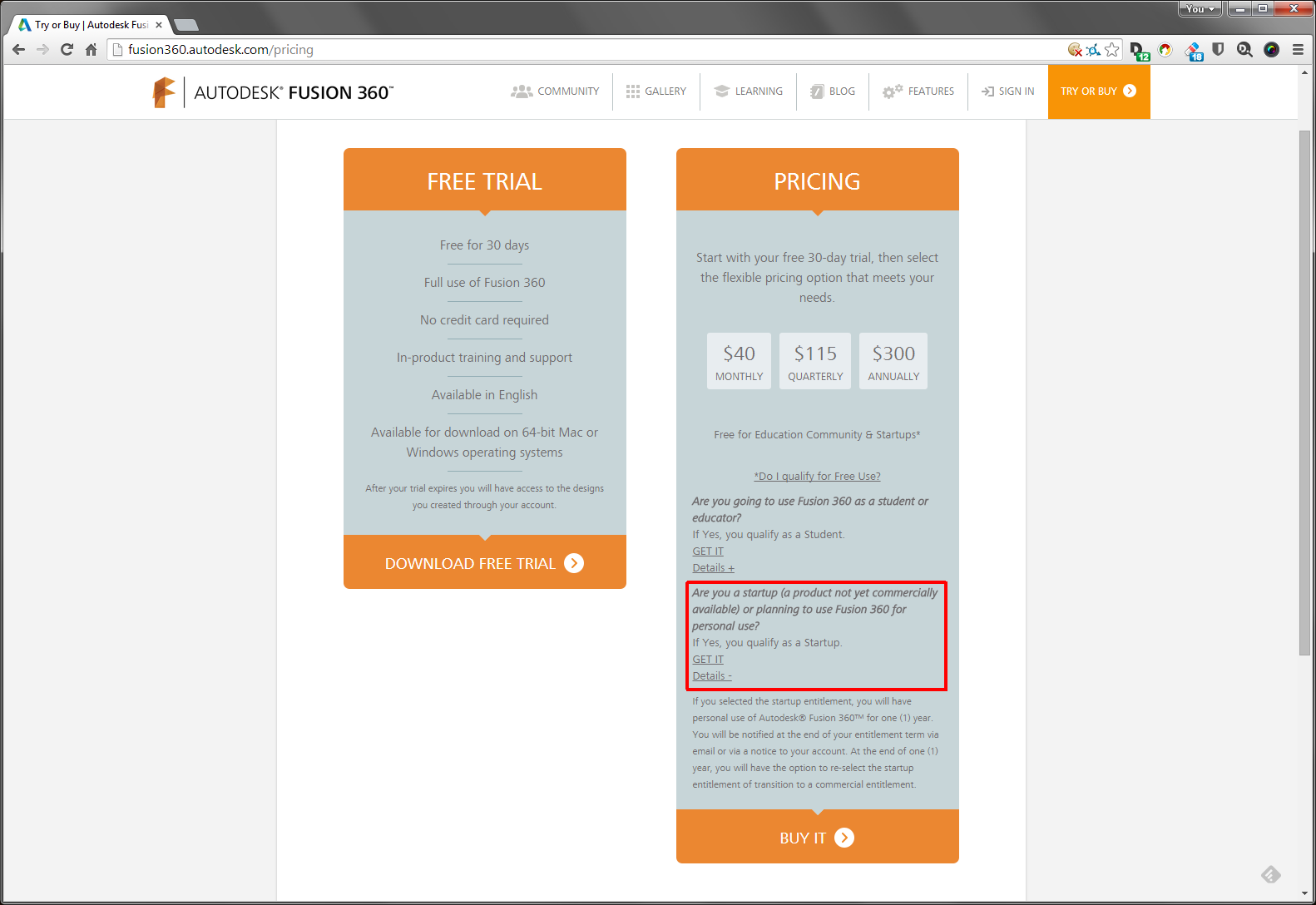

heathenx wrote:The free Autodesk Fusion 360 used to convert stls to solids wonderfully but something changed a few releases ago.
I think I know what happened to it... it is no longer free ;) and I have yet to find a good way to convert these STLs... mmm... thinking...
heathenx
Posts: 305
Location: Northern Indiana
Re: Solid model of effector
Post by heathenx »
Autodesk Fusion 360 is still free for personal use.
