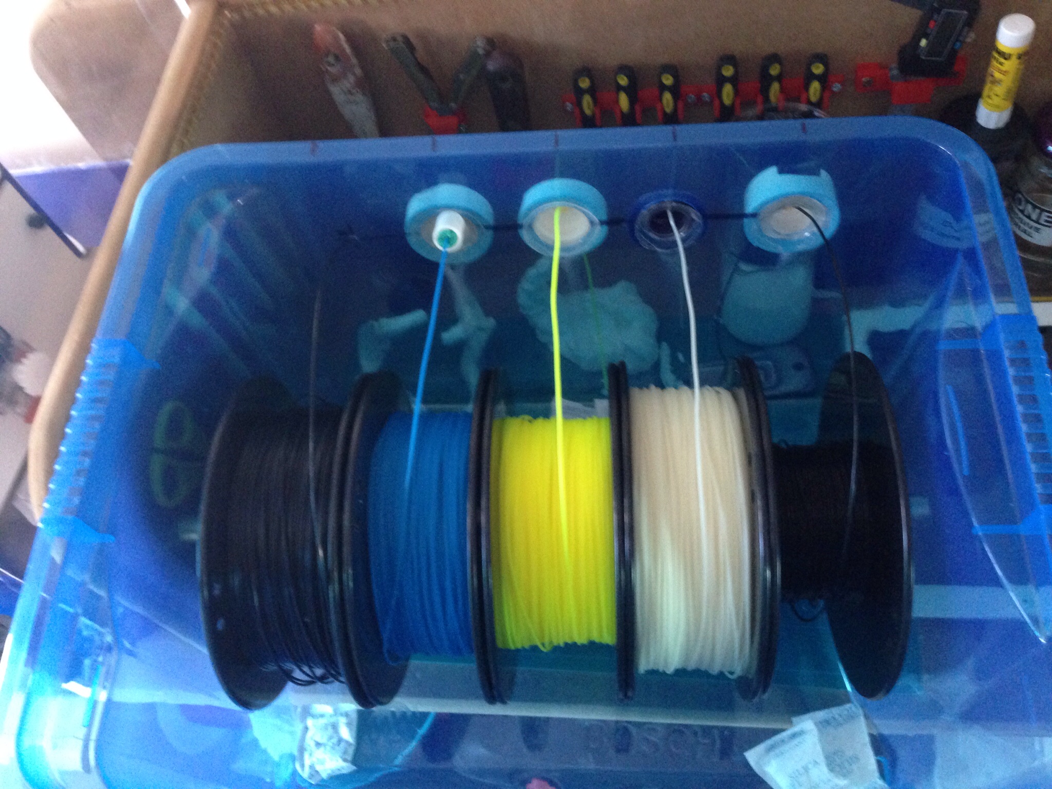

Funny you should mention that!

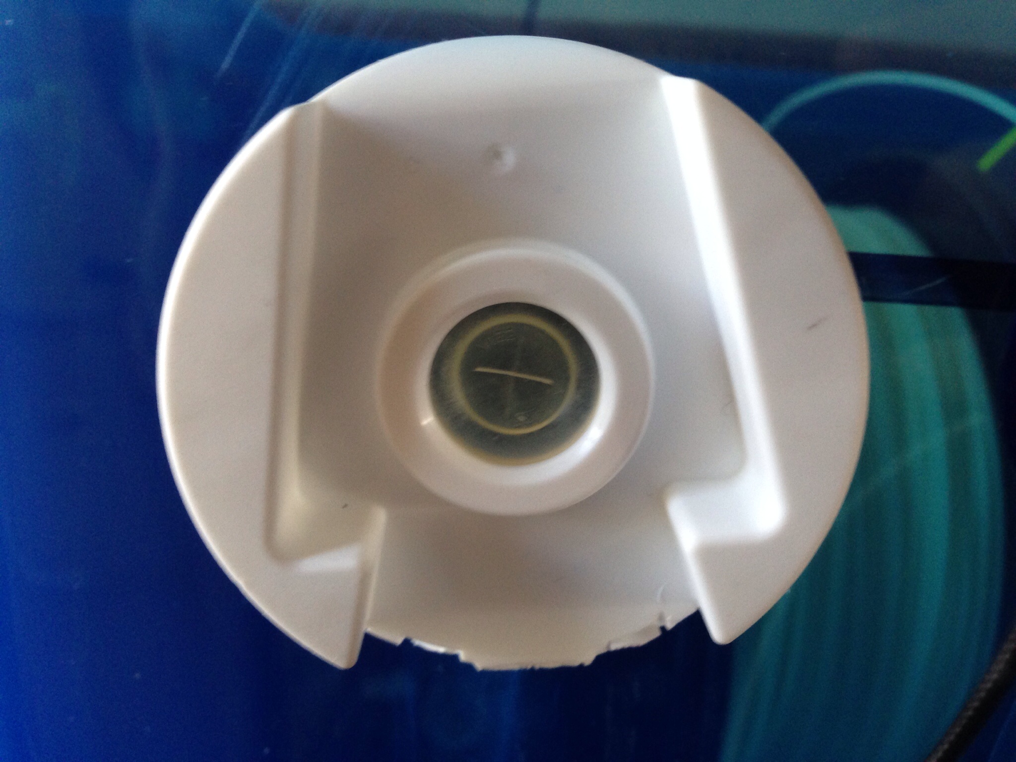

I've just finished making a airtight box for some of my spools that also has airtight valves that let filament spool without it ever leaving the box.
Take a look:
The valves if you haven't already guessed are off bottles of condiments. They have a pretty neat pig valve that lets 1.7 filament through.
I've had trouble printing some nylon and that was partly due to the moisture in it. I was reading that curing it in the oven for 10 hours works but frankly I don't want to have an oven on for that long due to gas prices and fire hazard. So I went and got a fruit dehydrator (used to dry fruits) and from the feel of the filament it looks like it's worked quite well.
Link to the dryer:
http://www.amazon.co.uk/Electric-Dehydr ... dehydrator

Looks like you have a small bag of desiccant in there but seems small for your container volume especially considering it's not 100% sealed.
I'd recommend filling the base with a few inches of no dust (low friability) indicating silica gel like this
http://www.amazon.com/Quart-Indicating- ... B00BXK8E7M
It's easy to regenerate in the oven, you can see when it's water saturated so when to regenerate and cheap to boot.
% Loss on drying is pretty simple and is done to constant weight. Never heard of LOD being performed at such low Deg C so presume it's over many many days
to attain constant weight.
Nor sure how effective drying on the reel will be as you've got lots of unexposed surface. Personally I'd just long term store the stuff somewhere warm in a desiccator.

you can't really see from the photo but there's loads of Desiccant packets in the bottom (almost covering the bottom now) but I'll defiantly have a look for some of that blue stuff in the UK.

Sorry to burst the bubble, but you simply cannot dry nylon, at 1atm, without heat.
All Nylon (and especially Nylon 6) bonds very strongly to water, and a low rh% is simply not enough to dry it.
All nylon processors dry nylon beads at 180-200F for up to 12 hours before use.
Once it's dried, you can keep it dry in a container with desiccant, but without heat, it's just not possible.
Also, for whoever said Nylon sucks... it only sucks if it's wet and/or your settings aren't correct. When printed properly, it's easily the most awesomely useful filament currently available. Flexible when thin, incredibly durable, insane interlayer adhesion, resistance to virtually all solvents, very high working temp, and it prints super smooth and with a glossy finish.
It's really fantastic.
