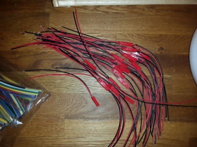

I found these they have nice and flexible wire attached to them.
http://www.banggood.com/Wholesale-10-Pa ... 50810.html
So if you are thinking of ordering the printer I would recommend getting these. Oh and download the manual and read it completely right now.

I ordered mine just about a month ago, they arrived today.teoman wrote:I found these they have nice and flexible wire attached to them.
US $2.49 for 10 seemed so cheap as to be hardly worth while, so I doubled up.
NO IDEA what I will do with the whole $4.98 worth, so if anyone wants one or two send me an e-mail.
That way you won't have to wait a month.
BTW, they are pretty much as advertised, about 5 inches of wire on each, stripped back an 1/8 inch or so and tinned.

I ordered 3 packs.
Used quite a few already.

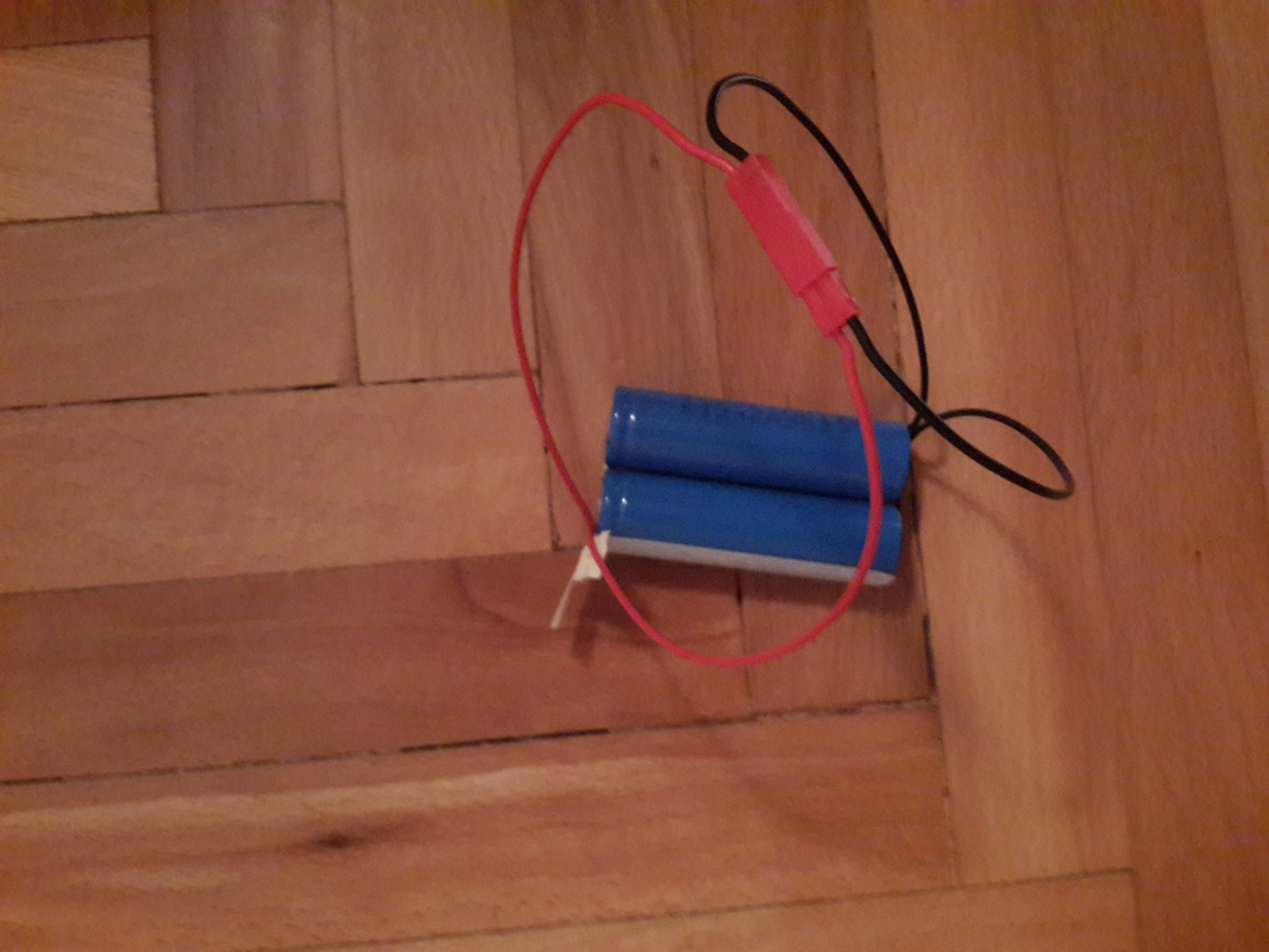

I used 4 sets on my automatic cat feeder. I found a discarded toshiba laptop battery. Separeated the cells (it was a 2p3s config) in to 3 seets of 2p cells. Put a male and female on each. Put a male connector in the machine. Stuffed the batteries inside and no more replacing dcells.
As advertised, they can have bad quality control. So check that the black and red locations match. (Although all of mine matched)

I must admit that initially i thought that the wires were silicone coated wires. Those are very very flexible. But these ones are standard wires. They are also fit for purpose.
