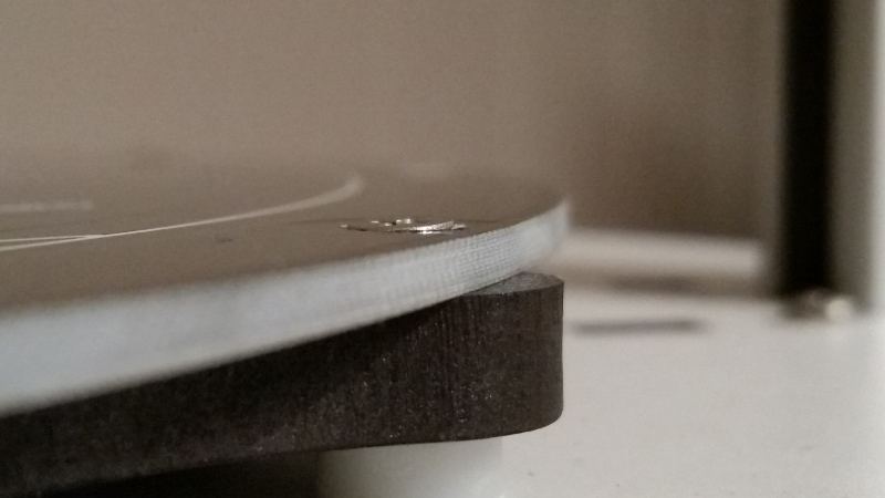

The thing is that i've done these steps according to the manual, but i'm still ramming the bed at G0 Z0 X-77.94 Y-45 F3500. I've now turned the screw in 4 turns to the right and it doesn't help turning it more as that cheapskate body is now hitting the end stop switch instead of the actual screw. I'm still lacking approx 0.2-0,3 mm before i get clearance to the bed on that coordinate.
I think i've narrowed it down to the onyx bed screws to being the error. My Onyx bed was shipped without taper in the holes. I had to taper the holes my self by hand, but i see now that at least one of the screws close to the x tower is pointing out. Not much, but i can still feel an edge on the screw head even when putting a sheet of paper close to it. I think this is causing the glass plate to be somewhat higher on this side.
ThomasF
Posts: 9
Joined: Mon Jun 16, 2014 1:02 pm
Re: Bed leveling issues
Post by ThomasF »
Here's a pic of the bad taper job i did... corrected it now and trying again..

So that didn't help.. i'm completely lost now.. the g0 z0 x-77.94 y-45 f3500 is still ramming the bed and i'mm all the way in on the screw on x tower cheapskate any idea what i could be doing wrong?
