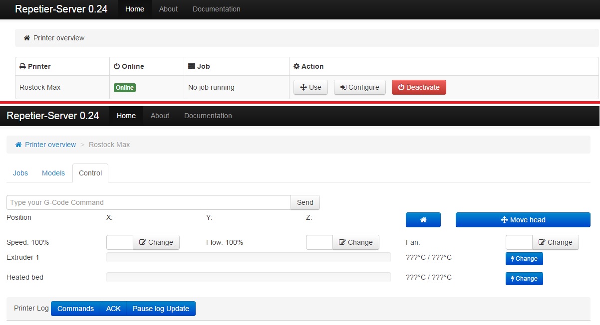

So I got my Raspberry Pi setup to run run my printer and am having issues with getting it to actually control the printer. The homepage shows that it is connected, but when I go to the control tab and type in any gcode commands or use any buttons nothing happens on the printer.
Here is what I have in the config for the printer.
So far I have tried the following with no luck...
- setting usb device to both listed and both pulled up the server
- protocol set to '0' and '2' (I'm running Repetier 0.91 firmware)
- Baudrate at 115200 and 250000 (250k outright didn't work)
- readCacheSize at 63 and 127.
Any input would be helpful.

I have attached my config. Note that I have a direct serial connection ("/dev/ttyAMA0") instead of using USB. 250000 bps does not work with Repetier-Server and Linux. In the docs it mentions that it works in Windows only IIRC, but I found it's not necessary as the RAMBo can't really handle moves at even 115200, so it's not a limiting factor.
I compiled from the 0.24 github source, running on the latest Raspbian. Did you compile it or download the Pi binary?
Here is my compiled binary:
https://drive.google.com/file/d/0B2fvkp ... sp=sharing
Try pressing the e-stop button (on the front panel under the rotary knob) to reset the RAMBo once Repetier-Server is loaded.

Thanks. I followed the install.txt from git-hub. Install was on a freshly flashed SD card with Wheezy (2014-09-09) and all files pulled/compiled through the terminal window.
Also, not sure where it loads them to, but it just let me load a gcode file through the server. Still no function though and I have rebooted the pi and the printer several times.

By default it puts gcode files under /var/lib/Repetier-Server/storage/xxx/jobs. Are you using "/dev/ttyACM0"? I believe that is the correct path for the USB connection.0110-m-p wrote:Thanks. I followed the install.txt from git-hub. Install was on a freshly flashed SD card with Wheezy (2014-09-09) and all files pulled/compiled through the terminal window.
Also, not sure where it loads them to, but it just let me load a gcode file through the server. Still no function though.
If the connection is up you will see the temperatures change in the control panel. Make sure you change the bps rate on the LCD screen under Configuration->General->Baudrate and then Configuration->Store to EEPROM.

I changed the bps rate on the LCD from 250000 to 115200 and went back to the old device="/dev/serial/by-id/usb-UltiMachine__ultimachine.com__RAMBo_6403636363835131D010-if00" location and it works now.
Not sure why it didn't before (LCD bps rate couldn't have caused this could it?).
So it reads temperature right, sets temperature right, and I can move everything using the GUI buttons. For some reason though, no gcode commands work. Any ideas?
Thanks for all the help.

The bps rate on the LCD/RAMBo must match. Even though it's USB it's really just RS232 over USB.
Are you uploading the gcode under jobs and not models? Do you click the start button on the job after uploading? The tick box to auto start after upload doesn't work for me.

Sorry, I wasn't very clear....I haven't tried to run a job with it yet. It is manual gcode commands that don't work. So type G28 and click send and nothing happens...click the home button and it homes the machine.
Also, if LCD and Rambo have to match how have I been able to print from SD and Repetier-Host for the past year?

Well I figured out the commands thing....they need to be capitalized.
Re: Octoprint and Repetier-Server for Raspberry Pi?
The LCD is controlled by the RAMBo. You probably have Repetier-Host set to 250000, this is what needs to match what is shown on the LCD. Now that your LCD shows 115200 if you plug back in to your computer you'll need to change the rate in R-H.0110-m-p wrote: Also, if LCD and Rambo have to match how have I been able to print from SD and Repetier-Host for the past year?
Yes the firmware needs everything to be in upper case. In this case Repetier-Server does not fix the capitalization for you.

Cool, so it was definitely the baud rate that was my problem then. I just changed the rate in R-H to 115200 as well so they both work now without modification. Is there any benefit to switching the rate in the LCD back and forth between 115200 and 250000 whenever I switch between R-H and R-S?
Thanks again for all the help troubleshooting this.
