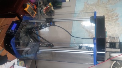

Attached here is the lower enclosure bracket I created. It's quite long so you'll need good control of your build area. I printed the enclosure brackets two at a time. The lower brackets are an interference fit with the melamine and also require the bottom covers to be notched.

Attached here is the upper enclosure bracket. These require small wedges to be printed in order to hold them in place. They will be included in my next post. I will update this thread to include a picture of what the finished enclosure looks like.

Here's a picture of everything assembled. I still need to come up with something to seal the rest of the plexi to the bottom sheet of melamine. I also need to cut the last piece of plexiglass so I can get some temperature readings with everything assembled.
Everything assembled
