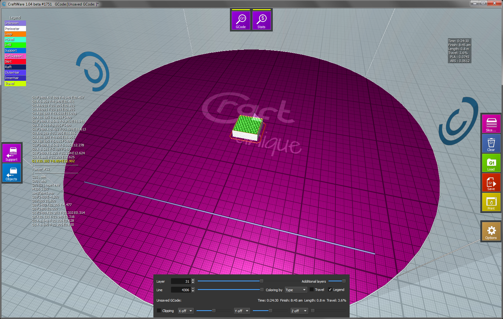

+1 for the easier than matterslice comment. You set the settings for your printer dimensions similar to RepetierHost, and then it's just a simple matter of tweaking the model with rotation, scale, and positioning controls, checking your nozzle settings, slicing your model and sending it to the printer, I do so by putting exported gcode on SD, but I'm sure importing the code into a host like RepetierHost wouldn't be an issue.
It has a "workflow" oriented workspace is the best way I can explain it.
First screen you select files and arrange them, then you can either choose to move to the custom support tab and let it auto-generate supports for you, or you can place them where you want. Once that's done, you click slice and it pulls up the, in my opinion, well-labeled slicing settings, that also makes it very convenient to make different profiles for different filaments.
After the slicing has finished, it allows you to inspect your gcode with a user-friendly, yet highly informational slicing interface which can even take you to a specific point within a layer in the gcode.
Highly comprehensive program and much work seems to have been done to make this a high-quality, free product.

I print with it routinely, and I love the results. It even allows you control over the gap between a start and end of a perimeter to help eliminate blobbing in the exterior finish.

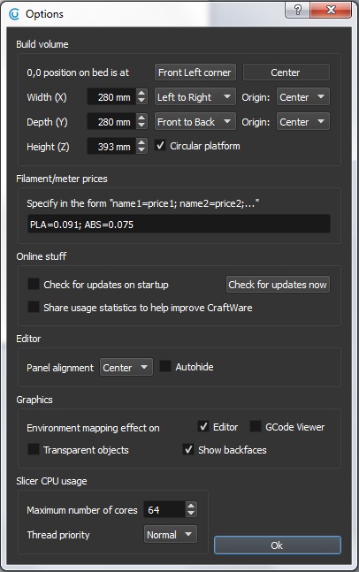

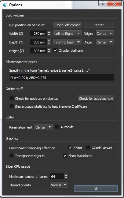

Bottom, right hand side, there is an "options" button. That is where you set up the printer shape and size.

Here's the options and slicing settings I'm currently using for 1.75mm PLA. Make sure to input the closest whole number to YOUR machine's Z height. There is an option in the slicing settings to offset the Z-height at a more precise level, so don't fret ;)
Options menu configuration
PLA1.75settings.txt
If necessary, change the txt extension to ".cwsp" then import these in the slicing menu
(3.15 KiB) Downloaded 478 times
