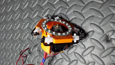

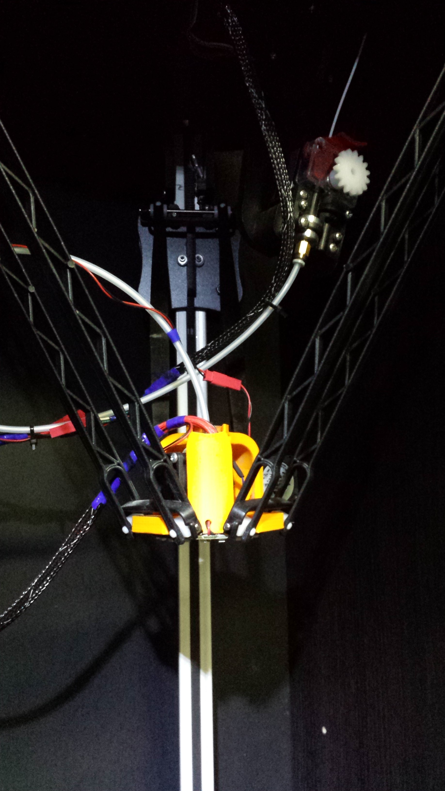

Alright, I'm back!
I have my latest model of the platform installed, but it just missing a few things. I print mine out of PLA and they work great if you only print PLA with it. I tried printing ABS for one job and warped the paltform with the high temps in the enclosure. Not good. Have a find print me a ABS version soon.
I installed the stepper dampers which makes a difference, but it's not as huge that I though it would be. The GF can sleep with it running overnight, so that enough for me. I took decibel reads and they were the same near the machine and in the room next to it. The coarseness of the sound is reduced, so thats nice.
The Trick Laser arms are installed and they look so much better then the old fat ones. Used the hardware that came with it for the cheapskates, used M3 machine screws for mounting to the platform. Putting the locking nuts on the M3 rods that come with the arms are a pain to put on.
Still have to install the LED ring and the Yellow Jacket Board.
Here's a dark shady video of it printing.
[youtube]http://www.youtube.com/watch?v=-J0uVDbkh30[/youtube]

Any chance to get the Files?predawnsky wrote:got my e3d and did the mods
Re: Monolithic Platform for E3Dv6 Hot End
There are some old files in the previous posts. I'll upload my more current models soon. I've been delayed in doing this with other life activities.critical_limit wrote:Any chance to get the Files?predawnsky wrote:got my e3d and did the mods

Here is the latest Solidworks file, have fun with it. Also, there is a loT of junk features that I just keep adding, so be careful. It needs some cleaning up.
Layer fan has not been design yet and I think a fan mounted on the outside will hit the arms in some cases.
And, remember this a work in progress and you will probably need to play with it. HAPPY HOLIDAYS!
You'll also need the groove mount holder.
http://www.themakerhive.com/FTP/jassper/gmc.stl

Hey Crocky,
Are you using the model I uploaded or generating your own? Can't wait to see it.
Do you have any pics of it with the Yellow Jacket installed yet? I'm looking at mine and it appears I'll have to move the fan mounts and thermistor plug to the top of the board so it will lay flush.
No, nothing yet. I've been printing, but the printer project have been put on hold. Got to find some time to tinker.
