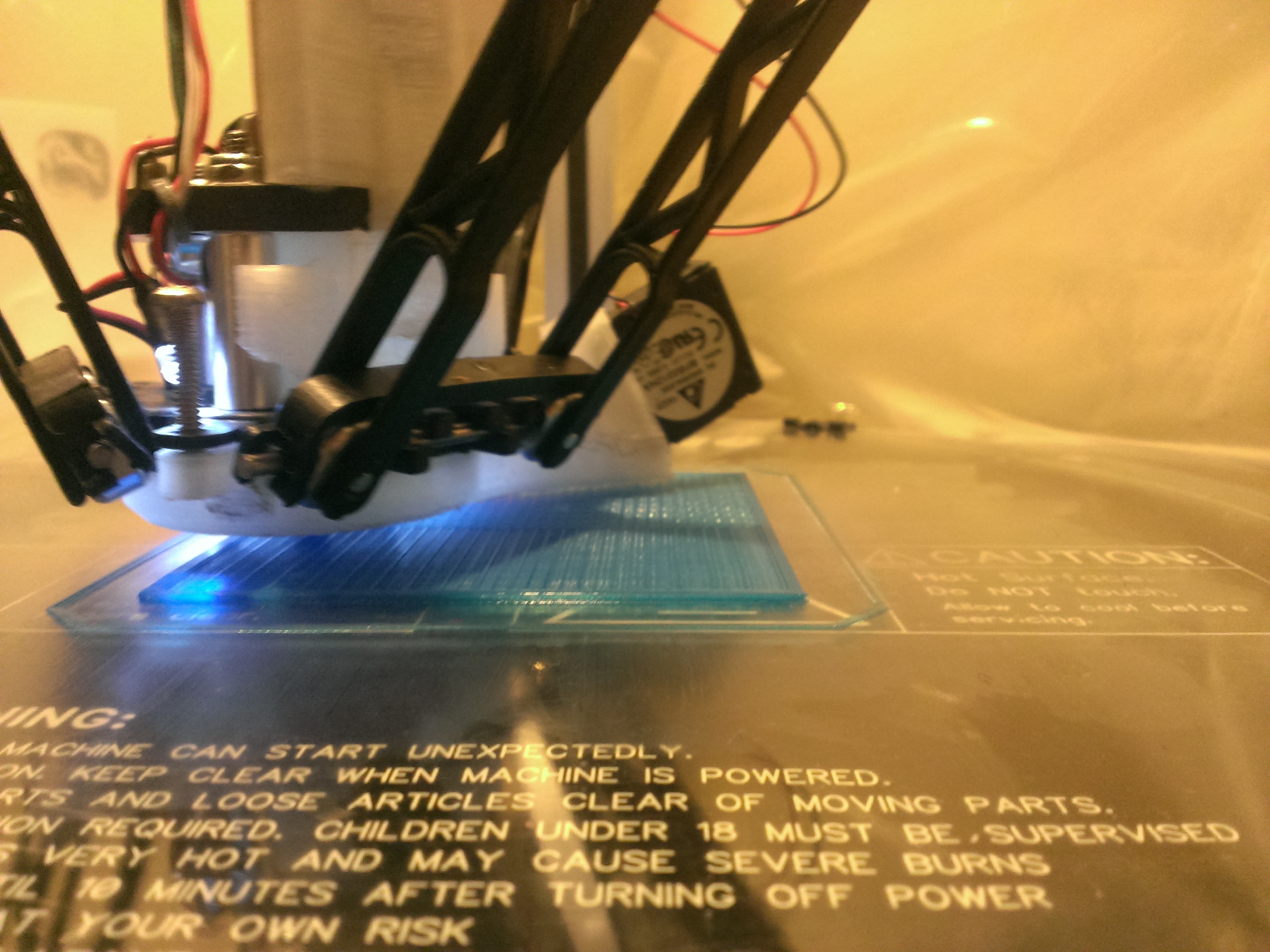

I'm building an enclosure for my printer, just 3 more prints for the top brackets then need to print up 3 or 4 parts for the latch setup. I'm running out of white ABS so the rest of the parts might have to be black.
[img]http://i.imgur.com/49ADE0K.jpg[/img]
Re: V2 in Minnesota - plenty of questions.
Just printed the last one of the enclosure brackets, I had about a foot of white filament left at the end of that! Then I noticed that my PEEK fan wasn't running, somehow it jammed up or something, the fan shroud is completely melted but the hot end seems fine surprisingly!
