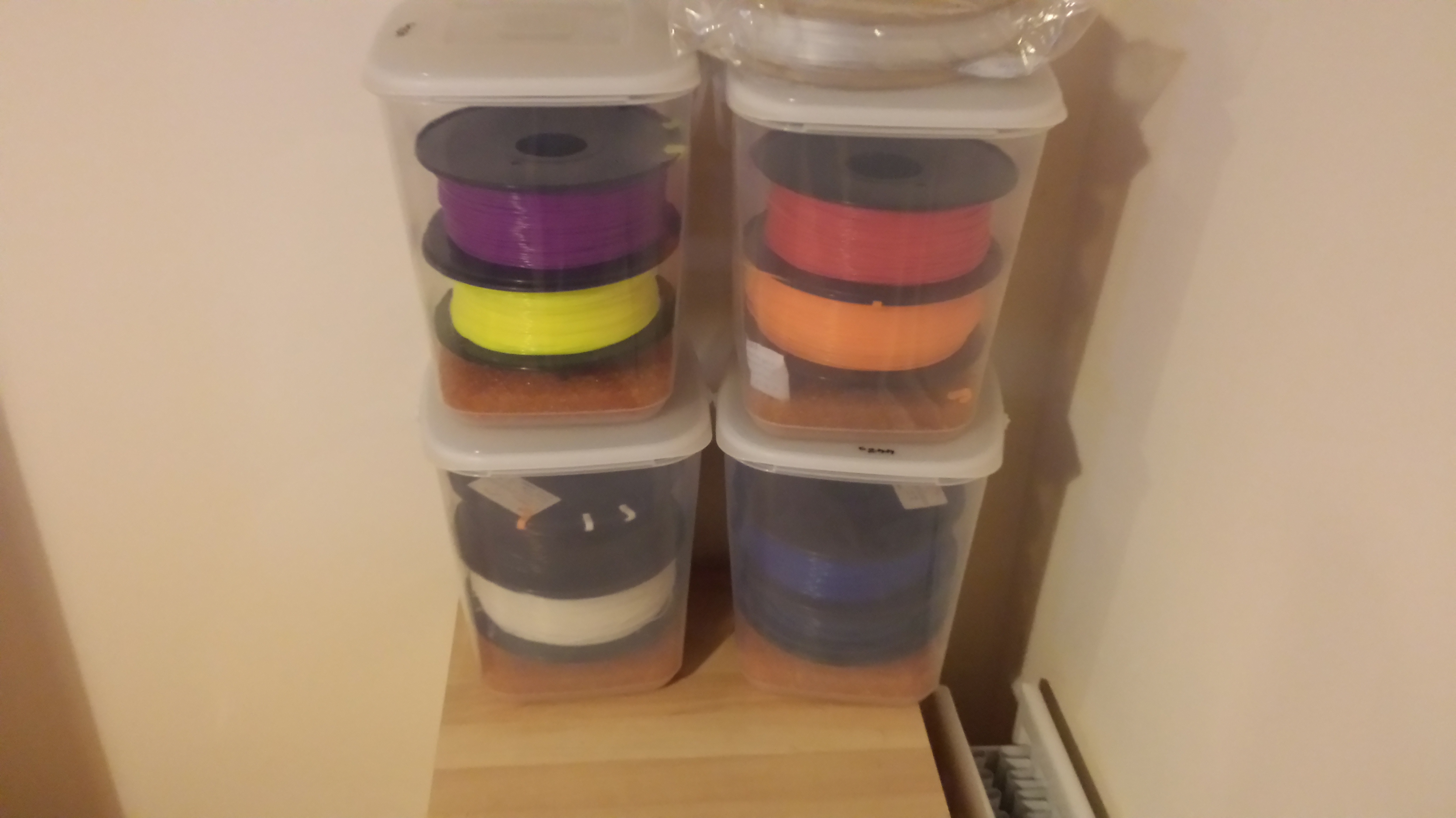

Your ABS should come in a vacuum sealed bag with some desiccant so it should be fine unless the bags holed. Most people store their filament in ziplock bags with some desiccant or use Tupperware. In my experience you don't need to oven dry ABS or PLA simply store in a warm place in a sealed container with some desiccant is good enough.. Nylons and some other filaments benefit heat drying.
I use some cereal tubs with some desiccant in the base e.g.
