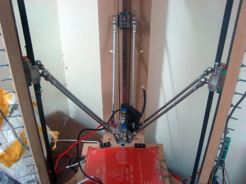

I wished to had a machine from SeeMeCNC but simply at the part of world i am living can not afford too many taxes. I am having my home made CNC and following pictures shows my progress so far.. I named it DELTA-1. I dont know whether this thread to be continued or not as this doesnt pertains to SeeMeCNC...

Looks like you have a pretty good design worked out!

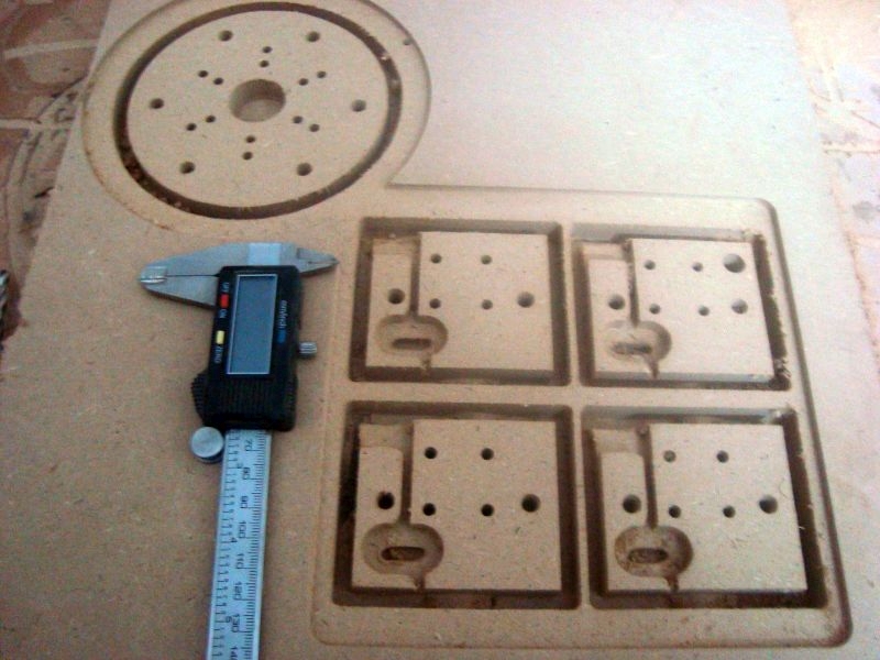

Thanks guys for giving me space in this superb forum. I am going to install magnetic effector arms. Designed the effector plate and CNC machined 2mm Aluminum. I also drilled /tapped M3 holes in the hot end fin part ( don't know the name of it)...

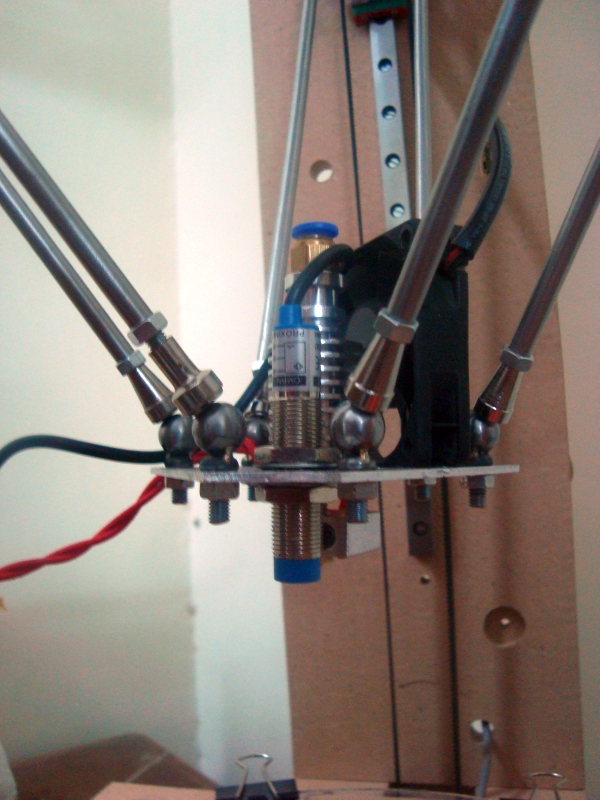

Here is the effector plate with probe and hotend mounted
Also machined some acrylic parts to be mounted on linear rail block

Which probe is that?
Is it contact type?
Is it precise enough?
Is it contact type?
Khalid Khattak
- Posts: 276
Re: My DELTA-1
Teoman, This is inductive proximity probe NO NPN type. I am using the same in my CNC machine for homing and limit... I am using 12VDC to work with. I made a opto-isolater PCB which will work with RAMPS1.4 logic level voltage... These probes have higher accuracy as compared to mechanical type limit switches

Re: My DELTA-1
Wow, looks like you're almost done already!

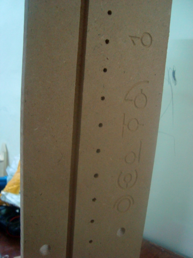

This thing is looking good so far. I'm wondering how you're keeping track of tolerances and dimensions on this stuff though, especially since the plastic and wood parts are subject to thermal expansion and moisture warping.
In particular, how did you align the linear rails on the vertical axis? How straight are they, how much backlash, friction, mass, ect.

Hi Generic Default..look at my CNC router 5ft x5ft..its amalgamate of wood, steel and aluminum.... i have experienced machining of wood, plastic and Aluminum with it with close tolerances.. If this big machine can provide tight tolerance then what about the smaller 3D printer... I hope i will get good accuracy too but again time will tell...
i made the jig to align the linear rail...
