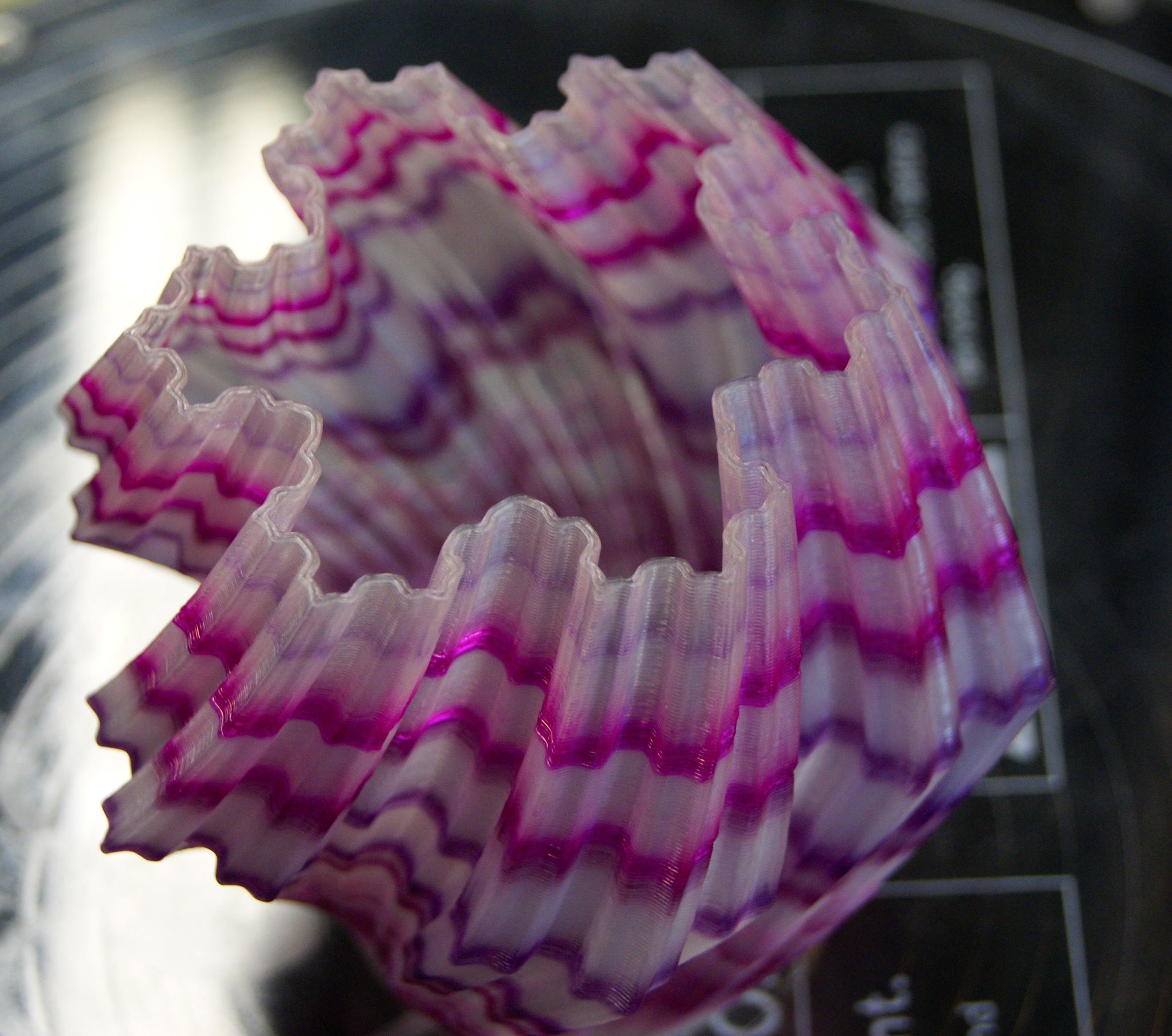

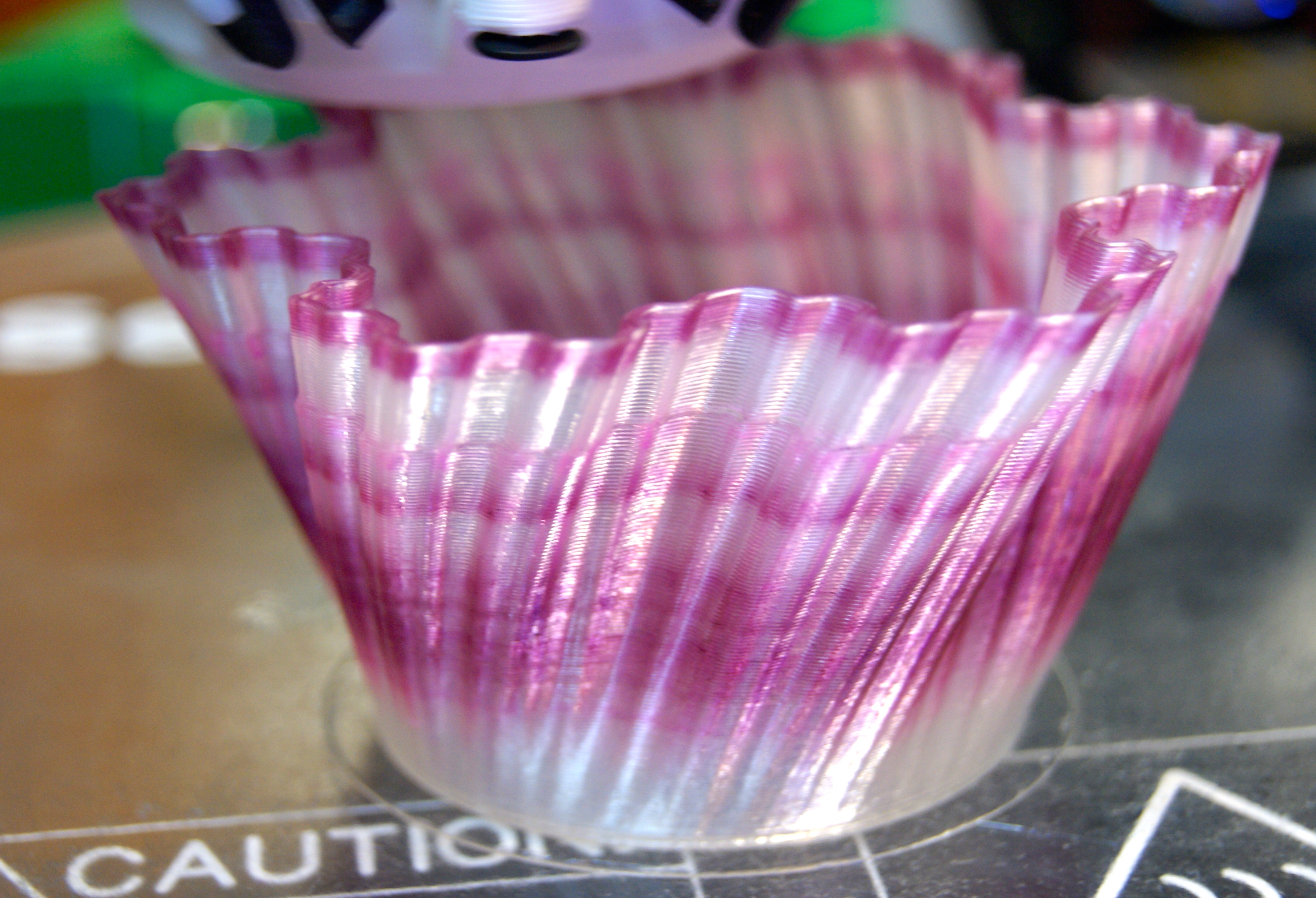

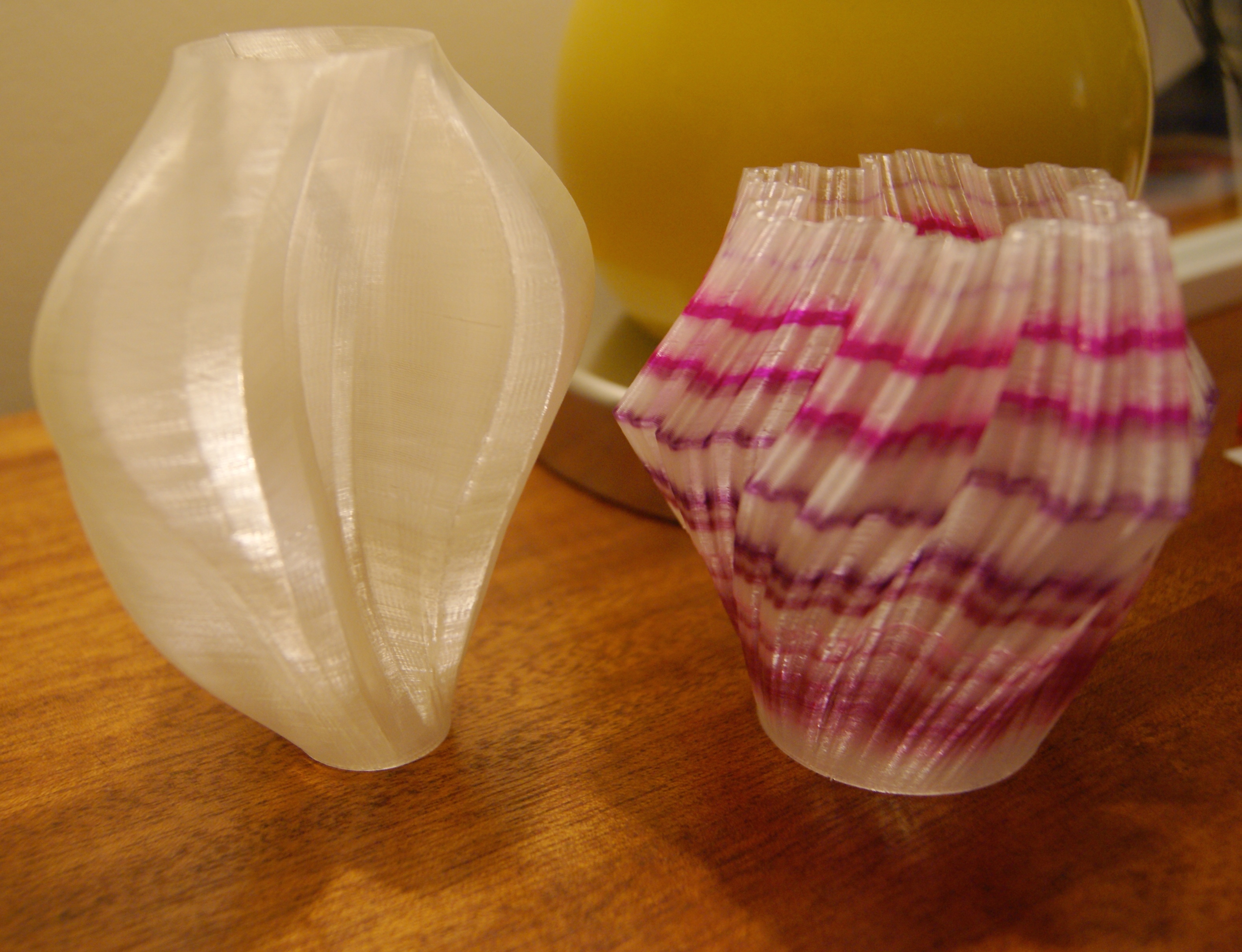

A few of my PLA prints. The Max v2 seems to do really well with thin walled vessels. I'm loving this printer,now I need to get ABS to behave like PLA. Yes vases are a bit boring but I think they're nice to really get acquainted with the slicers in Matter Control. Cure seems to be my favorite for this type of shape thus far.

would you mind sharing the process for the sharpie piece???
also what colored PLA is that?

Hi Dunginhawk, The material is Natural PLA from Micro Center, the brand is Toner plastics, it's the best I've used(especially for the price).For the colored vessel I just marked the filament right before it passed thru the hole in the top of the machine. I used a few colors of broad tip Sharpies. I marked the filament in 1 inch to 5-6 inch sections, there were other sections that I didn't mark for several inches. I originally set a marker next to the filament and tried to apply pressure with a weight, it was a bit too light so I removed that set up. Luckily I was doing other work in my shop so I just kept a watch and marked it when I remembered to check. Going to try leather dye next.dunginhawk wrote:would you mind sharing the process for the sharpie piece???
thanks
