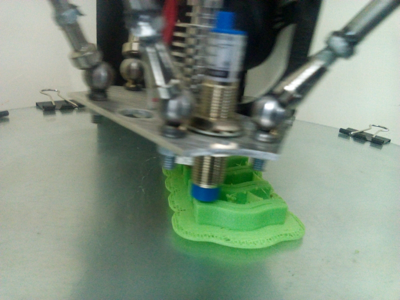

Nice! Is it possible to set up an inductive proximity probe on the Max v2?
Khalid Khattak
- Posts: 276
Re: My DELTA-1
you need 3US dollar inductive probe and a mounting at effector...

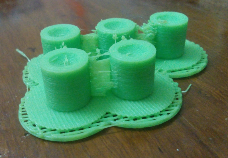

Now i need help
... why the bridging between the parts... and all my 5 cylindrical objects are somehow flat at exactly opposite side..why?

Though the auto-calibration function worked great and the sample test results were also promising...But i need much more than that...more accuracy, repeatability and precision or mix of all these ..Presently the bed is fixed and i can not adjust it for leveling purpose... .... So back to the CAD modelling stuff, designed the new part for precise leveling of the bed...The new part will help me leveling using 3-point contact method....Machined the part and can be seen how 6mm Nut set in the machined recess ... Unable to do all this without CNC.... i need the same accuracy of my CNC machine in the 3D printer...
