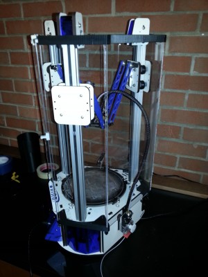

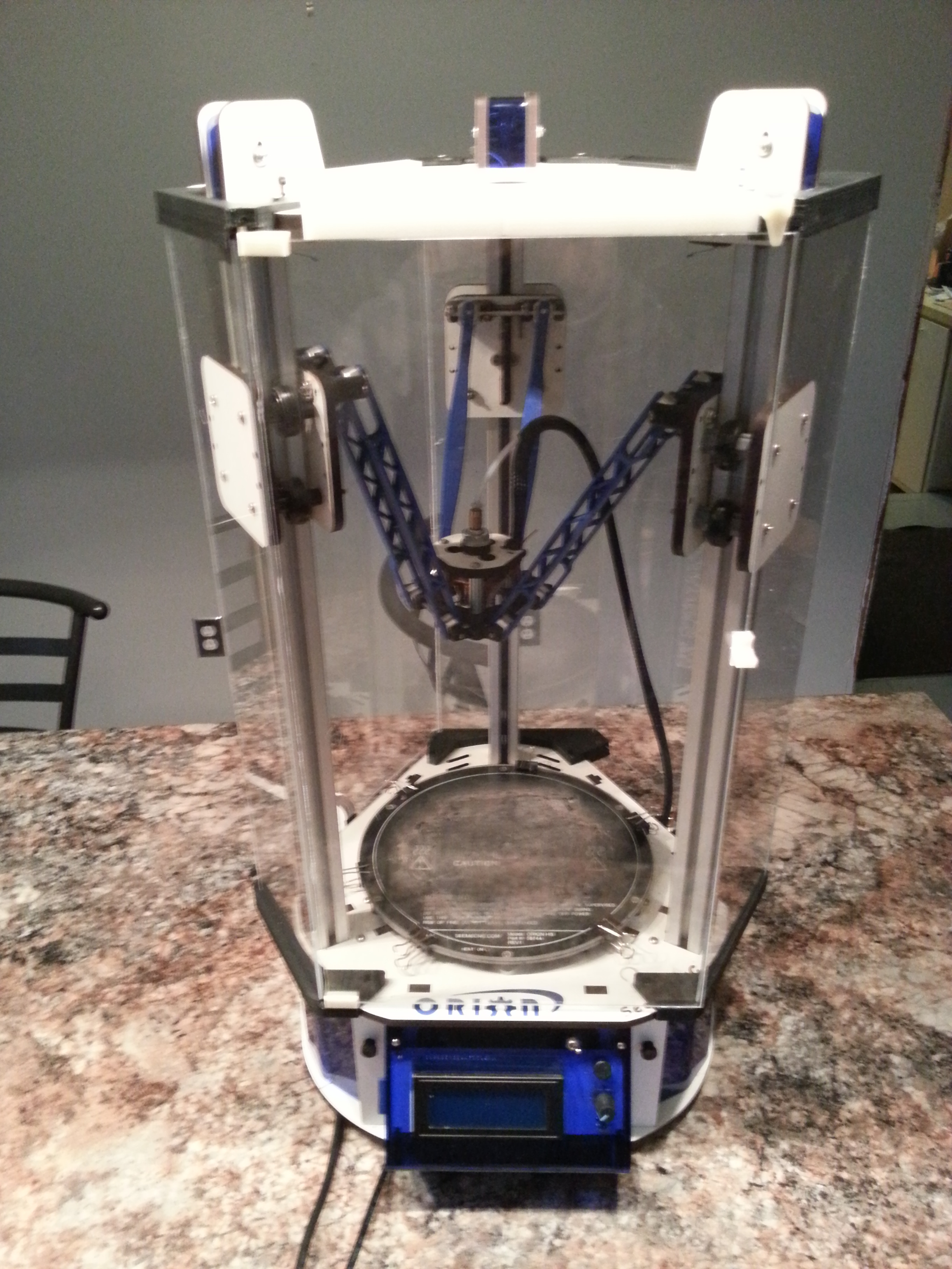

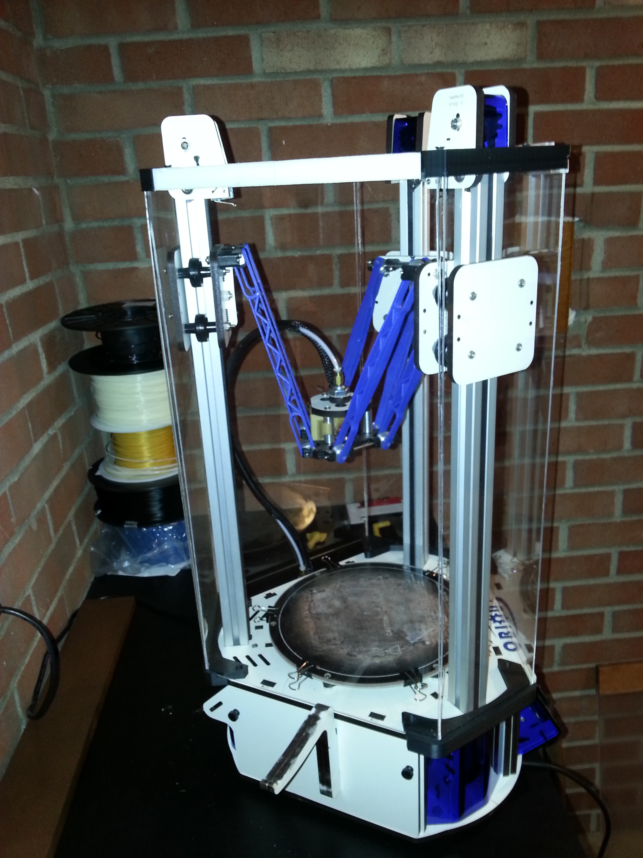

I finally finished my enclosure design for the Orion printer. it is very simple, clean and all can be printed on the Orion.
https://www.hightail.com/download/UlRTT ... bVVLSk5Vag
above is a link to the .stl files i created for this. will also get them posted on Thingaverse.
Plexiglas was purchased from Lowes, cut list is also attached for the sizes needed.

Looks great! Did you have to drill new holes in the Orion to fasten the brackets to?

That's really cool and like the fact you've used as many printed parts as possible. Especially like he flip up latch that's very neat.
Looks like it uses the original base screws at the bottom and in the video it looks like bolts at the top so must be drilled through?

the only holes drilled were on the top. the bottom are aligned with existing screws. going to add a thermometer and see what internal temps i am getting, then possibly add a light bulb to add some heat if needed.

put in a thermometer, it is holding at 90-91 degrees inside the enclosure for a 2 hour print. bed temp set at 80 and extruder set at 230. great results with my abs prints

I would like to build something like this for the Max V2. My one concern is cooling of the PSU. There are vents in the bottom plate that would then be inside the enclosure.
I wonder how easily the brackets you designed could be modified to fit the Max V2?

I assume lasermike was quoting his temperature in deg F. I have an enclosure for my Max and when I open the door and stick my hand in, it is nowhere near the temperature of boiling water. Having said that, the amount of heat that IS retained IS very helpful and part warping has pretty much become a thing of the past for me. (Along with other helpful mods like the PEI build surface.)

Yes it's true that the PSU has vents that lead into the chamber, but A.) the chamber is not airtight so some air will still flow anyway and B.) there are vents in the bottom of the printer as well, so I haven't bothered with redirecting airflow. I plan on printing new side panels with cooling fan mounts someday, but that is not a priority. Things work fine for now.
Bottom line after enclosure...
High-temp fans: didn't bother
PID retune: didn't bother
PSU cooling vents: didn't bother
Number of ruined components: zero
Overall enclosure rating: totally awesome, two thumbs up
