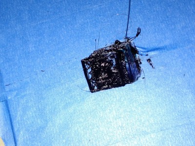

Hello all, I'm still trying to get a good first print. I have calibrated the machine very well however when I go to print the first layer tends to dig into the bed a bit. I raised the z height to get it to work but now every layer seems to shift away from the x tower and the print dosn't get any taller. just shifts. help please!

how about a pic of your first layer for starters? If the layer shifting in on one axis compair it to the other axis's and see if you feel anything binding up.

I already threw away the print. sorry. Ill take a pic when I try again. The x dosn't feel any more resistant to movement than the other axis
Yes to raise the z I just bumped up the Z0 by 0.3mm

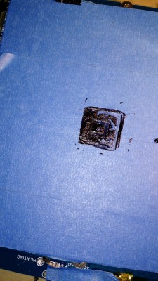

Each layer has the correct shape and dimensions but each layer is not placed directly on top of the next but shifted a couple millimeters

Attempted another print after some tweaking. same result :(

dylantep wrote:Attempted another print after some tweaking. same result :(
That looks like you are pushing the head way too far into the bed. Get it further from the bed, make sure when lines touch each other as the first layer goes down and there is a even amount of filament across the line.

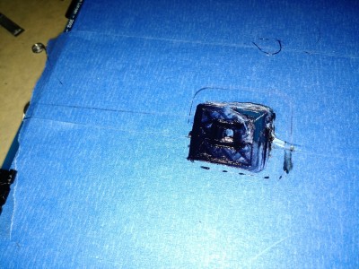

I raised it up by .7mm and screwed in the screw on the x tower so it would be a bit higher. had a pretty similar result. still smashed into the bed in the part closest to the x tower.

Check your x tower belts, make sure they aren't slipping which causes the print to shift.
When you set your z height are seeing if a sheet of paper can fit under the nozzle? I realize lifting the height up that much seems like a lot, but if the z height is set below the bed it needs to come up more.It looks like 4 or 5 layers all have the same amount of tape showing through, making me think even though the height is technically rising the nozzle isn't because it's nailed to the bed.

mlapaglia wrote:Check your x tower belts, make sure they aren't slipping which causes the print to shift.
I did a piece of paper folded in half for the center and the points closest to each tower. there was the same amount of friction (enough to still slide the paper around) at each of the points. now its way above the paper if I go to Z0 but when I print it seams it gets lower on the side near the x tower instead of going up each layer.
The belt is very tight and not slipping and the cheapskates seem to be just as tight as the other two towers. I'm really lost here.
