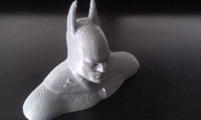

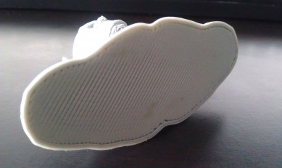

But notice the base showing gaps on the first few layers
Overall, this print looks decent to me

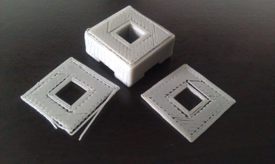

Notice the gaps between perimeter and infill, but only apparently on the first layers

What you're looking for is an "infill overlap." In most slicers you set it by percentage. I'm not sure Repetier/Slic3r has one but Cura, S3D and MatterControl do (among others). For instance, I use S3D and I have my infill overlap set to 80%.
