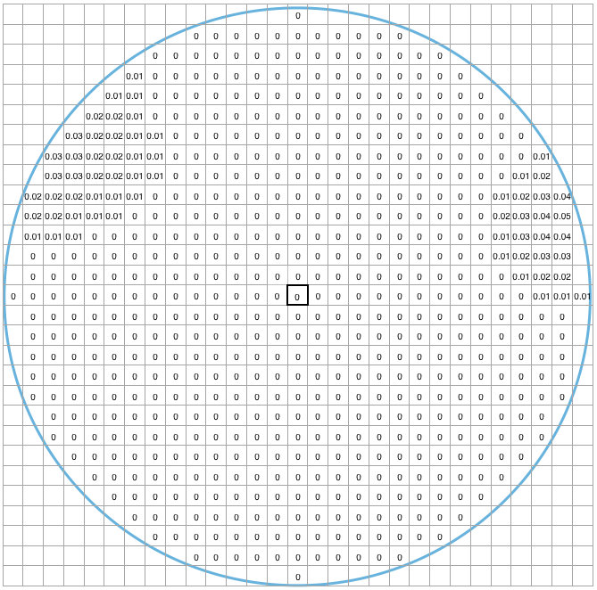

Hello all, I've had an idea for a year on how to solve the calibration problem on delta printers. I dragged my feet on implementing it since it seemed like the firmware guys were making progress. But now, a year later, it still is not where I hoped it would be. So I picked up on my idea and implemented a working prototype. Here are the prerequisites:
1) you must have a flat build plate - borosilicate glass is fine.
2) you must calibrate the bed center and all three tower positions for Z=0. This is easily done manually
3) you must have your delta arm length correct, again, easily done manually
4) you MUST use KISSlicer. I have not attempted to use it on other gcode.
Here's how it works
Currently, the delta Z height grid must be created manually. You can use a dial indicator, feeler gauges, Kentucky windage or probing feature in the firmware. I have a spreadsheet that lays out the required measurements. These are 10mm square cells and cover the entire bed and there are 803 measurements required! But do't panic. there is a Kentucky windage approach that can significantly cut down on the number of measurements.
Once the Z map is created, it is saved as a CSV (comma separated values) file right from Excel or Numbers. This is used by the gcode post processor.

Notice that each movement (G1) now has an explicit Z coordinate. This tells the printer firmware to interpolate the movement in three dimensions and not assume Z0.20. In practice I’ve not noticed any difference in printer performance and it does indeed planerize the movement of the effector so the first layer is consistent with an even thickness. Since the build surface is actually flat (a requirement for this to work) the changes in the Z coordinate are simply compensating for non-planar movement due to mechanical or calibration errors. This technique can remove a significant amount of introduced error too. However, it should be noted that while we are focused on the Z coordinate (which is important to get first layer adhesion) X and Y are likely slightly off too. This might result in very slightly misshaped parts but in practice, on my delta printers running this compensation, I’ve not been able to measure this in the final part dimensions.
The post processor is written in Python and can be called directly from KISSlicer or you can call it from the command line. You pass in the file path to the CSV Z height map file and the gcode file. It spits out a new file with the Z mapping.
Why 803 measurements may not be needed
Ideally, the data collection would be completely automated so 803 data points would not be a chore. I haven't implemented that yet but wanted to get this out there to test. One approach os to simply focus on those areas on your printer that are far off. There are reports of 2mm "lift" between towers on some printers. The center part of the bed and near the towers is pretty consistent though. So leave all of the delta Z values set to "0" and then measure or even eyeball the delta Zs in the hot spots. A few cycles of test and tweak should get you in the ball park. You could start with a specific region/hot spot on your bed and create the Z map for that area, test it and see what the outcome is. If it looks good, then make the investment in more data points or a probe.
If you are interested in testing this, I'm happy to give you the spreadsheet and code. I can not spend a lot of time on support so please don't expect me to hand hold you through setting everything up. Perhaps folks can help each other here and if you have a question, post here, don't ask me privately! I've only created a spreadsheet for the Rostock but it could be easily changed to support the Orion or other deltas. The program is called ZMapper.py and I'm the only one who has tested it so it likely will have a bug or two. At this point, it does a simple table lookup to get the delta Z value. Ideally it will do a linear interpolation, but I want to validate the concept before putting a lot of effort into it. I don't want to post the code at this point so PM me please.

Z measurement instructions...
I forgot to add this to the original post so here goes...
The values in the CSV (matrix) are delta Z values. First you need the Z length at X=Y=Z=0 (center of the plate, nozzle just grazing a sheet of paper).
For each data point you collect with a probe, you want to SUBTRACT the Z length from that value to get delta Z values. "Dips" will be positive, "humps" will be negative. Here is an example that shows the map of my Rostock Max V1:
Note that it has 2 low areas between the X-Z and Y-Z towers (Z is at the top).
If I had humps, there would be some (-) values in there.
So, if you think about it, if you know that you have a "dip" between the X-Z towers that's about 1mm (you could even measure it with a feeler gauge - metric) you could populate this area by hand and slowly decrease the value out to the edge of the area by decreasing the delta Z by a bit (say .05mm is reasonable). You'd be surprised how close you can actually get it.
Finally, once you create the spreadsheet, export or save it as a CSV file with a cvs extension.

Code so far. Might work on Windows and Mac.
If you have issues, it's probably related to the matplotlib backend, which you may want to change from TKAgg to wx or something, in the generator.py file in the lib directory.
Should work if your printer has a RAMBo board.
Edit values in EZMapper.py including build plate radius, com port, and baud rate.
The speeds and times set are modest, and show how the algorithm works. There are some issues still with the printer communication, but as I learn more about driving it, It'll straighten out.
Comes out of the box neutered, shoul dbe able to just run EZMapper.py and see the magic happen.

In talking with Jimustanguitar yesterday about the data collection I had a bit of an "ah ha" moment. The Rostock has a BIG bed that requires over 700 data points to map out. But, most of the points are not in problem areas. For instance, almost everyone can dial in a 4" diameter area at the center of their bed. It's the areas between towers that are the most problematic. With the 4 point calibration for delta radius and tower lengths you can be certain that things are planar from the center to each of the three towers - and this is easy to accomplish with manual calibration on every printer I've worked with. It's that peak nether region between towers that is an issue. So, I came up with a way to reduce the number of collected data points to 25 (Rostock) or 19 (Orian/Kossel) and use interpolation to fill in the blanks. My math shows that even if your printer has a 5mm non-planarity issue, I should be able to compensate that out to less than .05mm and maybe more. I recalled a form of interpolation that I used on a digital camera product I developed in 2002 called Barycentric interpolation that should work well. The idea is to divide the platter up into triangles and use the corners of those triangles as data collection points. Then, one uses the corners to interpolate any point within the triangle. There is a good summary of it here: https://classes.soe.ucsc.edu/cmps160/Fa ... lation.pdf
The cool thing is, I can arrange the data points/triangle corners such that I get better coverage/resolution in the problem areas between towers. It might take a little experimentation to find an optimal arrangement of points. But reducing the number of data points collect to 25 means that you could do the matrix generation manually in 5 minutes using a simple touch probe.
(The touch probe is simply a 1/4" or so rod about 1/4" tall that has a wire attached. Another wire is attached to your hot end. These two wires run into your RAMBo on the Z min switch input. When the nozzle touches the probe, it completes the circuit, triggering a "touch". This is very reproducible and accurate and used on CNC machines. The movement of the nozzle is done via a gcode script similar to the one Jim created. As the nozzle moves to a new point, you just position the probe under it and wait for the touch. I did it in 3 minutes last night. Very simple, very effective, very cheap, very convenient.)
Cheers,
Michael

This is a really cool thread. I've learned a lot from it.
I can't wait to get my indicator set up so I can map my bed, and then compare different compensation techniques.
The M code M114 allegedly returns the current position, but it behaves in an odd manner. Sometimes, if you execute a G1 command followed by an M114, the printer won't respond with the coordinates until the G1 finishes, which is awesome. Sometimes, though, it will respond immediately with the coordinates given to the G1, before the print head actually gets there.
My hope is that I can remove all the wait times and just rely on the printer being told to go somewhere, and then telling me when it actually got there, so that measurements and steps could be taken in a continuous (e.g., fast) manner.
does z-min check continuity or voltage? If so, then the touch probe could also be a .005" shim with a piece of wire (powered, if voltage is required) carefully attached to it.
One of the things I'm curious about is whether or not there is a difference in z height at different layer heights.
e.g., for z=0, real z may actually be high by 10 thousandths of an inch, but at z=1, maybe it's high by 8 thousandths. The indicator should be able to shed some light on that.

BRILLIANT!! you don't even need to fart around with a dial indicator. Simple and just as accurate (or more) than a indicator.(The touch probe is simply a 1/4" or so rod about 1/4" tall that has a wire attached. Another wire is attached to your hot end. These two wires run into your RAMBo on the Z min switch input. When the nozzle touches the probe, it completes the circuit, triggering a "touch". This is very reproducible and accurate and used on CNC machines. The movement of the nozzle is done via a gcode script similar to the one Jim created. As the nozzle moves to a new point, you just position the probe under it and wait for the touch. I did it in 3 minutes last night. Very simple, very effective, very cheap, very convenient.)
I love it.
Re: Experimental gcode auto Z compensation ready to test...
Repetier supports a probing gcode - G30 - that will probe and report the point. You need that for probes that are triggered. For an indicator, a simple G1 should be fine with a pause. Jim's script does that.
I just sent Jim the updated 25 points to scan so he is working on the new script. I've already implemented the Barycentric interpolation and "point in triangle" test and had another "ah ha" moment with that. They are combined into a single function. Turns out that Barycentric coordinates are a good way to determine if a point is in a triangle. So, if you are testing to see which triangle the point is in and it is, you've already done all the math. I love it when things come together/
Z min would act just like an endstop switch. It triggers when the probe touches (so it is a normally open NO switch). It checks continuity. Yes, the probe could be thin. I use .001" SS for my milling machine. I plan to do the same for this probe. But I wanted to keep it conceptually simple for folks here. We can get into the details/enhancements once we have some results!
Your last question is a good one. Mechanical issues may very well result in non-linear delta zs. Calibration errors might too, I need to think about that.
