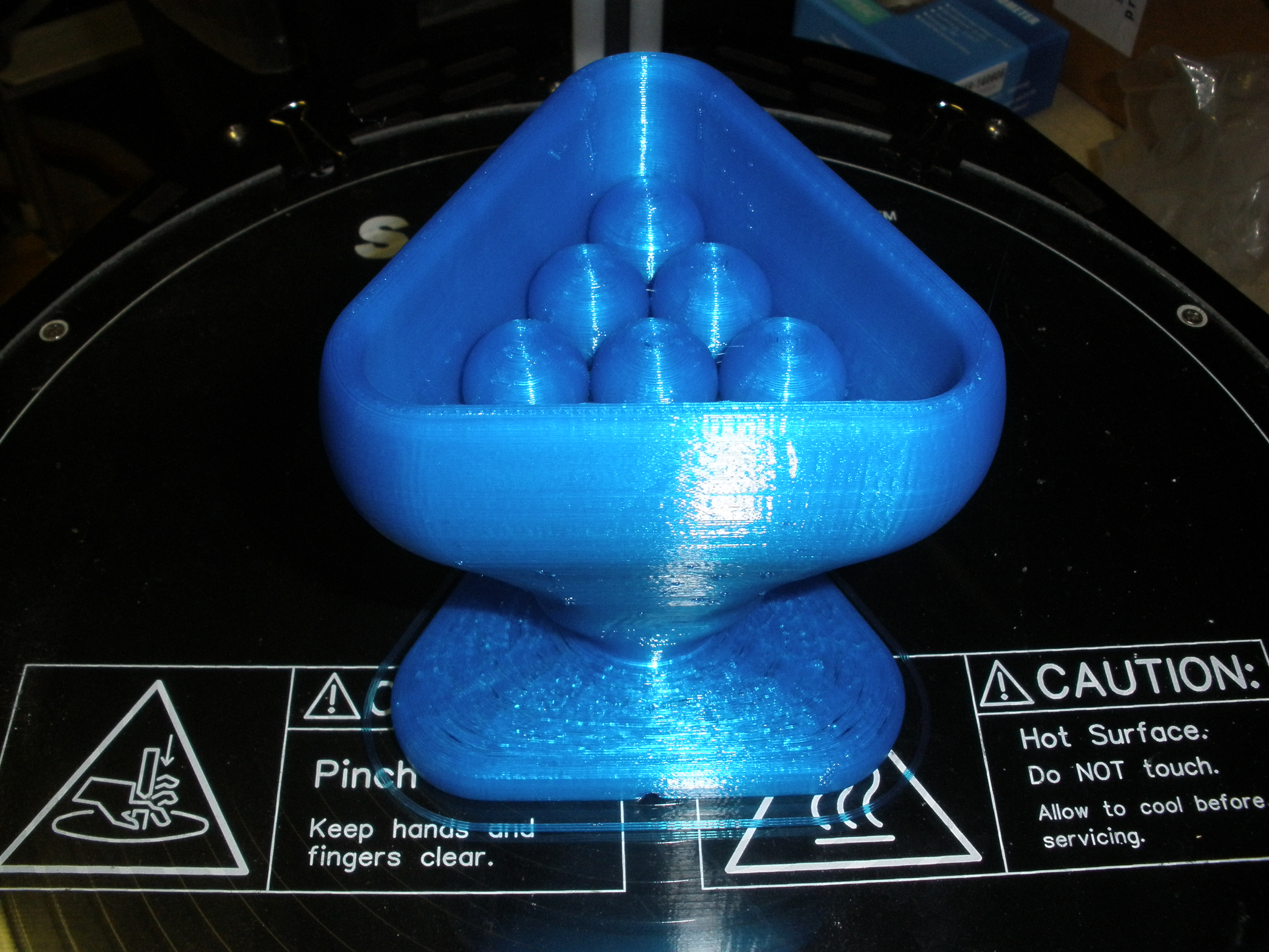

The thing I just printed has the pattern. Narrow spacing compared to the infill. You can see it in the attached picture.
Infill 10%
Slicer S3D
Speed default (50mm/s infill, don't remember what perimeters are).

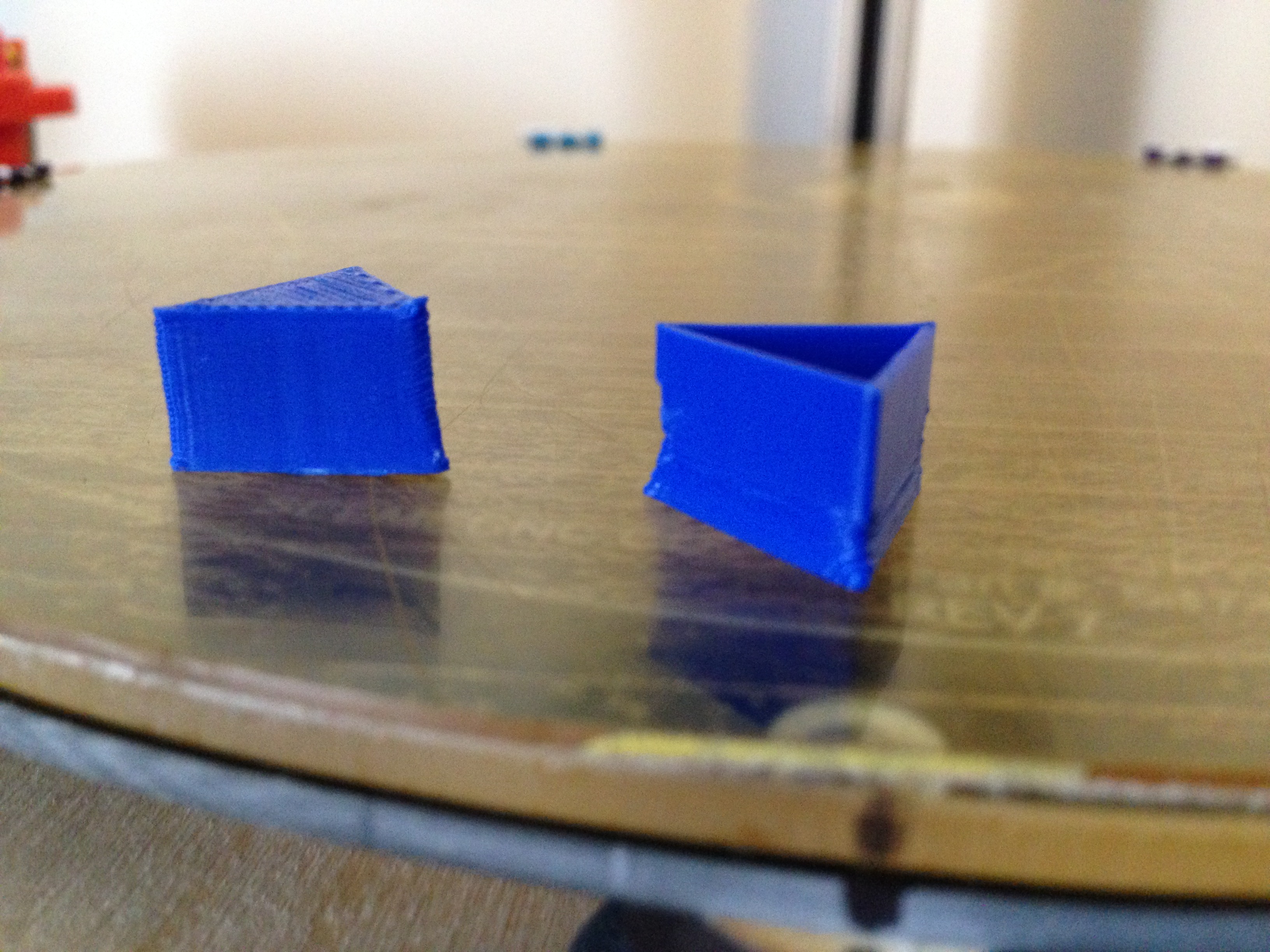

I didn't realize how small this stupid thing was. I was expecting it to be a good 5-10cm per side.
I used your exact g-code. I had to turn off the fan and bump up the temps, but it worked out fine. My results are more of "what good cooling fans can do for a small and fast ABS print"
When I said "I don't get much banding" I was only thinking of the non square parts I had printed. I don't print much square stuff (or things with large flat faces). Looking back on the few things that I have, I realize I actually do. Prime example of this I don't think is a good example, because its suffering from a few other issues (mainly over extrusion) so I think the banding is more pronounced.
The goal was to print on multiple machines to see what effects different hardware has on the same g-code. Since I have 32x drivers and TL arms I was expecting my banding to be less pronounced that someone else's without. Would be interesting to see someone with a smoothie.
The main question I have is how accurate your pictures are to the actual scale of the issue, Jim. Is that just the camera, or does that print you did 4 posts ago really look that banded?
KAS showed the same object sliced in different slicers. I'm wondering if the differences were due to each slicer calculating the paths/speeds slightly differently (assuming you used the same speed settings for each) or if some of them segmented each line into smaller segments for whatever reason? That would have to be checked in a g-code viewer.
After all that, heres my results. Its hard to get enough light to see everything properly.
Really blurry, but the flashlight I shined on it helped show the banding a bit better

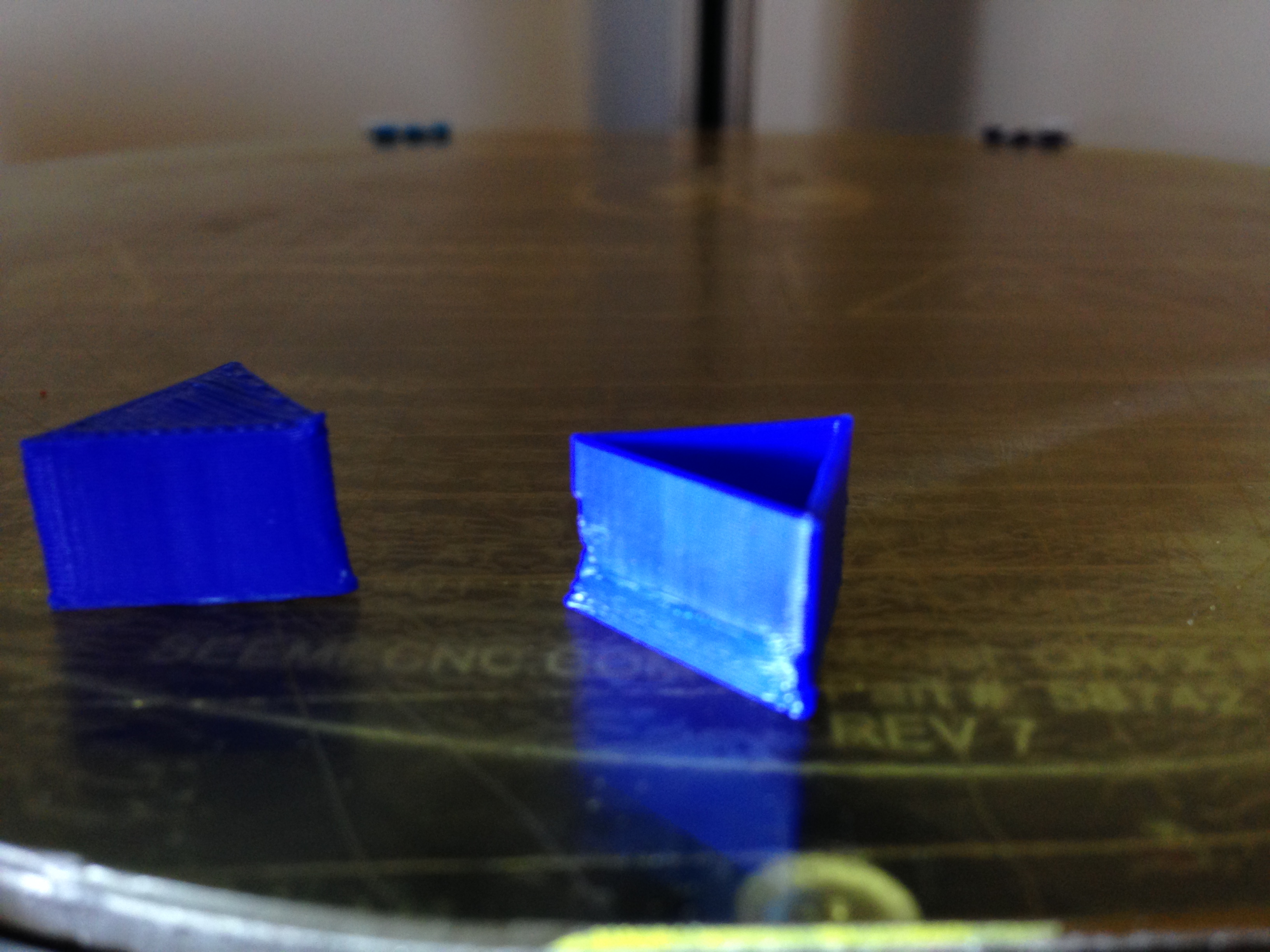

Again not the best of pictures. It does show the benefits of ABS cooling on the left part though. Sped up to 300% speed (Cura slowed it down) and so I turned on the layer fan to 50%
(I didn't enable the layer fan until it got around 3mm up so it started mushrooming)
