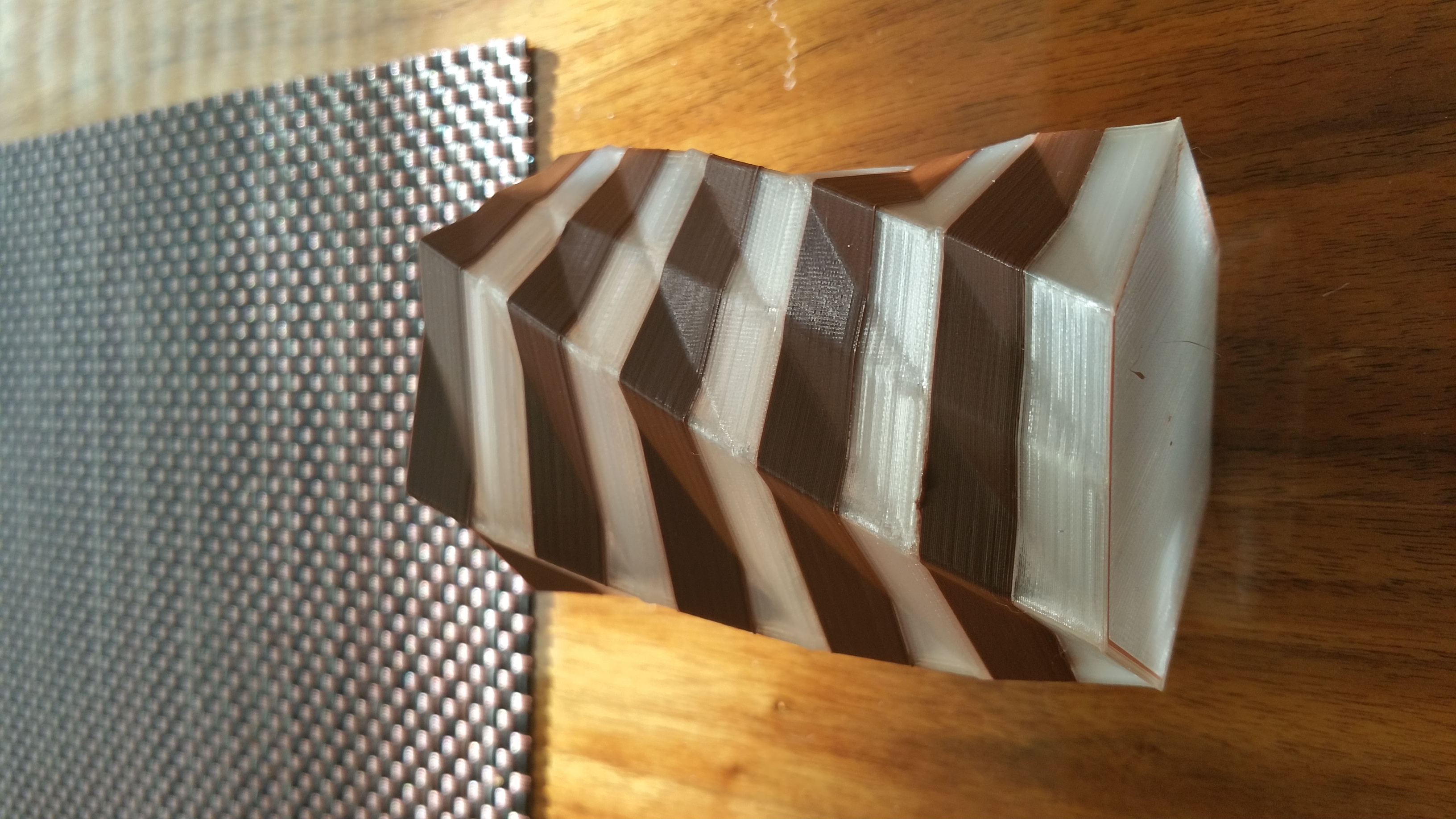

got the cyclops up and running, after figuring out chimera with s3d, this is my first attempt at a print... no tweaking has been performed yet.
[img]https://lh6.googleusercontent.com/-l7ov ... 001759.jpg[/img]
[img]https://lh4.googleusercontent.com/-lW8F ... 001921.jpg[/img]
[img]https://lh4.googleusercontent.com/-aZGU ... 001859.jpg[/img]
[img]https://lh4.googleusercontent.com/-gwvM ... 002533.jpg[/img]
extruder 1 is clear and doing perimeters, extruder 2 is brown doing infill.
