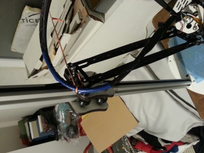

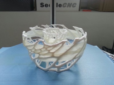

So I'm relatively new to 3d printing, but I made more than 10 objects without major problems up until now. Today I decided to make something 'slightly' more complex, namely the cellular lamp from nervoussystem at thingiverse (http://www.thingiverse.com/thing:19104). After some initial tweeking, I started the print at 80% speed and with 85% extrusion factor. It printed fine until about halfway, when all of a sudden the printer starts 'printing in the air'. This resulted in a beautiful blob of spiderweb filament on top of my print.
After this event, it seems that it is still printing layers of the lamp based on the movements of the extruder, but the offset (Z offset, but also X and Y) seems to be wrong.
For not having to throw away my print, I removed the spiderweb blob, looked which layers were already printed, removed these from the gcode, and restarted the print. To my own surprise this worked quite well and the printer resumed more or less where it had left off. After 3 layers, I experienced exactly the same problem (only three layers higher).
I again repeated the process of removing the gcode lines that were printed and restarted the print. I wasn't sure if the problem was related to the Mach board having to process too many instructions, so just to make sure, I set the speed to 50%. Print worked again pretty well for about an additional 1 cm of Z height (=50 layers) and again the same problem occured.
Any thoughts on what the cause of this strange behaviour could be? This seems to be either Mach related or a hardware-related problem (e.g. due to my soldering skills
I attached two images, one with the current unfinished print and one with the spider web blob (note that I cheated a little with the spiderweb blob as I removed it first and then placed it back for the picture).
