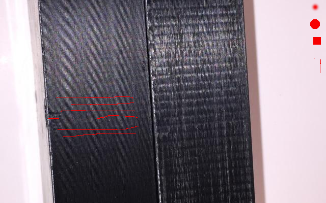

I have two printers, a rostock max v2 and a flashforge creator pro and i get NO banding on the FF at all.
[img]http://i1132.photobucket.com/albums/m562/dunginhawk/C2257739-DF37-43AD-B2B7-5F73471762E2_zpsjbe4dbbq.jpg[/img]
Tonkabot
Posts: 251
Location: Minnesota
Re: Vertical Banding Revisited
Post by Tonkabot »
It looks to me like there is banding, just not very pronounced.

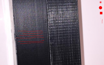

Yeah i didnt mean to say no banding, but 95% less than my rostock, and im completely willing to accept I may need to tune my printer even more to get it better. but circular prints are great, with little to no banding.
this picture really amplifies it too, so the tiniest bit of banding shows up on the left print, where the right looks worse than it is, although its pretty bad.
I can see them a little bit in the photo. The plastic just has a different sheen to it.
Interestingly, FlashForge's website shows the same kind of ridges in their promo photos for the dreamer model:

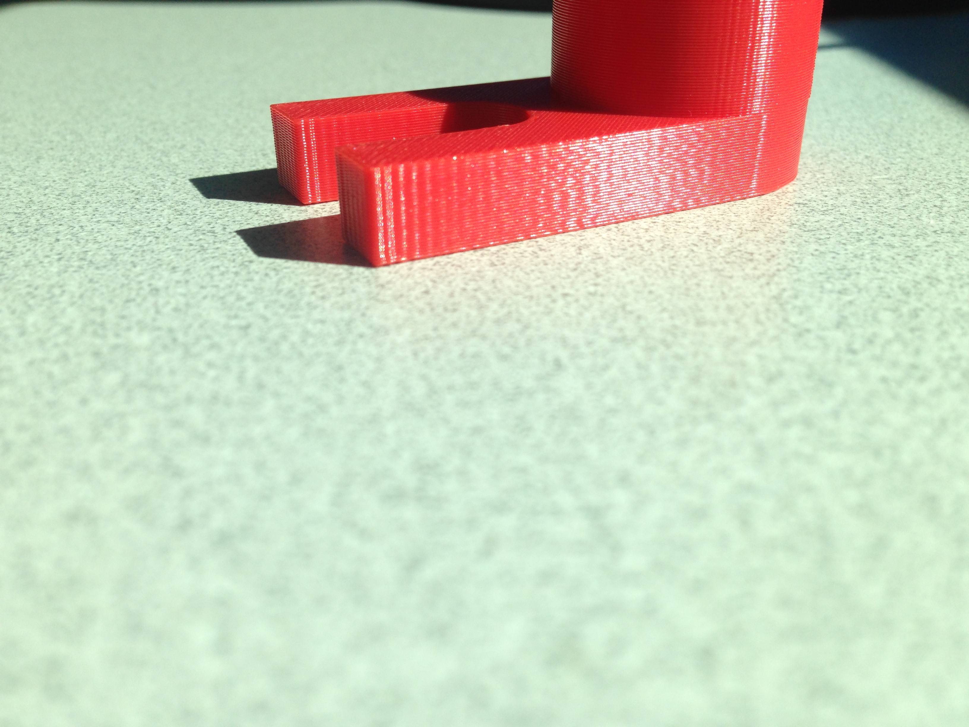

Exact same print setting except I took off the Astrosyn dampers. I'll be honest in saying, I'll never put them back on.
Still have the banding, but the print quality is much improved from the original.

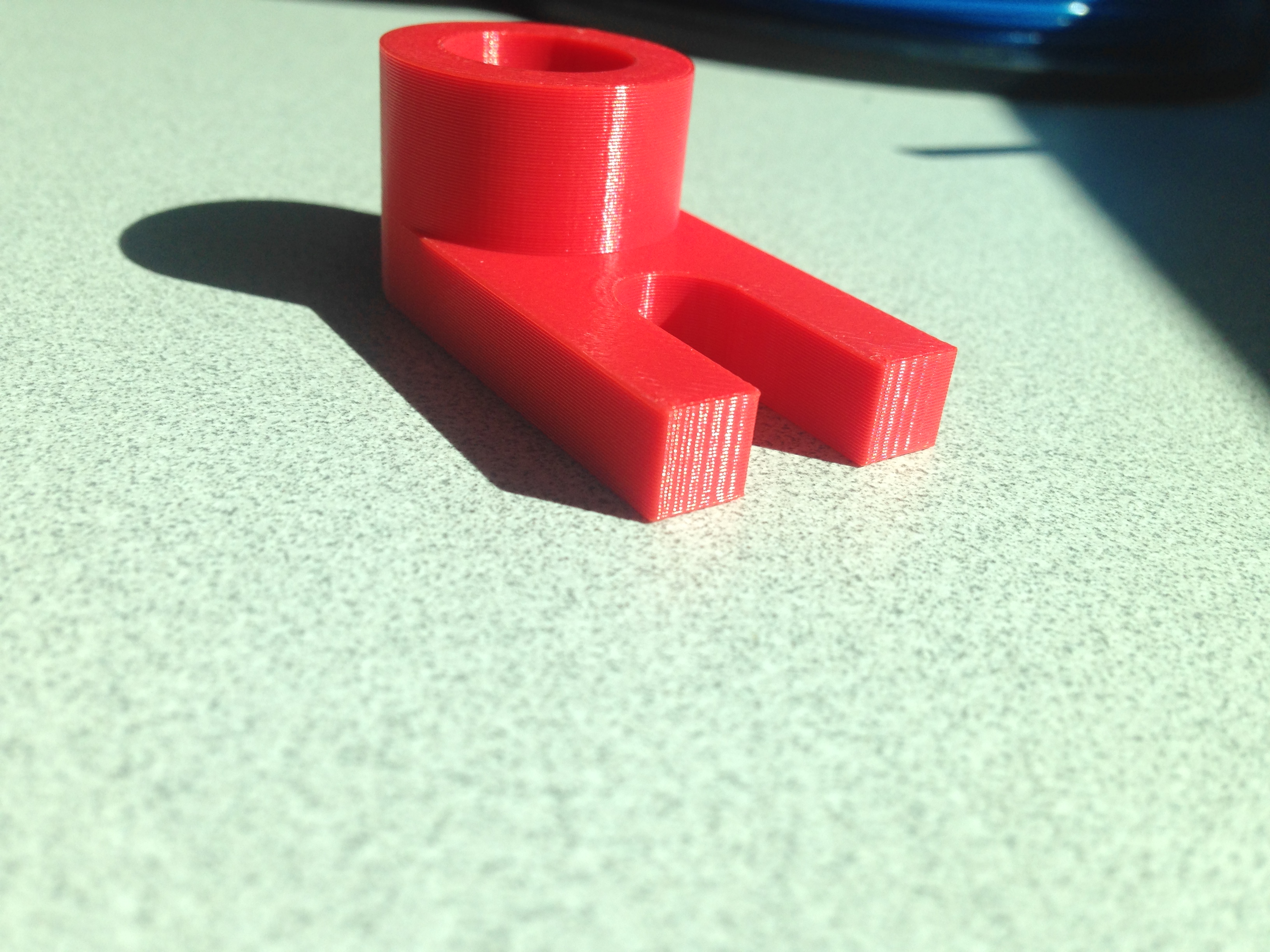

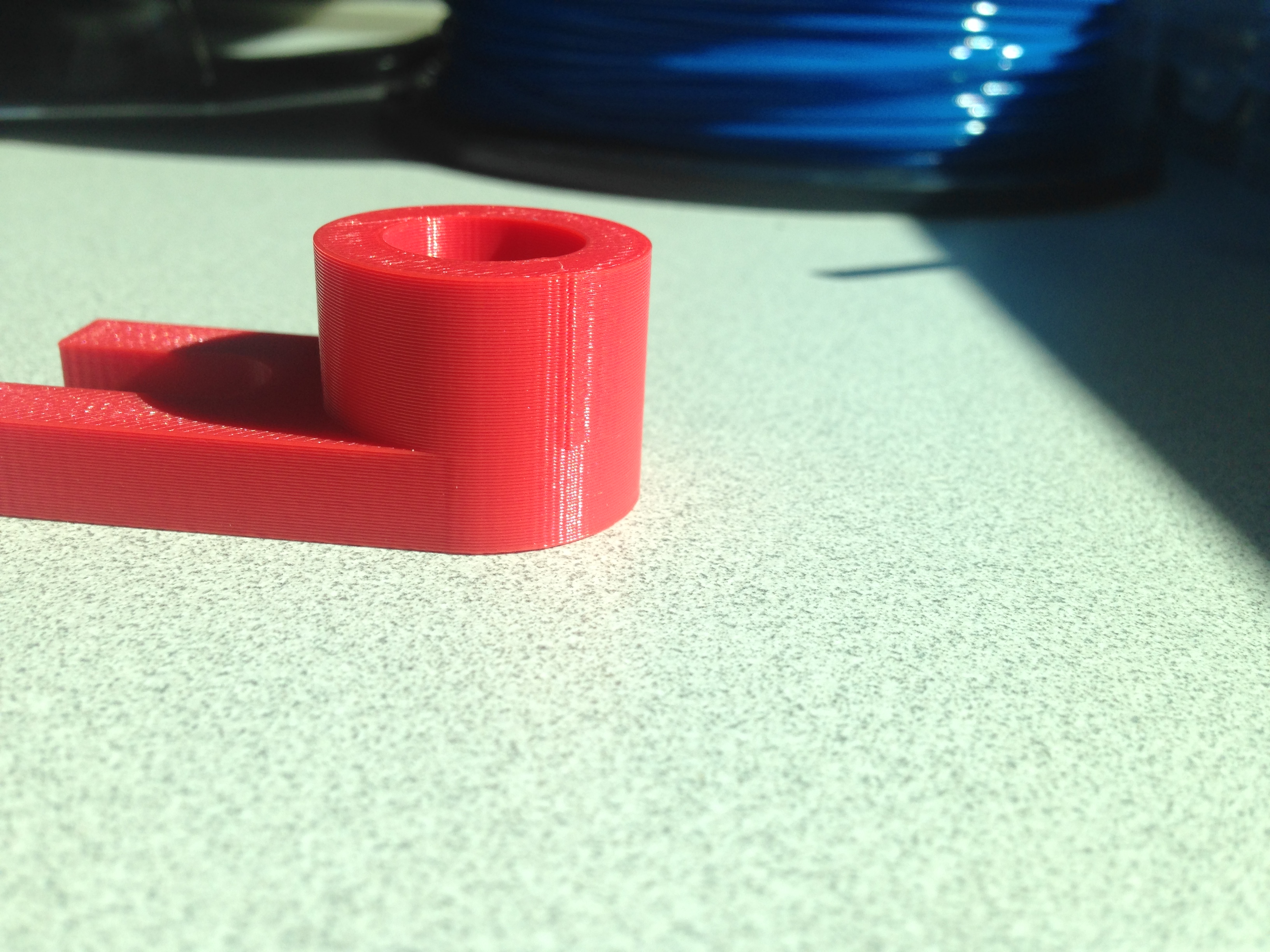

Can you guys feel your vertical banding?

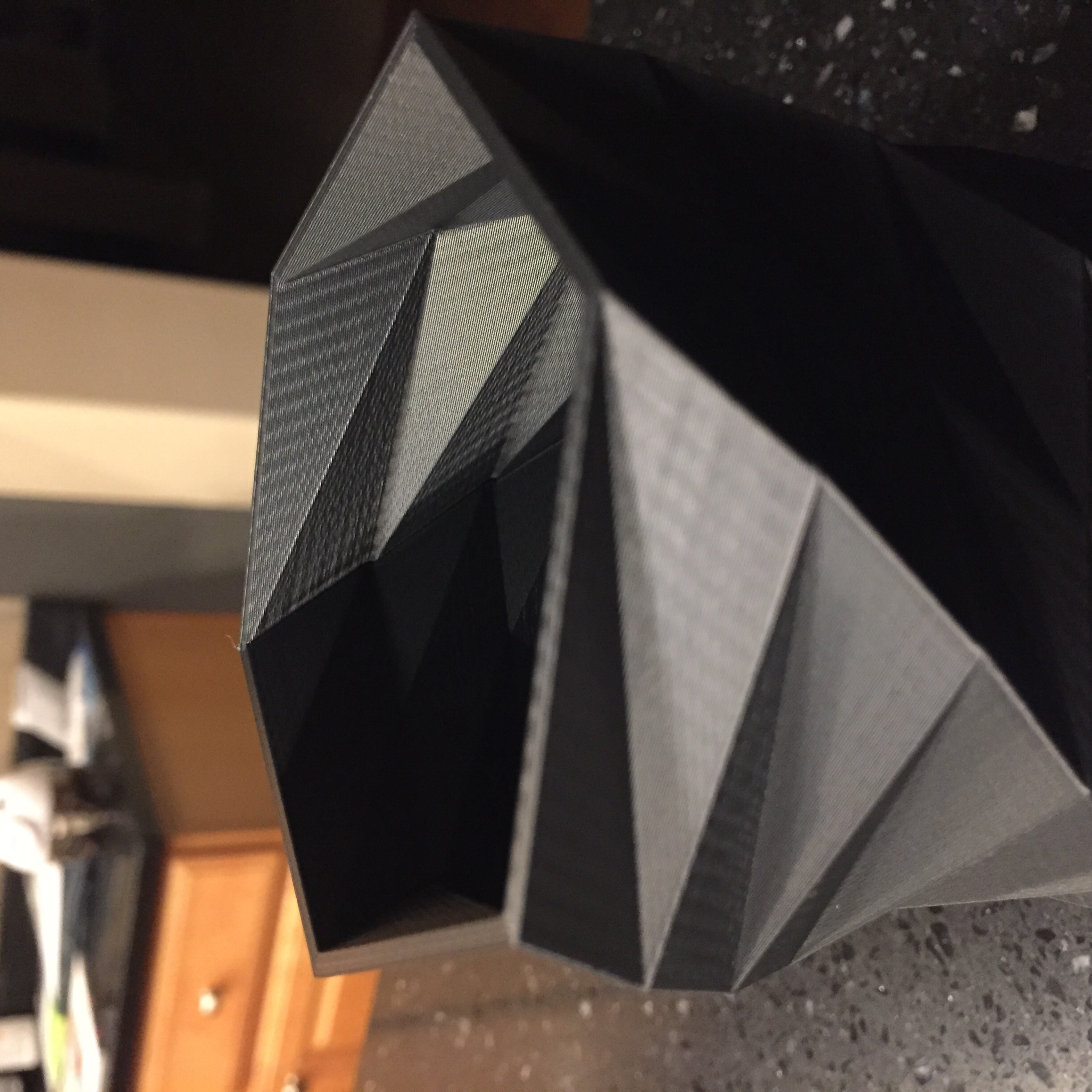

I printed a part in black ABS yesterday and I can see a hint of vertical banding on flat surfaces that changes as speed changes(layer time cooling adjustments in software) but its not something I can feel.
Curved surfaces seem to have more pronounced vertical banding but I think that is largely the mesh

What speeds are you printing. My settings are: Infill 40 mm/s, inside perimeters 40 mm/s, outside perimeters 30 mm/s, and non print moves 300 mm/s.
I only notice this with black and on the vase image attached. I slowed my printing down after my first few prints and have never picked up the speed since that time. It makes since and if so the band would be closer together at the center of the bed than at a the edge with the idea that when the delta arms are at 45 degrees the movement with each step would be less than when they are at 30 degrees and most prominent when the print line is parallel to the delta arm in reference. Humm thinking twice about that one.
In the end you are thinking this is due to stepper degrees?

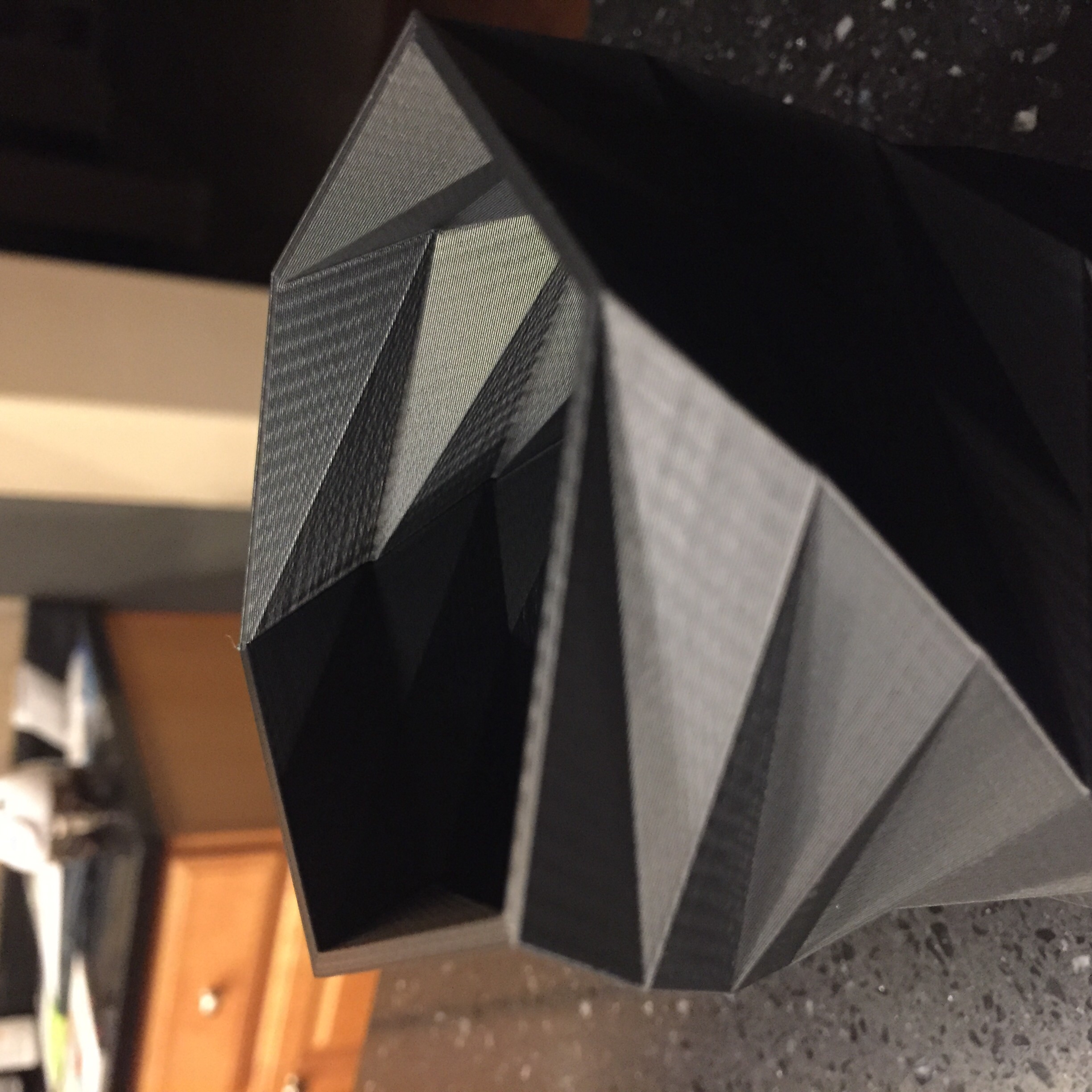

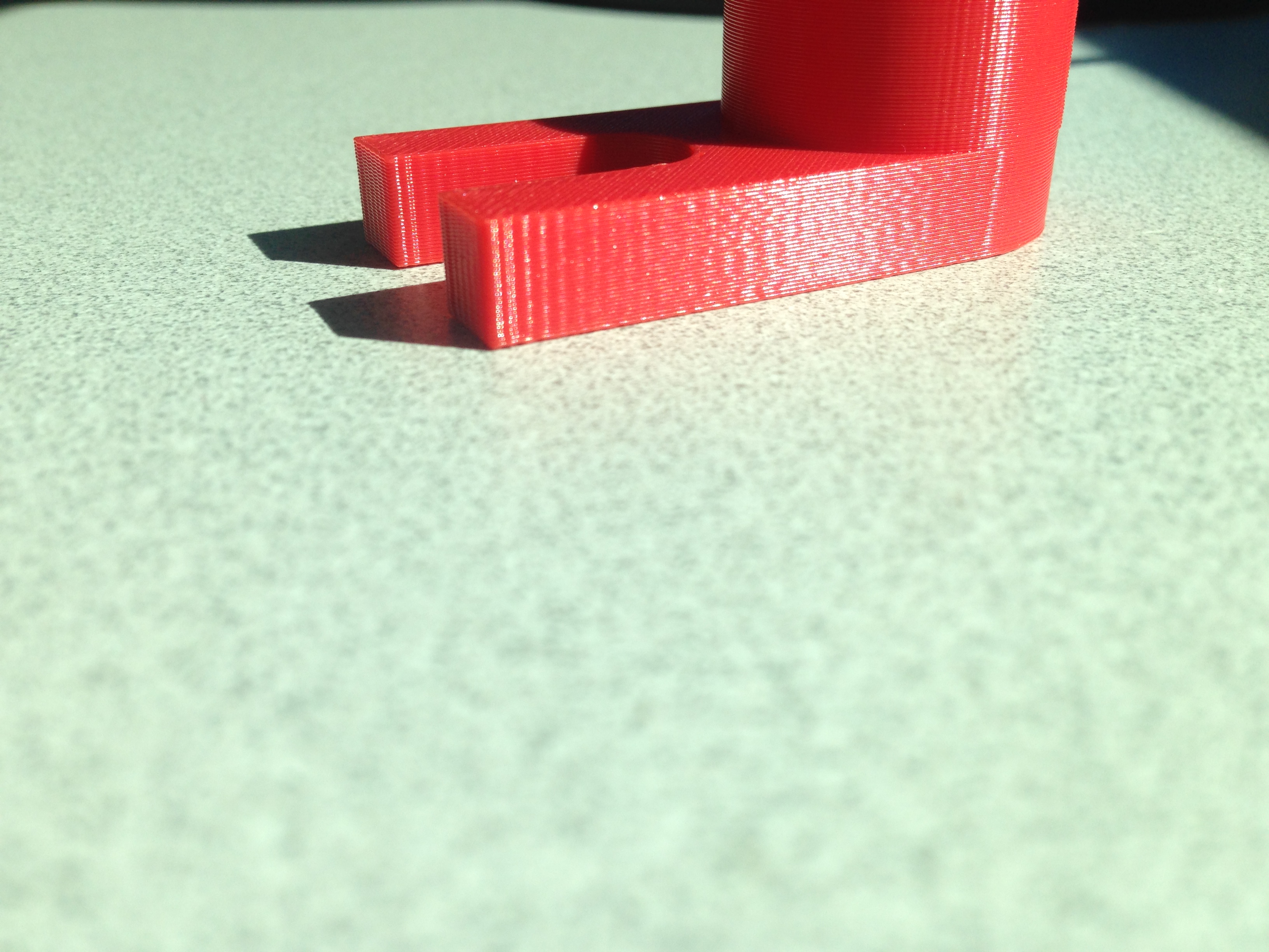

More stuff to throw into the equation, this is from a high end ABS printer, one of the super crazy expensive ones, I think maybe a Stratasys Mojo or something like that, these are probably from a year ago, or a bit less. I got my hands on them because my school district can outsource printing to a local place that has a few of those kinds of printers.
Banding on the front
Banding towards the end
I think it might be related to accelerations, at least with these prints.

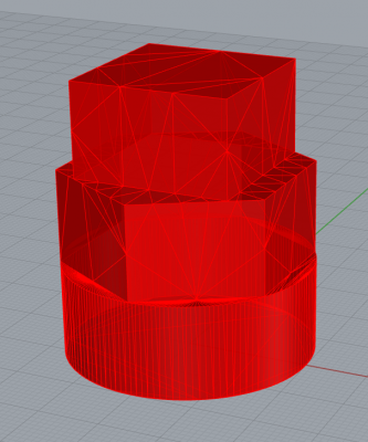

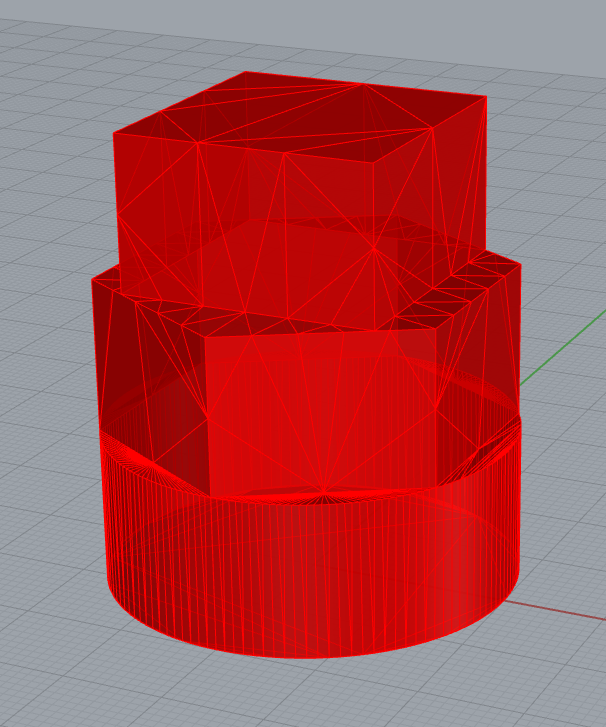

Ok, in an effort to help us compare apples to apples as easily as possible I put together this model - BandAid:
BandAid.stl
(37.78 KiB) Downloaded 593 times
It is a 15mm tall 40mm diameter cylinder with a 15mm tall hexagon extrusion on top and a 15mm tall square extrusion on top of that. Designed to be relatively quick to print but collect a lot of data. You get a curved surface, surfaces not aligned with X or Y and surface in the X-Y plane all in one model. I made the mesh in Rhino and used the highest mesh density it outputs (density=1) to eliminate as many mesh artifacts as possible.
I'm slicing in KISS for my .4mm nozzle Kraken hot end: .4mm extrusion width, .2mm layer height, 25% straight infill, 2 loops/perimeters. .4mm skin thickness (2 layers) at 32.5mm/s perimeters, 42.5mm/s loops, 35mm/s solid and 45mm/s sparse for speeds. If we could each print one of these trying to duplicate these settings it will help comparison. Black filament probably preferred.
