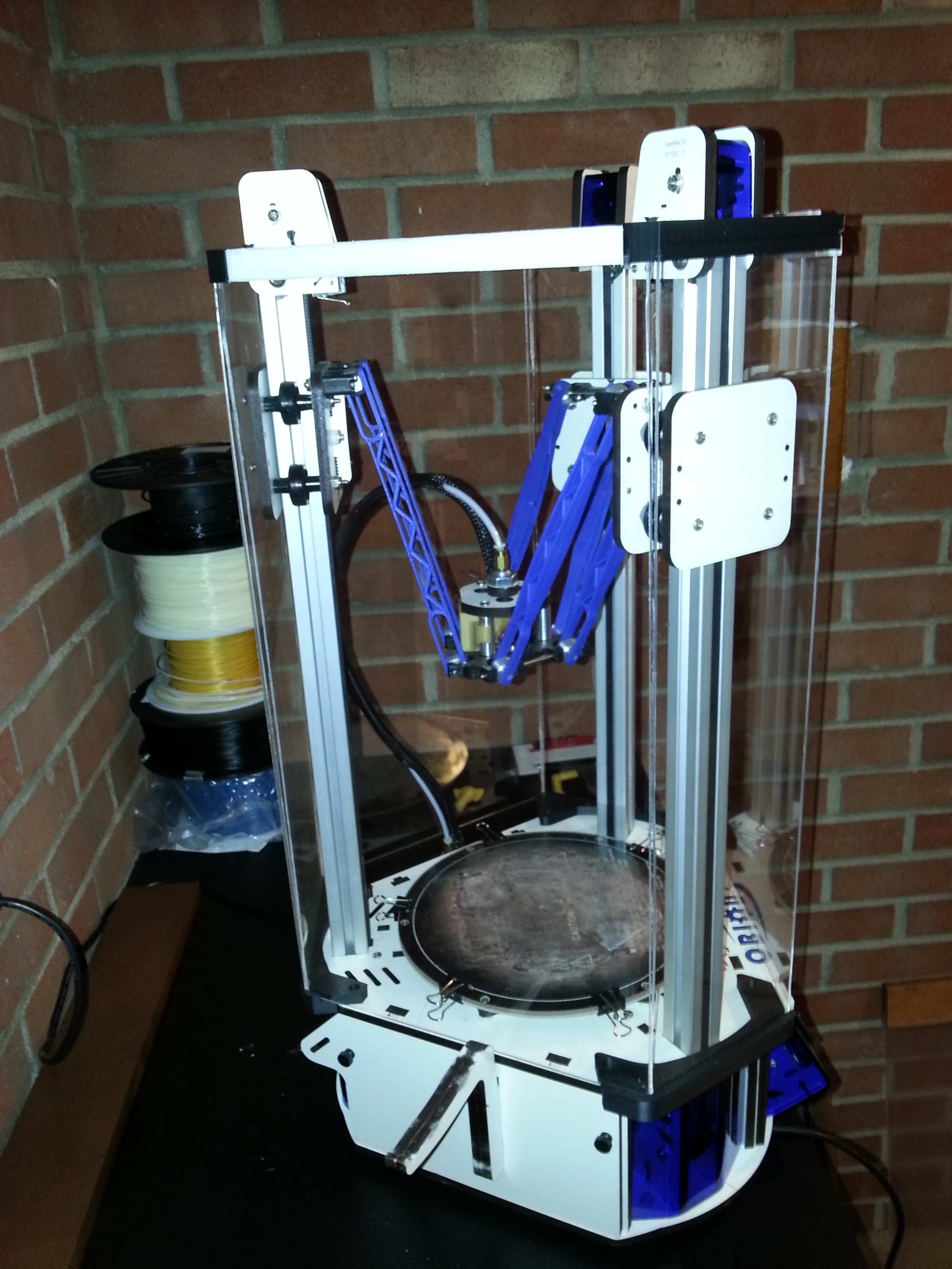

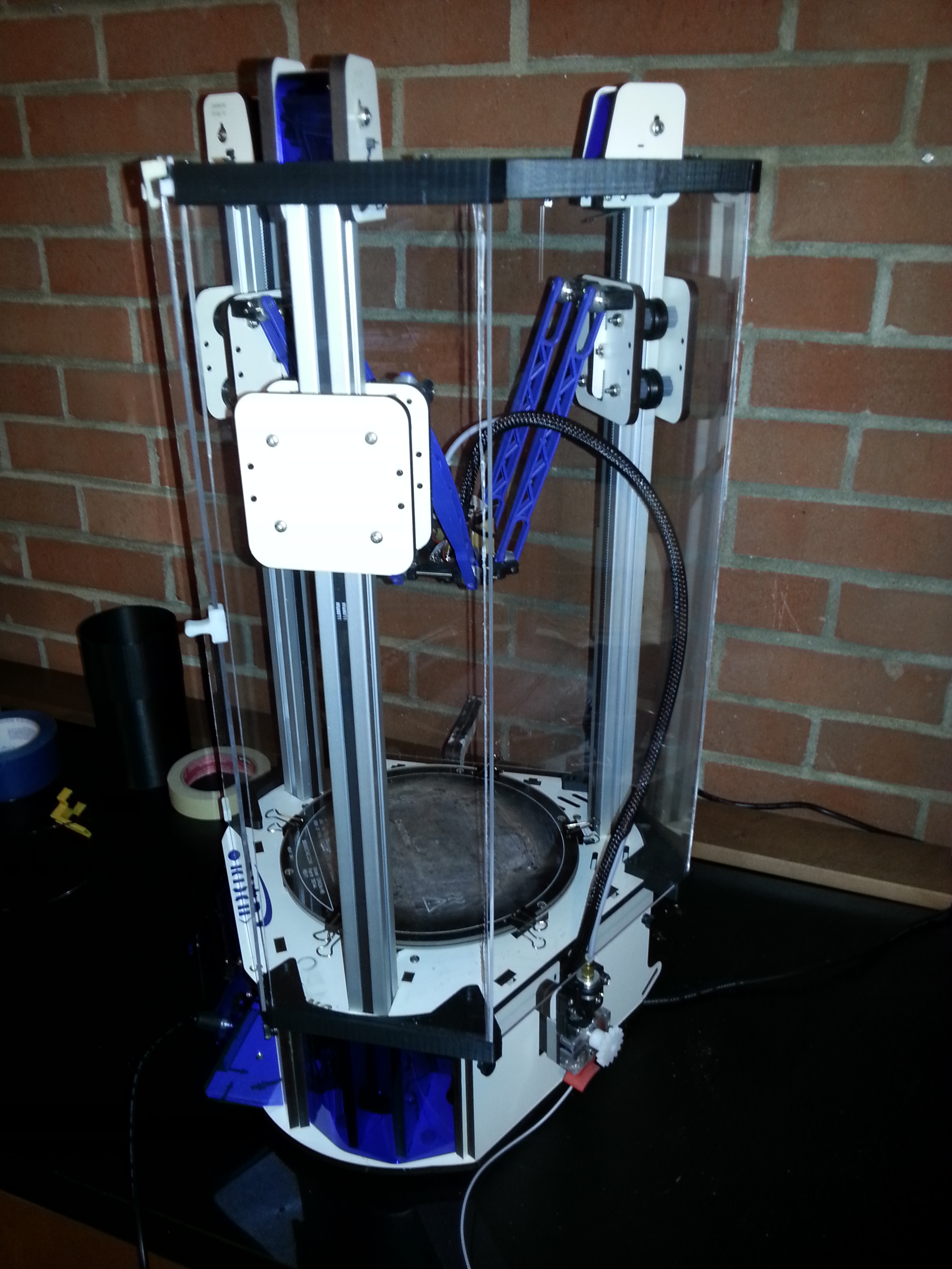

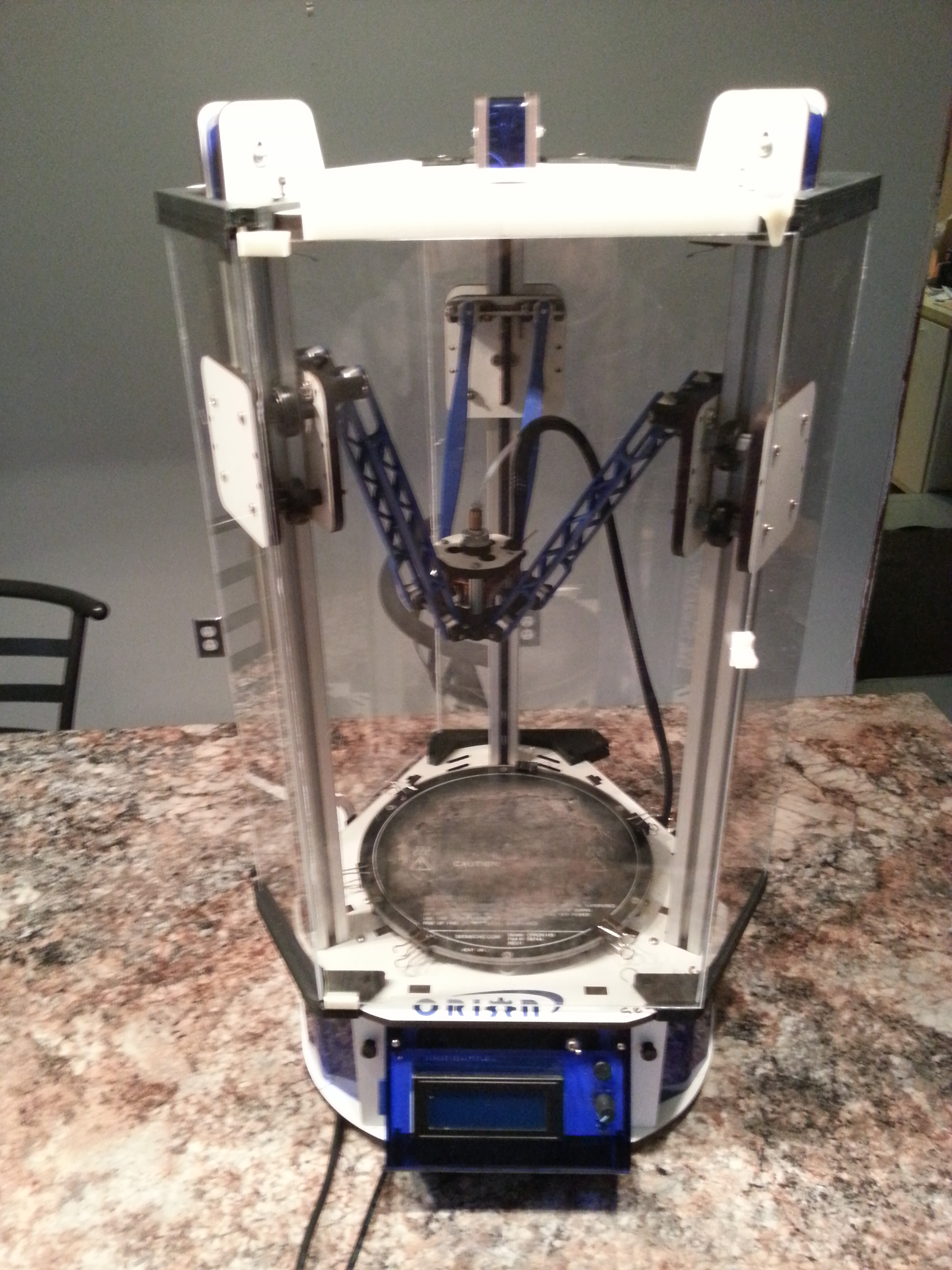

I finally finished my enclosure design for the Orion printer. it is very simple, clean and all can be printed on the Orion.
https://www.hightail.com/download/UlRTT ... bVVLSk5Vag
above is a link to the .stl files i created for this. will also get them posted on Thingaverse.
Plexiglas was purchased from Lowes, cut list is also attached for the sizes needed.

Looks great! Did you have to drill new holes in the Orion to fasten the brackets to?
RocketMagnet
Posts: 169
Re: Enclosure for Orion
Post by RocketMagnet »
That's really cool and like the fact you've used as many printed parts as possible. Especially like he flip up latch that's very neat.
Looks like it uses the original base screws at the bottom and in the video it looks like bolts at the top so must be drilled through?

the only holes drilled were on the top. the bottom are aligned with existing screws. going to add a thermometer and see what internal temps i am getting, then possibly add a light bulb to add some heat if needed.

put in a thermometer, it is holding at 90-91 degrees inside the enclosure for a 2 hour print. bed temp set at 80 and extruder set at 230. great results with my abs prints
