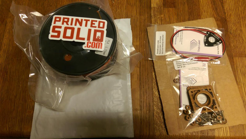

SO here is what I bought:
Rostock Max v2 kit (with height mod, will have 30" build height)
^Shipped today!^ Thanks JJ from support for making that go smoothly!
also bout a spare .5mm nozzle
Trick Laser
Stepper motor insulators (3 pack)
LED hot end heating indicator module
(Showed up today, super quick shipping!)

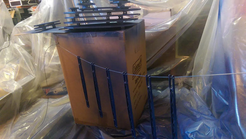

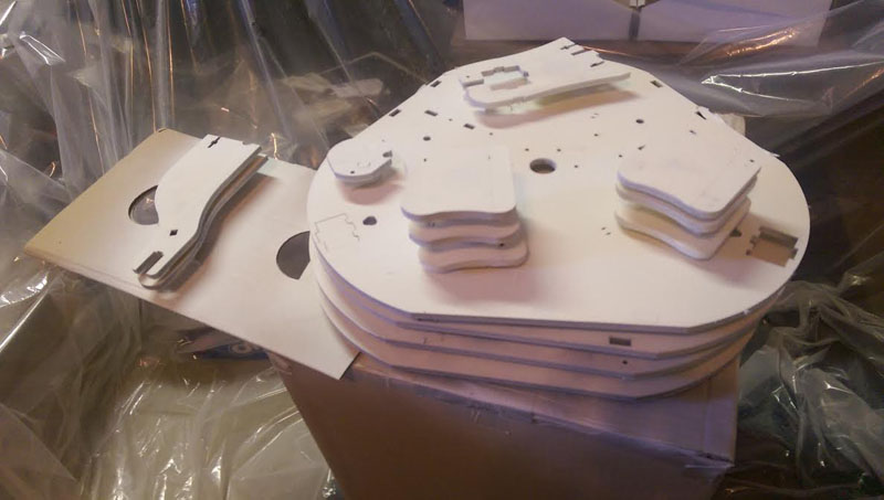

I plan to paint the edges metallic cobalt blue and maybe the pillars as well. (not painting the parts the wheels ride on)
Re: FrznTek's R Max v2
I would love to see some pictures after the paint job. Cobalt blue sounds great.
Painting the pillars does not sound like a good idea. You would need etching primer to get a good bond to the aluminum.
Best to have them anodized rather than painted.

Eaglezsoar wrote:I would love to see some pictures after the paint job. Cobalt blue sounds great.
Listen to Eagle, the paint on the Aluminum is an idea you will regret, even if it says its made for metal and you use primer. The surface is going to have the skates running up and down it and I guarantee if not right away some time in the near future that stuff will start flaking off and it will be a mess.
If you really want color on the beams, mask off where the rollers roll and paint the rest.

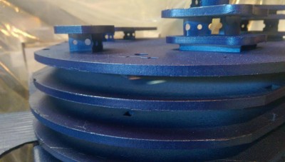

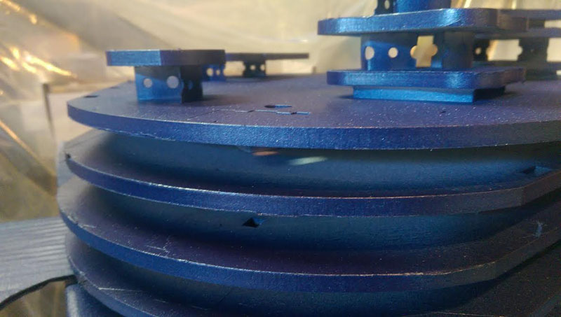

IT"S HERE!!!!! :D
Primer
Paint
close up of color

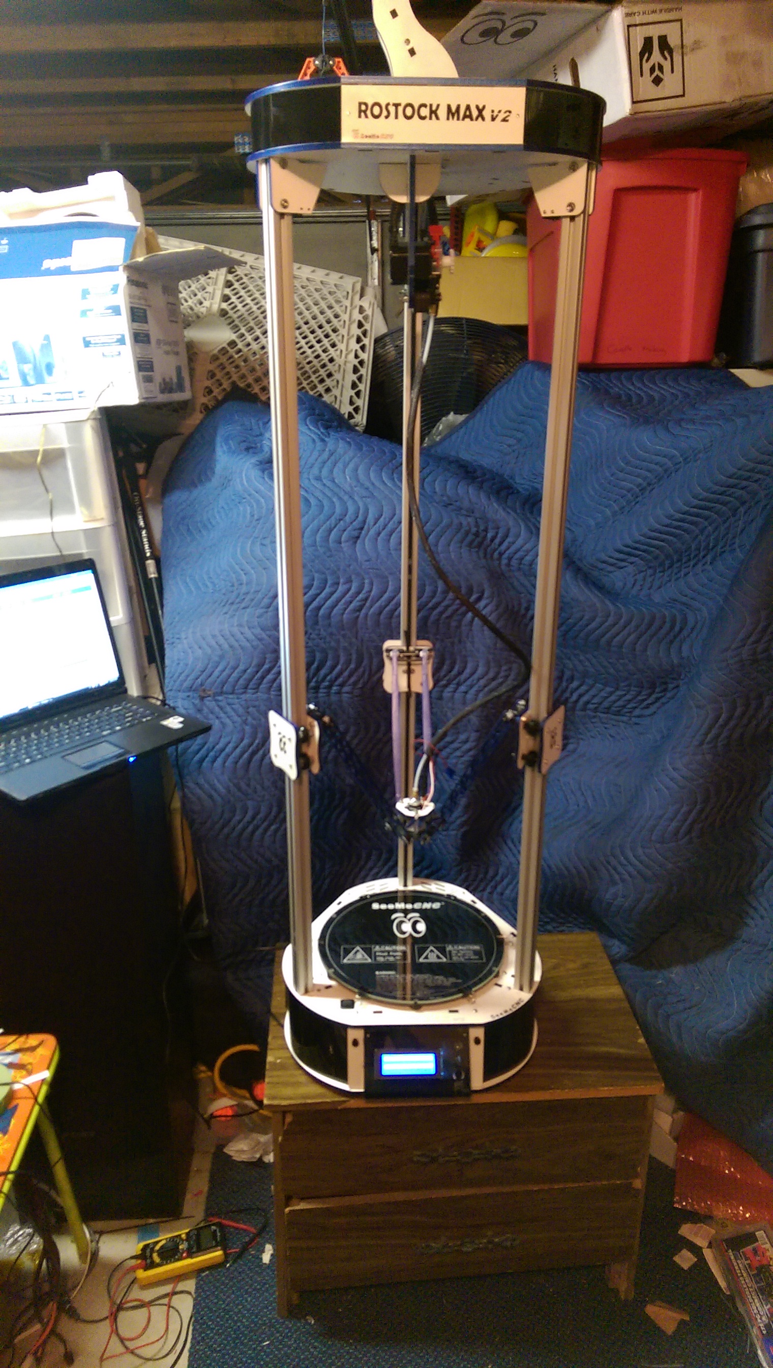

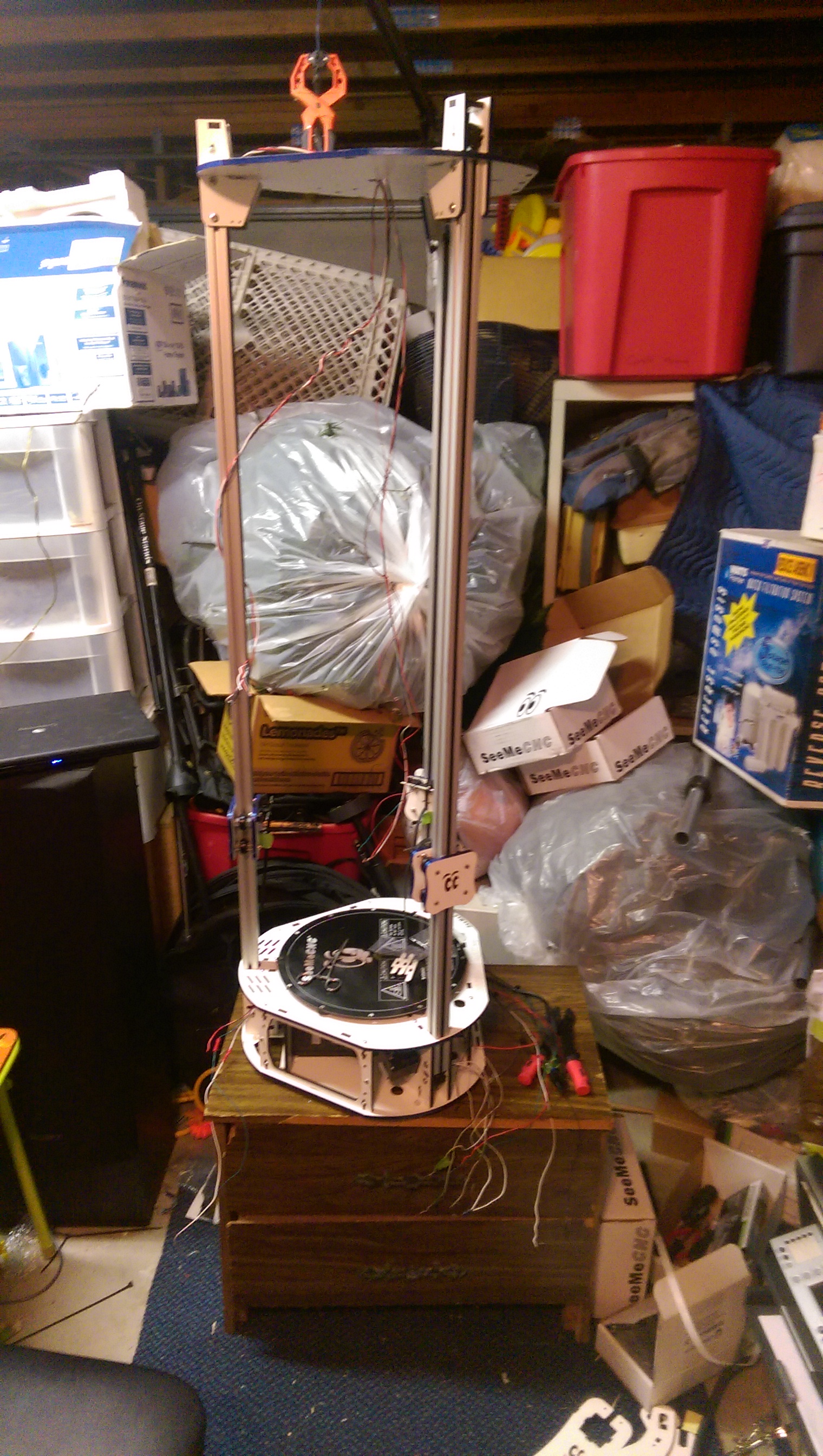

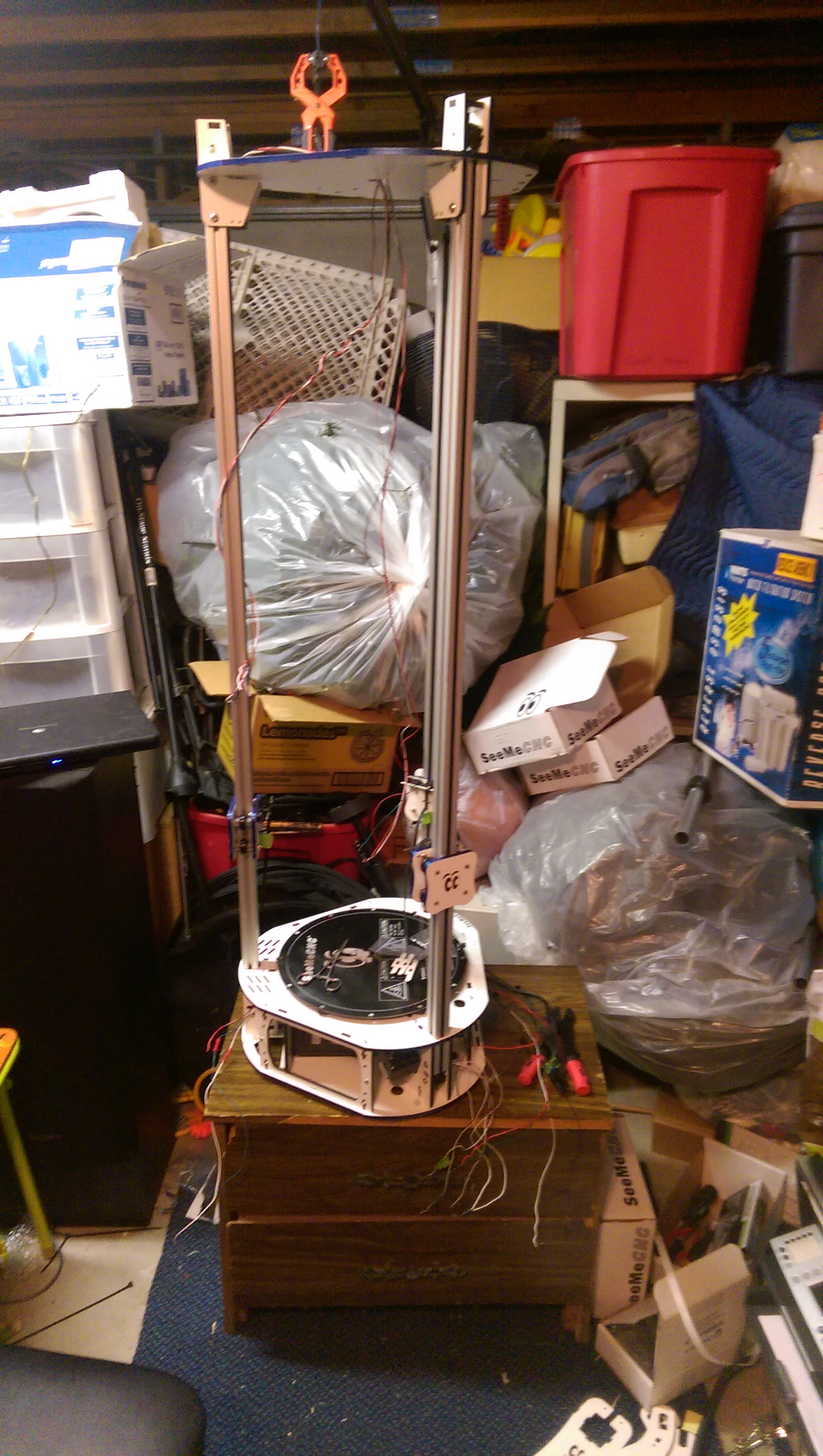

IT'S ALIVE.....kind of...
Well I got it built... but the y axis motor doesn't move. :(
I checked to make sure it was plugged in right, as well as the other way (just on the off chance it was wired back words...a guy can hope right!) but nothing.
the cold end motor doesnt seem to move either. I checked to make sure the wires were right and they are.
I even tried plugging it in to the Y axis and telling it to go to home and still no movement.
also in MatterControl my hot end is reporting 366c... what could cause that?

I see your build is another one of those tight space builds.
Try connecting the motors that do not move to the outputs that do create movement. That way you can diagnose if it is a rambo problem or motor+wire problem.

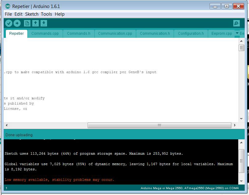

Thanks for the idea. They work , it must be a controller issue. I do remember the andrino software said something about low memory after I uploaded the firmware, and that it might cause glitches.

Try flashing the rambo again. I do not recall it complaining about memory.

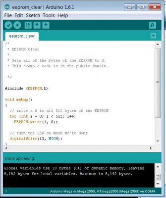

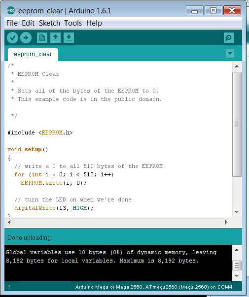

I tried again, here is what it says... (BTW, it had no effect)
JFettig
Posts: 821
Location: Minnesota
Post by JFettig »
Change your EEPROM clear from 512 to 4096 then run it, the memory is larger in this board than what that one is written for.
FrznTek
Posts: 28
Joined: Sun Feb 15, 2015 12:33 am
Location: Northern CA
Post by FrznTek »
just tried that, and it didn't help. :(
I did notice that the low memory message appears even when verifying the firmware's code.
Colburn
Posts: 14
Joined: Fri Mar 06, 2015 5:04 pm
Post by Colburn »
I got the same message with mine the other day when building it. So far it runs fine, but I haven't run a large file yet. Also, did you try hooking a multimeter to the board when you try and run the failing motors?
Posts: 5359
It's got nothing to do with the EEPROM clear size. The warning can be ignored.

They got back to me on Friday and had me test/look at some stuff.
I ran the clear eeprom, re-downloaded the firmware, made the motor change to "{155,155,155,165,0}" just like last time, and no change. (the Y axis still doesn't move when plugged in to the Y axis port.) the pins also look fine.
I plugged the Y motor into the second Z axis to see if all 3 would move and all three do indeed move, so it seems to me the Y port is the issue.
FrznTek, from the troubleshooting you have done, I must agree that the Y port on the Rambo is defective.
If not under warranty, you can send it to the manufacturer for repair.
I would pull out the Rambo and carefully inspect the circuitry for the Y axis port to make sure there is not a solder blob or
a break in one of the traces, however I doubt that you will find the problem. When you experience a loss of a port it is
usually one of the electronic components that fail.
Please let us know how you resolve this problem.
