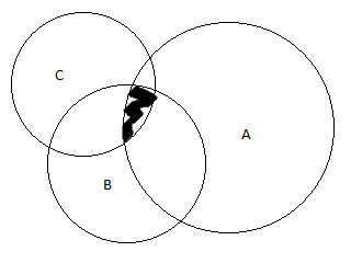

This idea is dead. I did a mockup with an FSR kitchen scale and a 1KG weight. The pressure gradient per millimeter was really, really tiny. Far too tiny to measure with FSRs in the 0.1-10KG range. Maybe for a much narrower-ranged FSR, it might be possible, with a 32-bit DAC. (Yeah, it would seriously take a lot.) And then vibrations from the steppers would hose it.
I also did some research into using microphones mounted where the FSRs would be. GPS-like trilateration could work. This would also require a microcontroller with a high-fidelity DAC, and would probably have to sample at 100KHz or better, because of how fast sound propagates through glass. I don't know if that's the best solution either.
I did the math to figure it out, and it's not too bad. Maybe something for another day. Measuring time-in-flight gives you distance. Distance gives you the radii of three circles. Find the circles' intersections - there will be six - then keep only the three intersections that are within all three circles. Their geometric center is the impact point.
- Circles intersecting.png (2.24 KiB) Viewed 13858 times

Actually, I don't think you would need DACs or ADCs for the sound based system. And actually the speed of sound in the material is probably not needed, either - as long as it is a constant.
[Oops, the speed of sound in a material changes depending on temperature, so you might need the bed to be an even temp throughout]
you would use little piezo circles as your three bed supports, they are also the 'microphones'.
you would also put a little vibrator on the print head (at first I was thinking another piezo, but a pager motor might do) Or maybe just the print head knocking into the build plate is good enough.
So, you start timing, 'tap' the print head into the build plate, wait long enough for the sound to propigate, then read out your timers (1 for each corner).
You have the timer stop when it's piezo crosses a threshold. now you just do math on the results.
You could have the piezo on the print head be the 'start timer' signal, or have it feed into a fourth timer which you use as the start timer signal.
You could also send a ping from one of the corner supports and time it's propagation to the others if you did care or need to know the speed of the sound.
