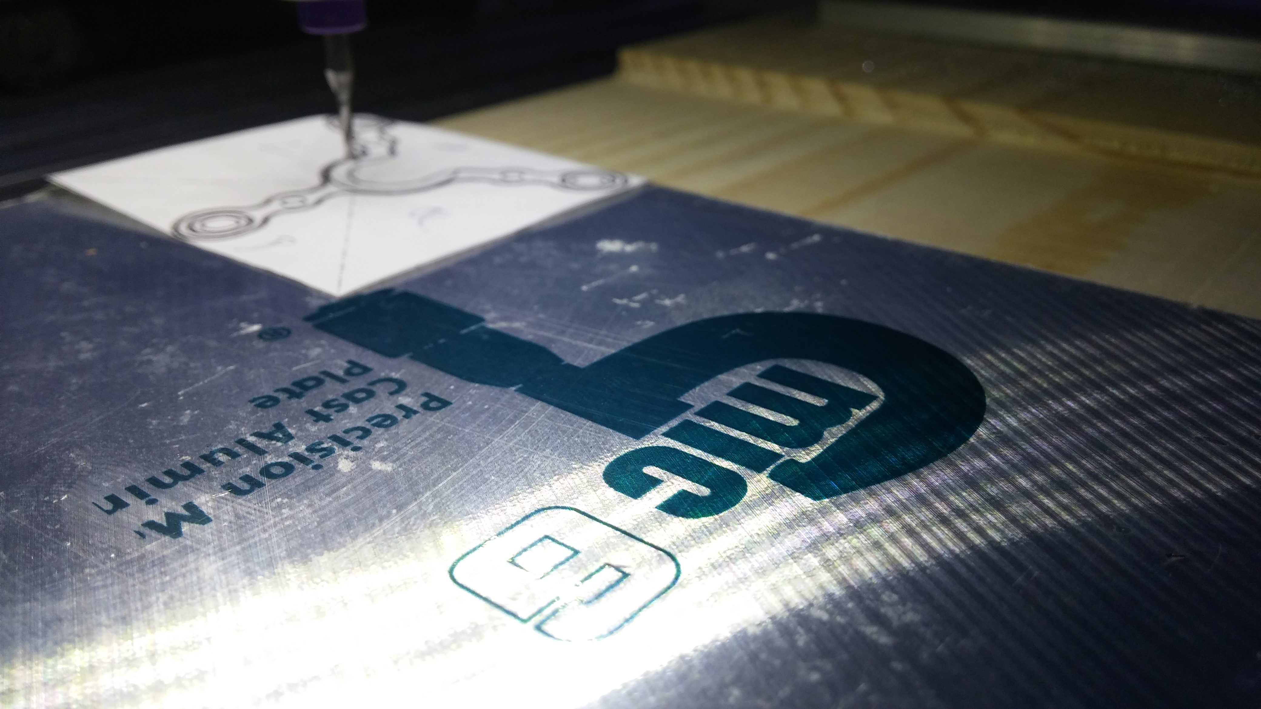

Moving forward all the mounts will be milled from 1/4" Mic 6 cast plate or Alca 5 cast plate. The first few going out will be Mic 6. Once that is used up I am switching to Alca 5 plate for the better anodizing response it has. Alca 5 is also slightly lighter than Mic 6 or standard 6061 for a given sample size. Both Mic 6 and Alca 5 are easier to work with on the mill I have found also. I got tired of warped 6061 stock from too many places and decided to go this way instead. The end price stays the same for you guys. The lock rings will stay 6061 alloy for the time being.

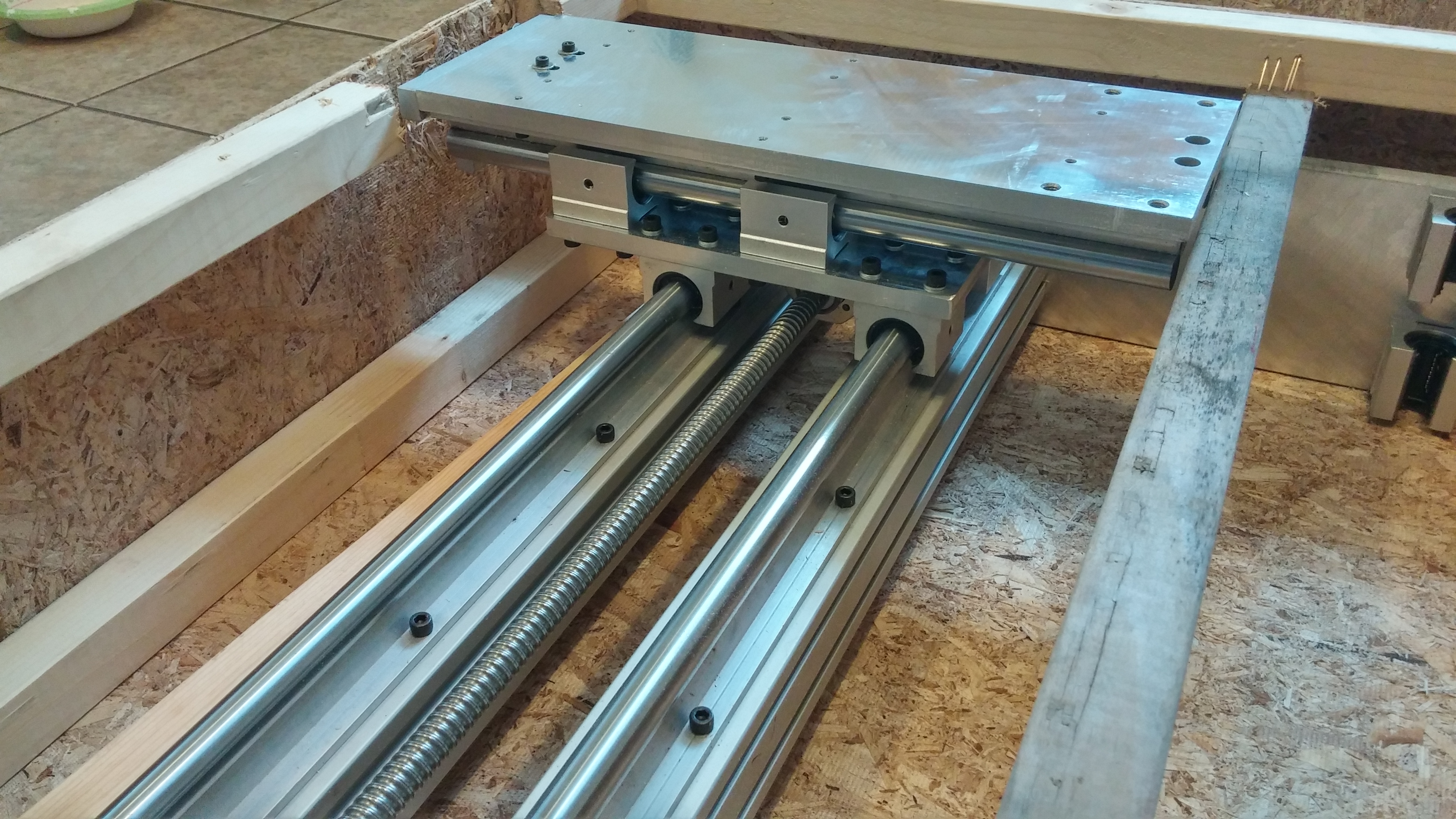

New Gantry for the mill. Nice beefy BALL SCREWS!

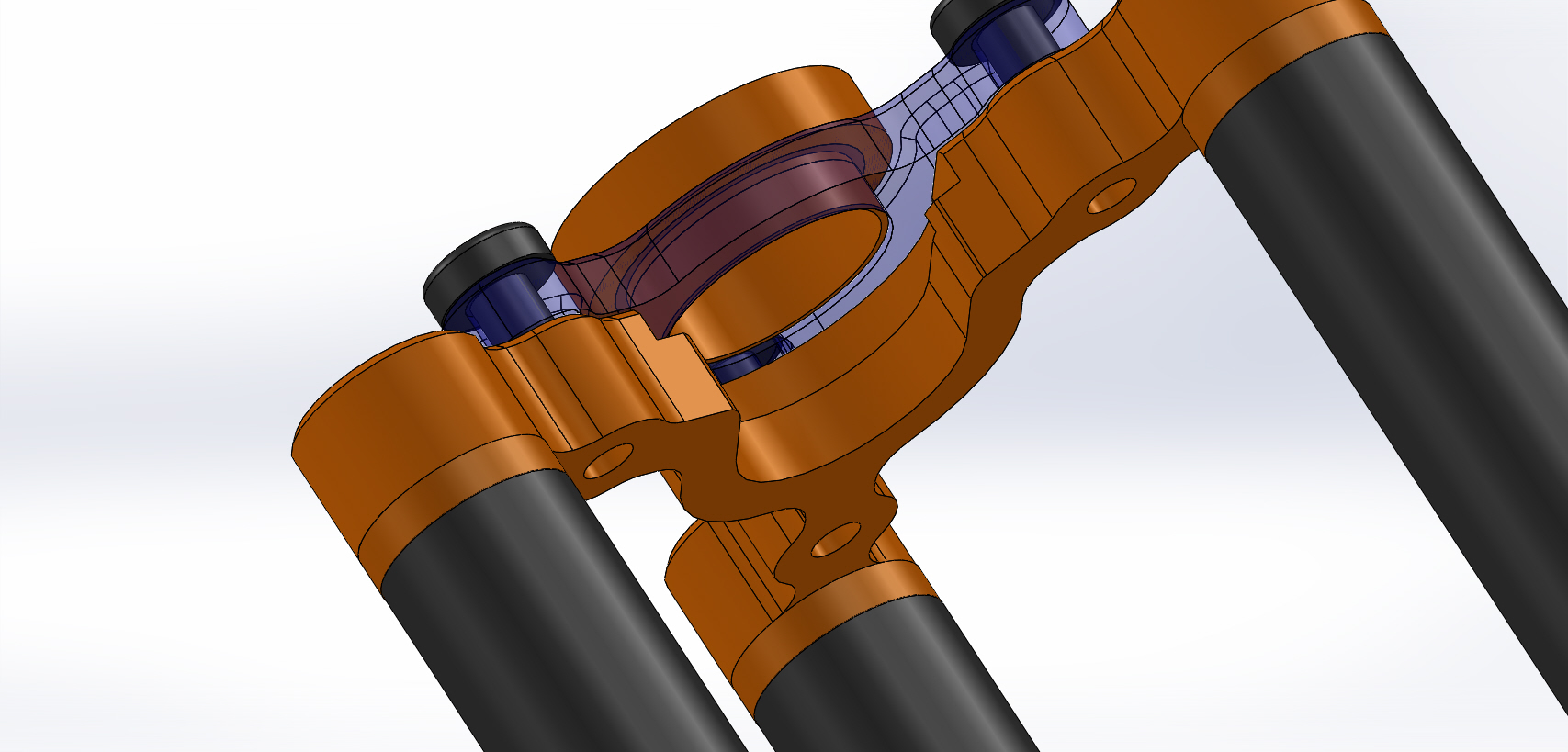

I worked up an insert for the SEEMECNC stock head also. I know some guys would be happy with the stock insert or printing one. But I figured having them match in anodized aluminum would be a nice touch. With the insert someone can buy the mount and insert and be able to mount J heads, E3d and the stock mount with one package. To upgrade from the stock to a j head or E3d, you just remove the insert and mount the new head and print away. Below is a rough render of the simple insert. I have not had time to model the SEEMECNC head in CAD yet so the render does lack that.

Thanks! My Alca 5 aluminum p!ate stock came in today. It is a 5083 alloy and will anodize much easier than the Mic 6 7000 alloy does. When I get home I will get your replacement mount milled and anodized. Looking forward to seeing how you like the new adjustments put in place for the J head mounts. Will you want the threaded lock ring like Gene is talking about for your J head mount?

Yes, a clamp plate with a M5 threaded hole, then the stock PTC fittings will work with a regular old j-head (http://www.hot-ends.com)
You could also try making a version with a 1/8-27 pipe tap thread, then the big black plastic PTC fittings from older E3D and others could be used.
And a clamp ring with a straight 13 mm dia. hole for use with E3D and Prometheus hot ends with integrated bowden tube collet.
That and the adapter piece for the SeeMe hot end you already mentioned, should cover mounting most any hot end out there.
When you sell these it wold be nice to include all the different clamp rings, I know many of us have various hot-ends laying around.
Offering one 'kit' would be simpler to inventory and easier for people to order.
Your extra cost including all the clamp rings as standard, probably would outweigh the reduced questions and inventory management. IMHO.
Just a thought.

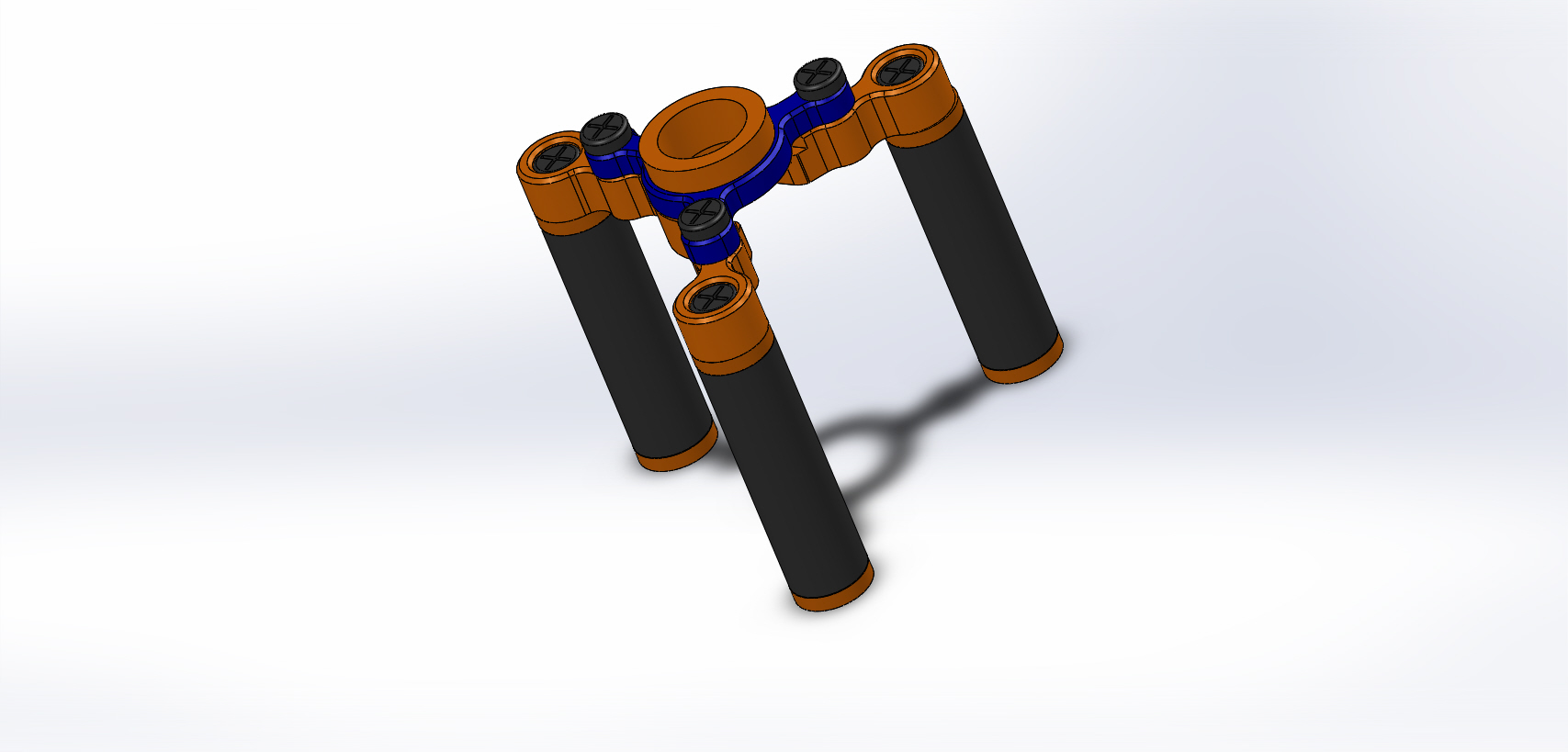

Are the top & bottom metal bits for the carbon stand-offs threaded?
tnx.
travelphotog
Posts: 398
Post by travelphotog »
geneb wrote:Are the top & bottom metal bits for the carbon stand-offs threaded?
tnx.
Yes for M3 bolts. idea is the carbon stand off stay bolted to the mount and only the 3 bottom screws fet undone to change mount/head. The mount, spacers and print head come off as a unit that way.
