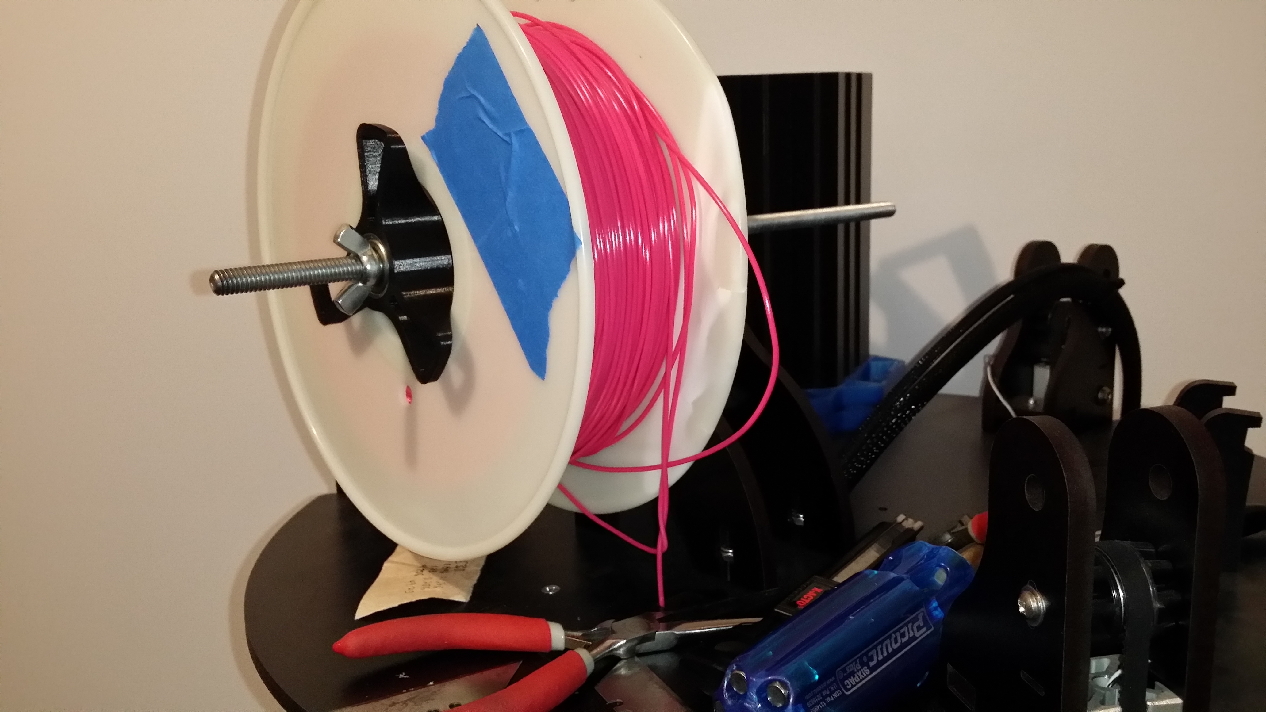

I took your photo and attempted to scale it to the E3D drawing and then superimposed the images. If I were to hazard a guess, I would say that your Bowden tube is not completely seated into the top of the heat break.
Re: Canola Convert
That plug is coming from much farther inside the hot end. Feels like it's near the heat break.
Re: Canola Convert
Make sure there aren't any burs. I had that problem on my V4 and it would occasional snag on PLA because the PLA retains the teeth marks from the extruder. Occasionally, these lined up with the bur and boom, it stopped extruding.
Re: Canola Convert
Maybe you drilled too far, thinning out the nozzle cone, and not enough heat can get to the nozzle tip? That would explain why the filament feeds great, but jams if it ever stops. If the filament easily passes through at first, it transmits heat to the tip area, but once it stops, the tip cools too much.
Take some fresh filament and run it through. Mark the filament right at the top of the hot end, and then pull it out. The measurement will tell you precisely where it's jamming.
Re: Canola Convert
I tried to be very methodical with the finish of the drilling. Used a magnifying eye piece to make sure I didn't end up with any burs as I know they can be a huge problem.mhackney wrote:Make sure there aren't any burs.
I used this (http://www.thingiverse.com/thing:197152) and tossed on my 40mm high CFM fan instead of the stock one. I also wrapped the heater block in kapton tape in order to try and keep the heat closed in for the tip in case 626Pilot is onto something.
I went from my plug (top filament) to the one on the bottom after the changes.
I tried moving the filament in and out, stopping, going slow... I couldn't get it to jam at all. I'm going to try a print and see how it goes.

Thanks for the tip! I have some crappy PLA that kept jamming in both my E3D hotends. Rather that toss it out, the canola worked great.
What was happening was that the filament above the heat break would soften. This would expand slightly and then stick. The oil keeps it from sticking.

nitewatchman wrote:I made a number of modifications to my printer over the holidays. One of these was the addition of a E3D-V6 Hot End.
For whatever reason I was having a lot of trouble with the Hot End jamming and not feeding smoothly. Out of frustration I remember a discussion about lubing the filament with Canola Oil to help with these issues.
Well I tried it. Every time a filament change occurs I dip the end in the Canola Oil. Lo and behold no more jams, no more rough feeding with HIPS, PLA or ABS.
Likely the "canola cure" is wishful thinking but I am comfortable with the solution to the problem (it is logical) and it was much cleaner and easier than killing a chicken on top of the printer.
