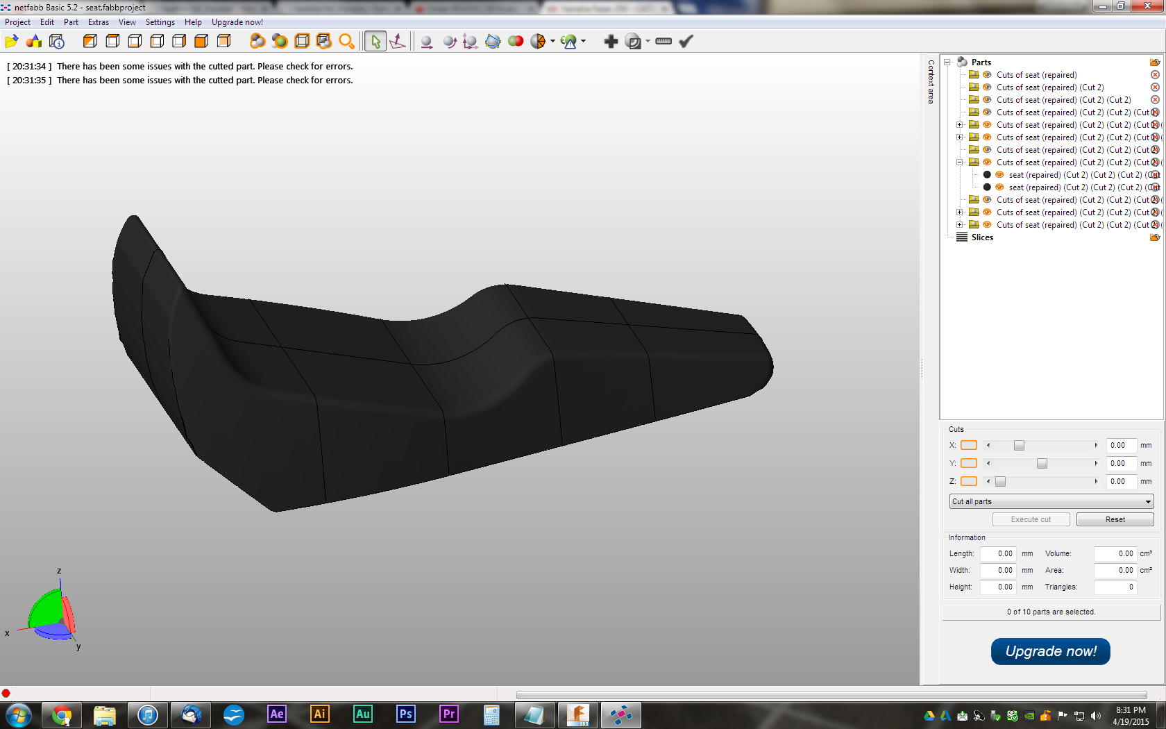

As summer is approaching i have been toying with the idea of 3d printing a motorcycle seat for myself.
The reason is that i want a completely mesh seat. In the summer my arse is soaked by sweat.
The seat is approximately 45cm long. And only secured from both ends.
Obviously it will be a multi part print. I was thinking of first separating the seat design in two parts horizontally. And then printing it in 15-20cm slices. All stuck together with acetone with two threaded rods going through securing everything on the bottom.
Any ideas recommendations?

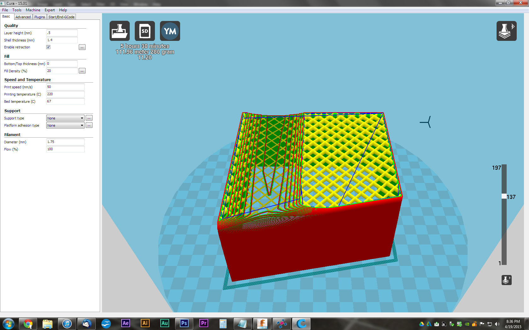

Model the seat, or find a model. Cut it up, print it with the bottom down with no top and bottom layers, and use the infill to make the "mesh" pattern. Glue the pieces together and/or make a bracket to bolt them together.
I made up an example, and discovered a limitation to this technique. If there is too much of a contour, the perimeter lines will completely "fill in" the open mesh, as is seen in the photos.
