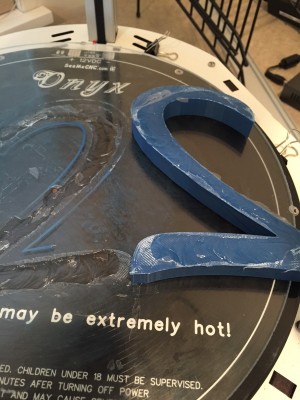

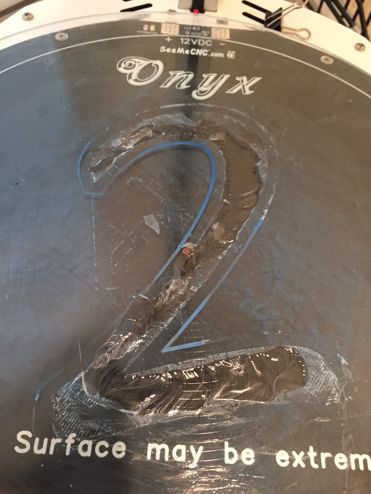

Hi Guys/Gals,
I printed a test "number 2" last night and it held on to the bed so tight I gave up and went to bed to allow the machine to cool down. Well this morning the print was ready to come off, but it took some glass with it! LOL I've never had this happen before. Kind of funny, but now the print has dangerous glass attached to the back side.
This has to do with the ABS slurry I had on the glass. That stuff works well! Plus I just readjusted the print head above the glass. Maybe I made it too close or something.
Oh well. Always learning....

Re: Glass Adhesion FIXED
Hah no lifting corners there!
Been there, done that, just not on quite such an epic scale.
Flip the glass to keep you going, dilute your slurry a little and order another plate
A little frustrating, isn't it?
Yep, happened to me as well. I recommend finding mhackney's PEI thread and doing that mod. I get perfect adhesion practically every time without fussing with glue or such (and no chance of glass breakage either). Definitely worth it!
It's amazing the glass doesn't shatter when that happens.
haha, I didn't even think of flipping it over. Good tip.. I might as well buy a couple and have them "in stock".
I guess this is what you call 'dialing it in'.. lol Before it didn't stick, and now it's too much. oh well..
