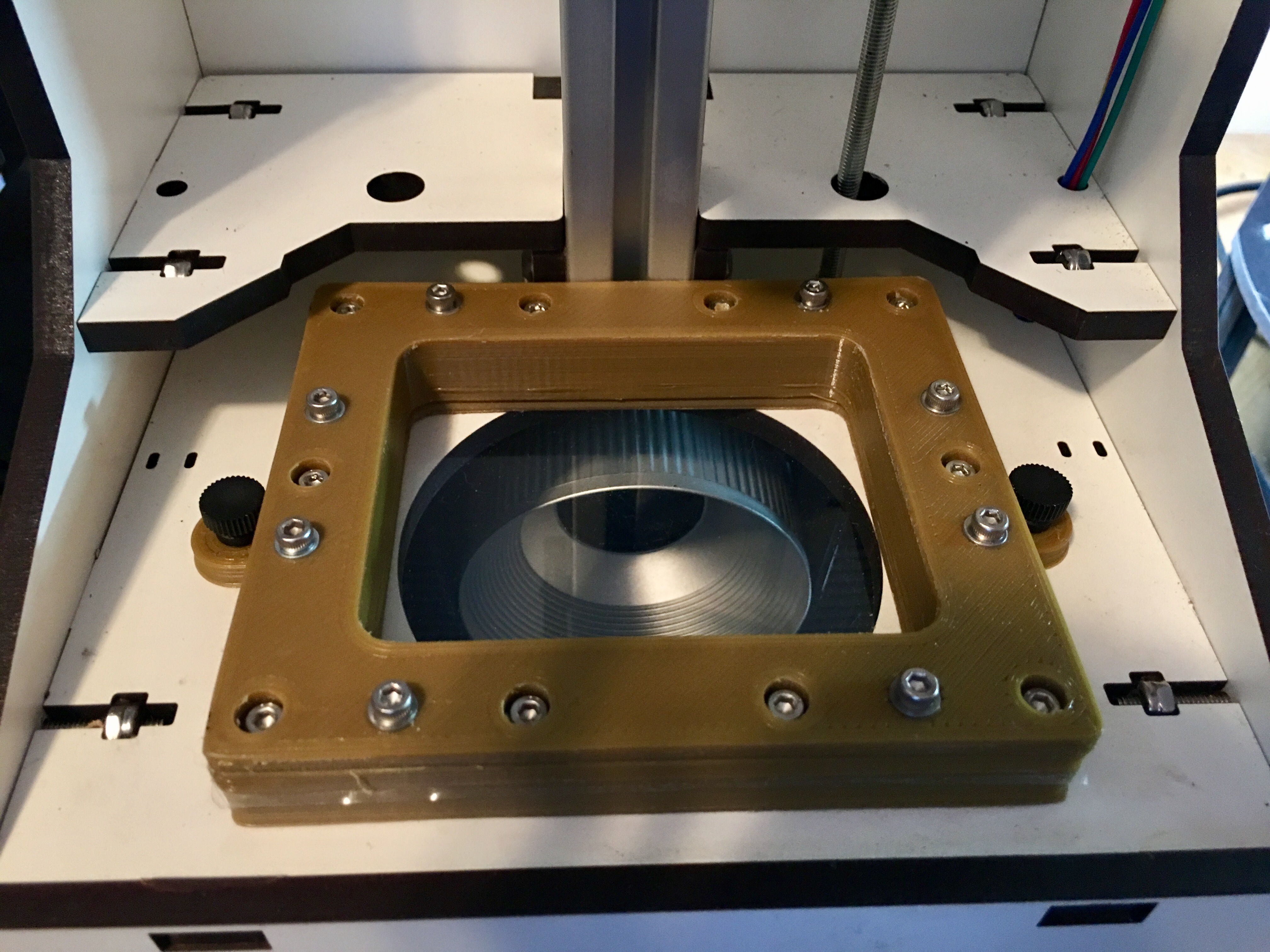

Along with the above, I needed to do something about a new vat. I had started to build a flex vat 18 months ago with a new built in leveling build plate. I finished that off today. Here's the new 3 part flex vat with .005" FEP film. Custom made to fit the DropLit V1 beta I have. I can cut the base plate to rectangular to reclaim the extra print surface too.

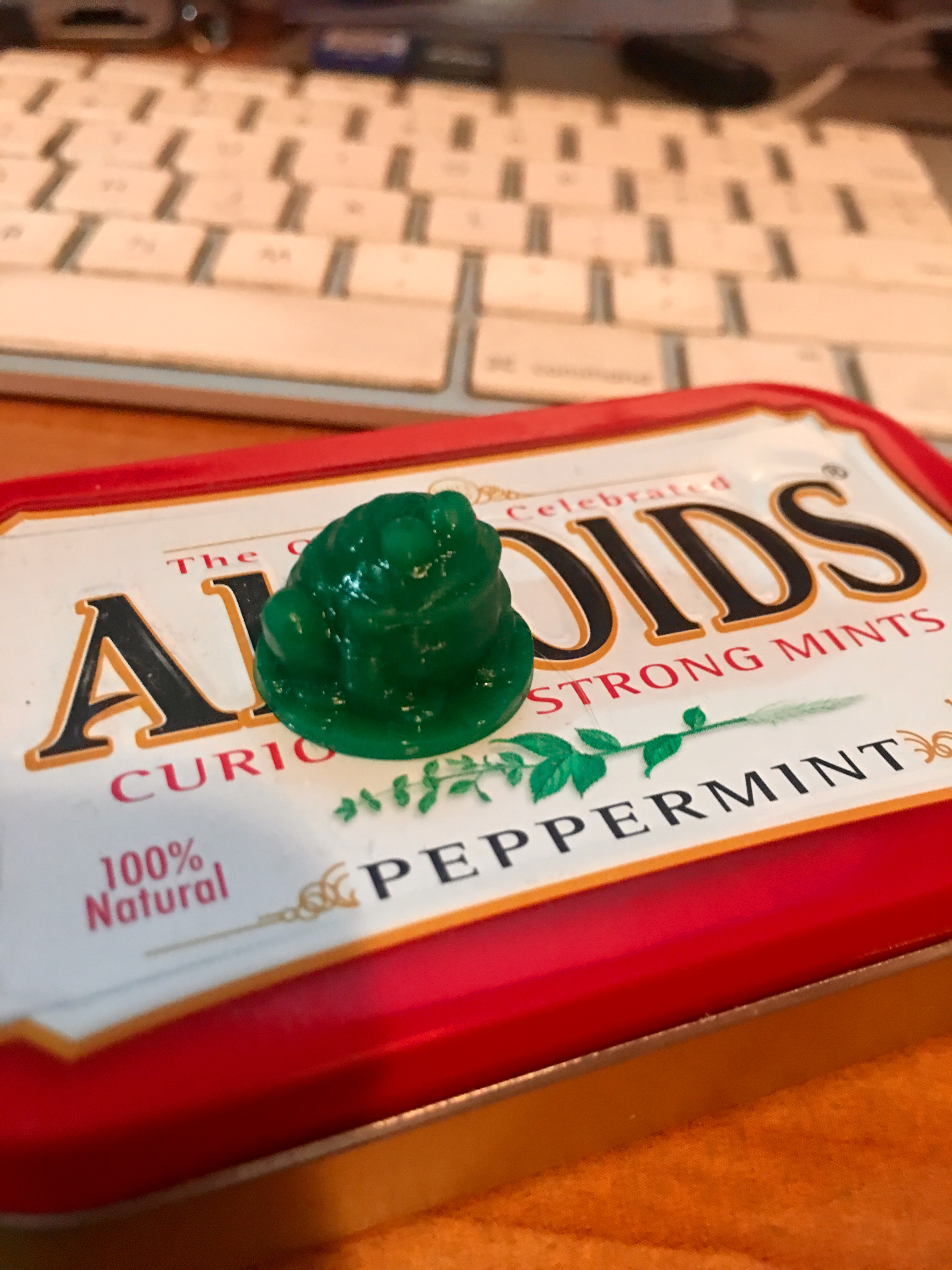

Ha, no but thanks! I think we have it sorted. The nanoDLP slicer was generating WAAAY too many slices. 425 slices at .1um. That is 42.5mm tall. And guess what, that's how tall the part came out. I resliced and now it is only 128 layers. Which is right where it should be.
Re: mhackney's Beta DropLit build
DropLit 3D printer and projector: $1200
Hours of pain and agony: 40
Cute printed toad: priceless!
Lessons learned with nanoDLP:
1) don't trust the slice after changing anything in the Printer Profile. For some reason, it doesn't pick up the new parameters and there is apparently no way to force re slicing, you have to re upload your model and reslice.
2) prepare the projector manually first and have it project a black slide. Otherwise, the projector's logo (at least with my Acer) burns in on the first few layers
I would still like to figure out how to automate the projector startup and shutdown. When this print was complete, I do have ending gcode to lift the part from the vat. But I was attending a wake tonight so that happened while I was away. When I came home the toad was fine but I now have "Acer" and "HDMI detected" plastic burned in my vat!
