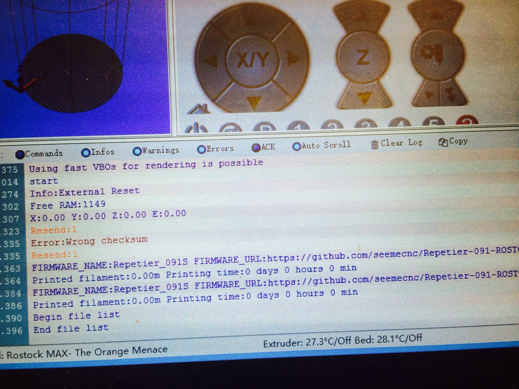

Hey Guys,
We have upgraded firmware to 0.92.3, the PID for heat rod is good but not for the heat bed. The temperature refuses to increase.
Every time we restart printer, there will be "resend" in yellow like showed in picture, can anyone help?
Heat bed does not go PID

If you don't mind, just use one post for all your upgrade issues. I'm counting 6 topics you started on the first page of this section, just makes it hard to work through the issues.
Are you positive you cleared the firmware before installing 92.3? I'm not sure why the command window is referencing 91S
