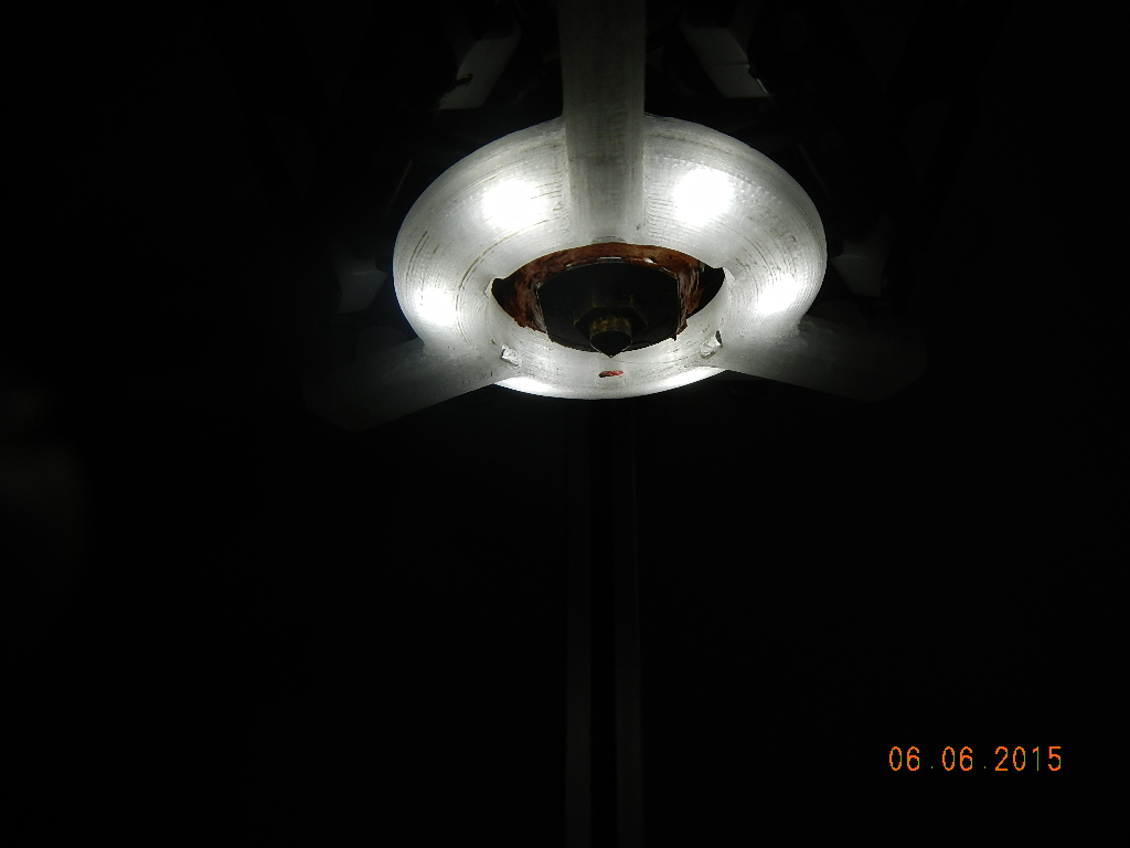

Just to let you know I almost have the one to mount the tricklaser, also maybe one for three fans, print transparent ABS
Jack
Draw-Tech

Here it is. I believe that if the front fan clears others will be fine. I printed the first one in clear ABS, very bright, maybe white will give a softer light.bot wrote:You gonna share that 3 fan design? I doubt it has enough clearance for my setup, but it's a cool design anyway.
Draw-Tech

This was designed for the tricklaser led light. I created a cover to fit, did not print it yet, but should be fine. Check out the Tricklaser3D-Print wrote:Does the "cap" previously designed work for this three fan design or do you need the LED ring to seal the radial fan housing.

Thank you. I will look into the LED's and the clear ABS you used with it looks awesome.
Re: Radial Layer Cooling Housing MAX2
Hi 3d-Print
Try any light color, I find the clear gives a real nice white, but white ABS might give it an incandescent type glow, easier on the eyes. Yellow or green might also work ok
Draw-Tech
Draw-Tech

LOVE the way the light ring glows and diffuses the light.
Having 3 fans is wonderful.
Great work.
