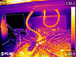

Just messing around with a FLIR E6.
If you want anything specific, just let me know. I'm working on getting video of the heat up.
Bed set to 60C. The outer rings overshoot a bit while the center plays catch up. This was taken without the glass on.
[img]http://i482.photobucket.com/albums/rr18 ... IR0003.jpg[/img]
[img]http://i482.photobucket.com/albums/rr18 ... IR0008.jpg[/img]
The stock wiring from the controller to the heated bed is not up to par for the job.
[img]http://i482.photobucket.com/albums/rr18 ... IR0006.jpg[/img]
[img]http://i482.photobucket.com/albums/rr18 ... IR0007.jpg[/img]

Very interesting - are you sure you're able to draw the conclusion that hot wires = insufficient gauge? Maybe the wires are hot because they're connected to something hot?
KAS
Posts: 1157
Re: Thermal images of the Rostock Max v2
Post by KAS »
That's a good point, ill try to get another picture after this print. I'll let everything cool down and try to catch it heating up. Looking over my test video, it looks like the wires get hot from the controller side first; It's just not that clear to be definitive.
update:

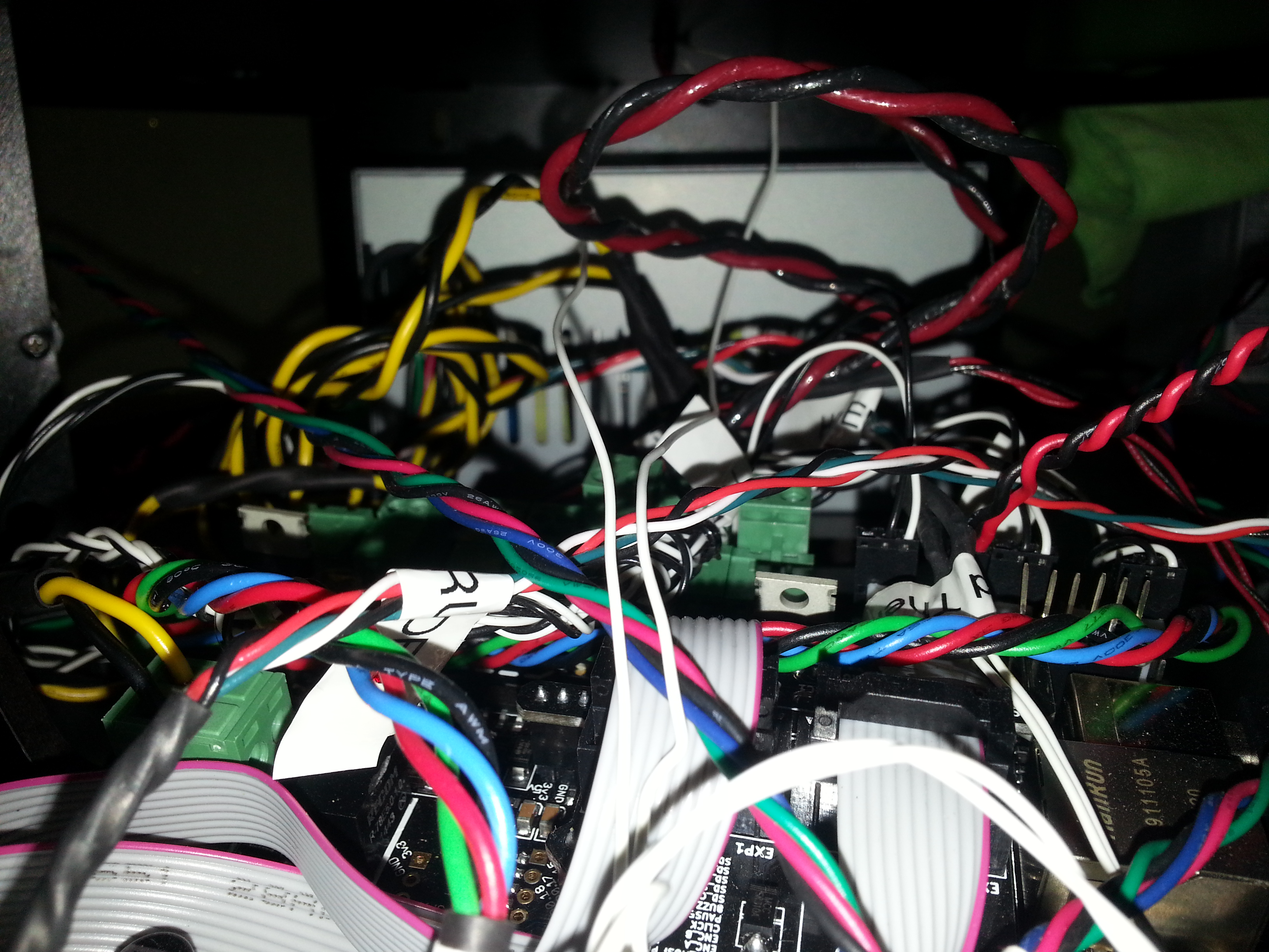

It's been printing a while and temp saturated. Although you can see the two power wires going up to the hole. The middle is currently cooler than both ends. Just not sure if the connector side is pulling heat from the board.
[img]http://i482.photobucket.com/albums/rr18 ... IR0016.jpg[/img]
Smoothieboard:
[img]http://i482.photobucket.com/albums/rr18 ... IR0015.jpg[/img]

Okay, no doubt about it at all. The power wires to the bed light up well before the bed even hits 40c.
[img]http://i482.photobucket.com/albums/rr18 ... IR0022.jpg[/img]
[img]http://i482.photobucket.com/albums/rr18 ... IR0020.jpg[/img]
[img]http://i482.photobucket.com/albums/rr18 ... IR0021.jpg[/img]

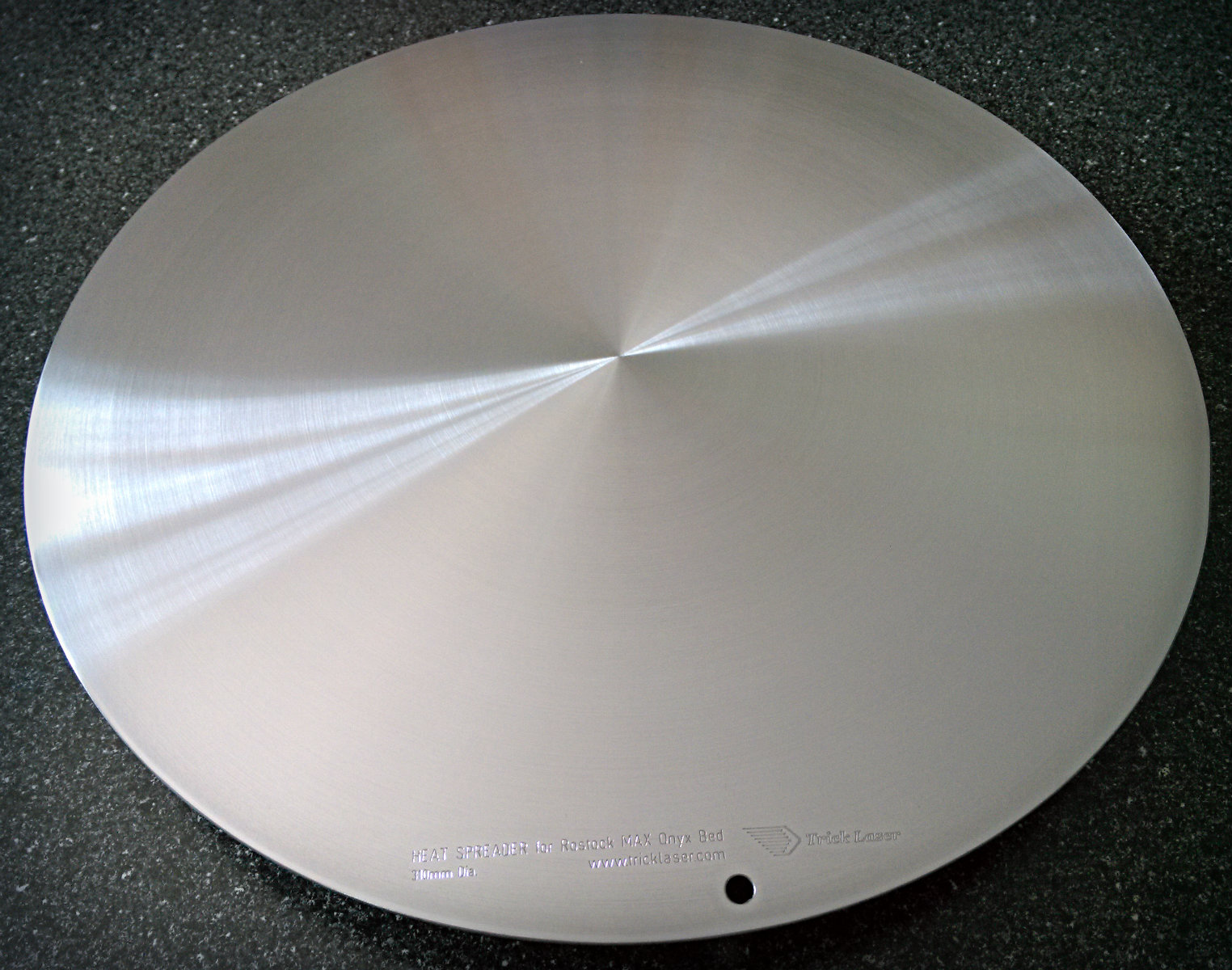

Another thing I would like to see is thermal image of bed with aluminum heat spreader disk in place.
My experience has been the bed temperature is within 2-3 c with the plate and up to 15 c difference from center to edges without.
This is with 1/16" thick 5052 aluminum.
It does not have enough mass to slow down heat up, actually it heats up faster.
The heat spreader plate is something I have been meaning to cut up a small batch to see if anybody would be interested, but have not had the time yet.
I run a heat spreader on all my machines and have cut a few for others. People report that they work well.

I disagree about the stock wiring not being up to par, even if it's not up to your expectations. For the load involved, the wire is staying within a safe temperature in operation. Wire temperatures in the neighborhood of 50C aren't a problem...that's still cold enough to touch and hold with bare fingers.
18 AWG copper is about 6.5 Ω per 1000 feet at 25C. Temperature is a factor, so at 50C it's 7.1 Ω per 1000 feet. Either way, that's a very small resistance for the actual length involved in this case. Still you're putting a fair amount of current though it, Power = Current squared times Resistance, so even that tiny number means you're dropping a couple watts of heat into the two wires. Some wire heat above the ambient temperature of the electronics box is to be expected.
16 AWG is 4.1 Ω and 14 AWG is 2.6 Ω, per 1000 feet at 25C. So yes, upping the wire side will reduce the resistance and result in less heat generated in the wires. So it's a fine upgrade if you want to do it. It's just not required.

Eric wrote:I disagree about the stock wiring not being up to par, even if it's not up to your expectations. For the load involved, the wire is staying within a safe temperature in operation. Wire temperatures in the neighborhood of 50C aren't a problem...that's still cold enough to touch and hold with bare fingers.
I'm not a electronics guy by any means. I just saw the wires heat up and didn't think that was optimal. Also, they get much hotter than 50c, that's just the hottest spot when I took that picture.
I just soldered 14awg 600v rated wire and they light up like a toaster as-well. Since I only measured ambient to 80c once on each wire size, I'd take these results with a grain of salt.
I'll have to agree with Eric and others, that no obvious benefit was made by changing 18awg to 14awg.

I was surprised that it took longer to heat-up. Possible that the 14awg was acting as a heat sink?
I'll let everything cool down then record the thermal video. Then I'll be taking the 14awg off and putting something a little more flexible.(that's a bit to stiff to work with)

You're looking at the circuit as a whole. The previous poster was looking at elements of a series circuit. If we consider the Rambo terminals as a black-box 12V source, the circuit you're thinking of containing just the bed could also be construed as containing as many as six additional resistive circuit elements, wired in series (neglecting for the moment the parallel LED/resistor circuit).
The solder joints, wires, and screw terminal connections all have resistances associated with them and they will dissipate some of the voltage supplied by that 12V source, converting it to heat and lowering the voltage dissipated in the bed. The current flowing through this series circuit will reflect 12V against the sum of the resistances and the voltage and power dissipated in each circuit element will be based on the proportion of the total resistance each circuit element represents.

1) the wires are heating more than I would like. any power lost in the wires is power not heating the bed. Plus it will contribute to heating the connectors. I am finally upgrading to that 750W corsair today, I am going to upgrade those wires while I am at it.
2) The smoothie board was getting hot. while it looks all within spec, as an EE I try to avoid having that much heat on my boards, as it reduces reliability and life. A fan or directing more air over the smoothieboard is the solution.
Gee, we have this nice 3d printer, it could print some great ductwork to put the moving air where it is most needed.
3) I would like to see what the steppers (x,y,z, and extruders) look like when printing a long job.
4) I would like to see what the print head looks like when printing. Probably get the object we are printing in the same picture, that might be interesting too. What is the Max temp that the FLIR camera can distinguish?

That ball of hot mess is the 14awg solid wire from the smoothieboard to the Onyx bed. Also two separate power supply wires from the stock supply. The 14awg is to hard to work with so I'm going to try stranded 16awg next.
I'll also get the steppers( .9 degree installed and they appear to run cooler than stock), Extruder(stock), Hotend(prometheus), Onyx with & without glass, carbon fiber heat spreader and soon an aluminium spreader, also printing stuff.

edit: image of the bed sitting at 80c for about 20min everything inside is saturated with heat. It's hard to tell what's really happening because the FLIR automatically calibrates the color scale. While the wires look cooler, it's still in the upper ranges closer to the bed temp.
The transistor that controls the bed on the smoothieboard gets up to 80-90c. Is it normal to not put a heat-sink on something like that?

The outside ring of your bed doesn't get that hot, so the edge-on view is a poor indicator of bed temperature as well.
When you stick your hand in the video, it gives a nice thermal reference point. Surface temperature of your hand should be about 30-35C.
On Mosfets you'd need to check the datasheet for that part, but the upper temperature is usually over 120C. That said, if it's a through-hole part, heat sinks are easy to add, and putting one on the bed output can't hurt. Active cooling (fan moving air across board) is the other way to improve the situation.

Working with Brian from Trick Laser trying to capture the thermal signature of his new Aluminium Heat Spreader.
Each video was heated from room temp to 70c. When the bed thermistor bounced off 70c a few times, I turned the power off to the bed. ( I waved my hand across the screen when the power was cut).
I ended the video when the thermistor showed 50c.
ONYX PCB Heated Bed Only, No Glass
[youtube]http://www.youtube.com/watch?v=dOiNospa6oo[/youtube]
ONYX PCB Heated Bed, Borosilicate Glass.
[youtube]http://www.youtube.com/watch?v=Snr-Aug-vdI[/youtube]
Onyx PCB with Trick Laser Aluminium Heat Spreader No Glass
[youtube]http://www.youtube.com/watch?v=gLeh1selqDE[/youtube]
Onyx PCB Trick Laser Heat Spreader With Glass
[youtube]http://www.youtube.com/watch?v=UfjnDrnPUpI[/youtube]
