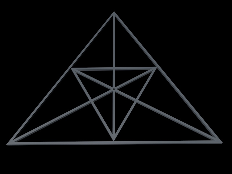

You could put a pen on the effector and make it draw lines, rectangles and circles on paper paced on to the bed.
