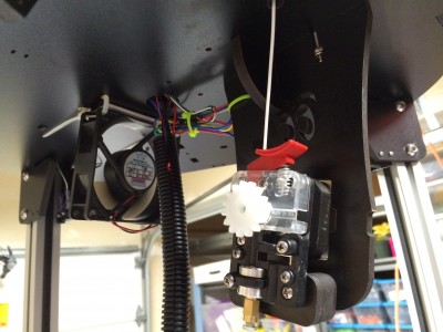

I'm also having problems with PLA stringing. Installing an extruder fan won't help that problem - I've got one installed for a different reason.
I was having problems with PLA getting too warm at the EZStruder and fouling around the hobbed gear. The fix was to install a 12V fan so it blows air across the EZStruder motor. Nothing fancy here - I used a couple of Zip ties to suspend it from a few of the unused holes in the MAX top cover and it solved that problem right away. So I don't believe I need heatsinks in this case. I did patch this fan into the PEEK wiring with no ill effects so far, and a couple of people here on the Forum said that the available power for the PEEK fan should be able to handle this extra load.
This doesn't fix the stringing problem, but does seem like a good idea if you're using PLA.

Thanks very much for the reply and picture. In the end this is probably what I'll end up doing. However I do think this fan will help avoid stringing. The reasoning is this: In my experience, long and fast retractions heat the stepper motor much more than short/slow retractions. When I do long and fast retractions, the extruder motor heats so much that the PLA gets chewed up in the extruder/hobbed gear area. When I do slow and short retractions, I never experience this issue. So having this fan installed would allow my to do long/fast retractions, and long retractions in my experience has been the most important factor in avoiding strings. And going fast on retractions also makes the prints finish quicker.
I need to try a new roll of PLA first though. I suspect it may be the moisture on the filament that is killing me. If the new roll works, I'll probably get vacuum bags to store the filament.
