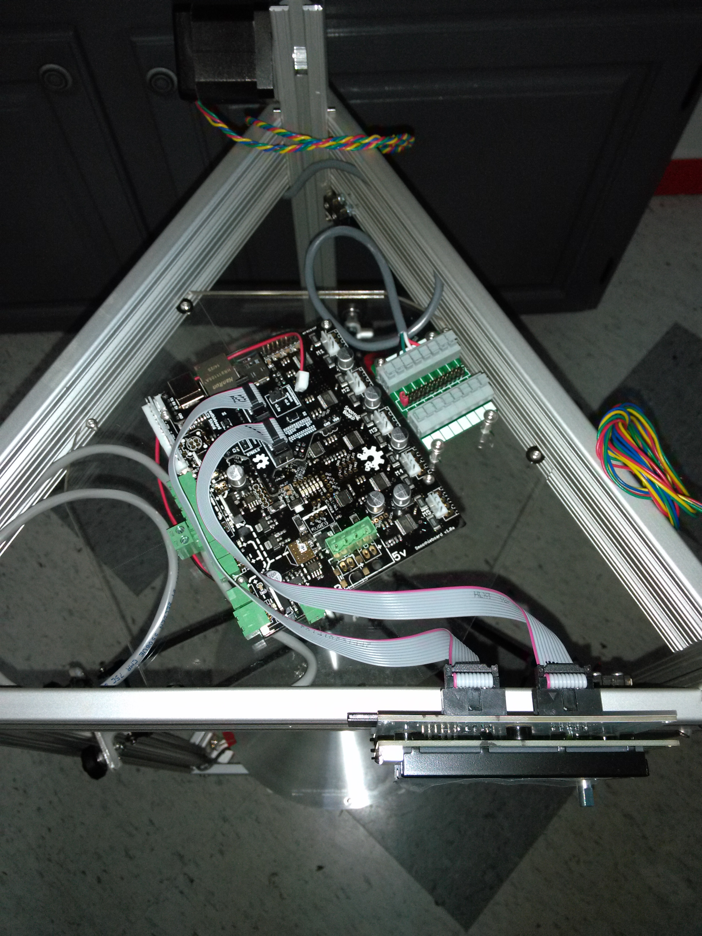

I case anybody is interested here are files for the electronics mounting plate for my "upside down" build.
Laser cut from 1/4" thick acrylic. Install after the frame is built by turning plate to "lock" it into slots of frame sides.
For Smoothie Board electronics. Also file for Onyx HPB mounting plate. Made from 2 layers of laser cut 1/4" melamine wood sandwiched together with 4-40 flat head screws and t-nuts.
The lower plate fits snugly into the triangle of frame sides for location.
The whole assembly is held down with 6 magnets pressed into frame and 6 slugs of steel in the melamine.
Since it is held down by magnets I wonder if FSR's could be sandwiched between frame and HPB melamine plate?
You could also thread holes in frame and hold it down with screws.

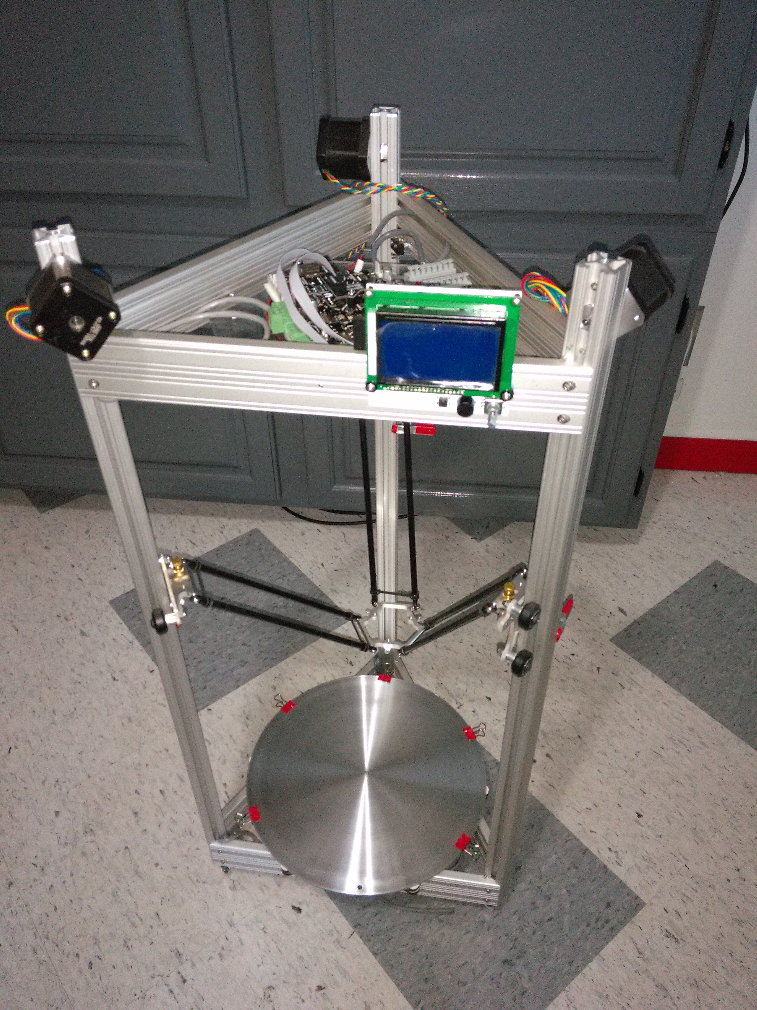

I ordered the Trick Laser all-aluminum platform and carriage mounts, thinking that they might help improve my positional accuracy. Previously, when depth-mapping the print surface, I got an energy of ~0.06 with my MAX Metal. That means that the average difference in height between the center and all tested points was around 60 microns.
Here are the kinematics with the all-aluminum parts (zero injection molded stuff from the old Rostock MAX):
Some of these figures are telling:
Radius offsets - RMax v1: 0, 0.69084, 0.69084 / MAX Metal: 0, 0.04, 0.04
Angle offsets - RMax v1: 0.04096, -0.06179, -0.54572 / MAX Metal: -0.087, 0.121, -0.041
This represents a significant improvement! The angle offsets show a substantial average improvement, and the radius offsets are so tight that the 40 microns could be partially due to probe repeatability.
I also noticed that the energy measurement (average Z error of all points vs. center) went from 0.062 (or so) to 0.042 when I installed the all-metal platform kit:
I never saw an energy this low (ideal energy is 0) before installing that kit. My guess is that it's down to the U-joint mounts. If you use TL arms with SeeMeCNC's injection-molded U-joint yokes and effector platform, you have to do all kinds of fiddly stuff with washers and nuts to get everything aligned just right (or close to it). The CNC-cut aluminum parts in Brian's kit require no such thing. Everything screws together directly and self-aligns, so there is no opportunity for the builder (me) to introduce additional error. I like that!!!
The improvement I see with Brian's kit (just the platform and U-joint yokes that go on the carriages) is about 20 microns on this particular machine. That might not seem like a lot, but positional accuracy is VERY important to me.
Another important thing: Time and effort. I will be using this kit with all of the MAX Metal printers I will build in the future (1 down, 2 to go). I like the idea of not having to fiddle with those axles, and having to figure out how to get the alignment just so. To my mind, this is "how things should be." To me, self-aligning construction is WAY better.
