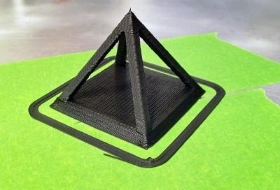

This was my very first real print last night, I'm pretty damned happy with it really.
I think my board is done now man, I managed a few nice prints with my borrowed hot end last night and went to fire it up this morning and I simply get -20 for the extruder and -50 for the bed, other times I get some kind of bizzare checksum error, however now I'm not...
