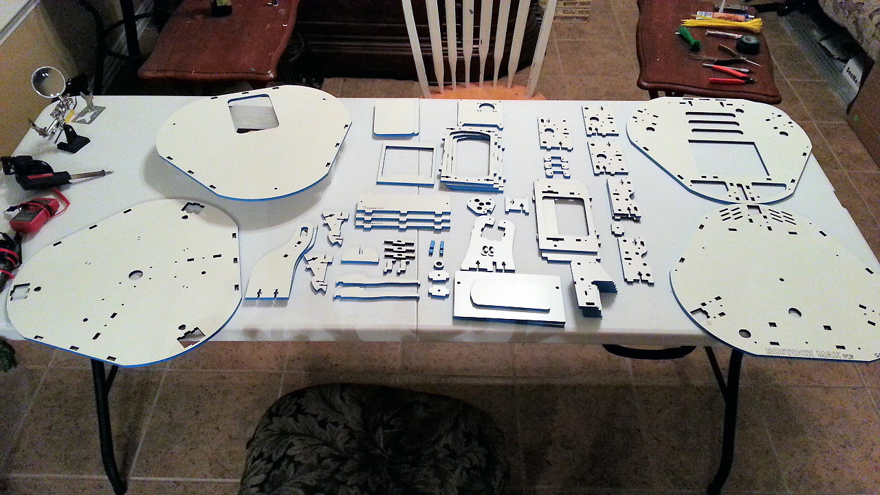

Hey all, so I got my shipment in today. I had originally meant to select the black RMV2 but I wasn't paying close enough attention and selected the white. It's all good. I chose to do the trim in a Sky Blue, sort of like the Tower Bridge in London. I think it will look great, but I won't know until it's done. Removing the tape was not a big deal at all and it went fairly quickly. Spraying the trim took several hours though because the paint doesn't like to stick super well to the burnt material so a few light layers are required with about 5 minutes between them to get the color saturated correctly. I wasn't sure which parts were exposed and which parts are not so I did them all while I was in there spraying. Not sure how far I will make it before the weekend as I have a lot of office work to do.

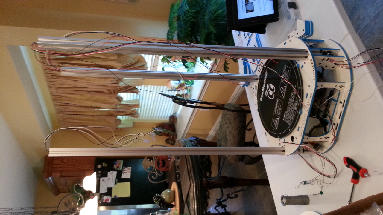

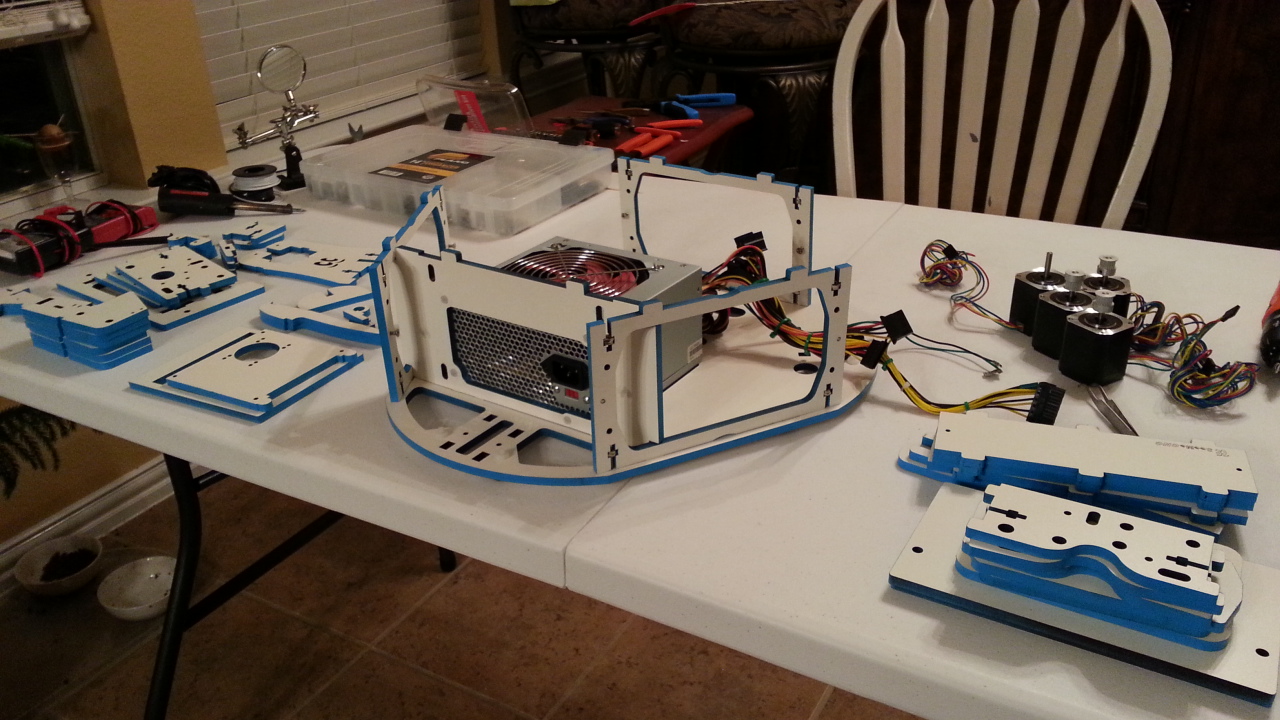

It is starting to look more than just parts now. Having a blast. Only thing that tricked me was the powersupply did not have the type of cables shown in the pics. Got that sorted out as best I could by sticking with yellow and black. Next up is towers and to install the cork dampers on the motors.

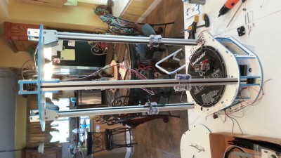

Movin movin movin....getting further along everyday. I am putting plugs on the 18 and 24 guage wires that connect to the hotend so i can swap it out easier later on with other things. Not sure why my phone likes to rotate the image when attatching. Doh

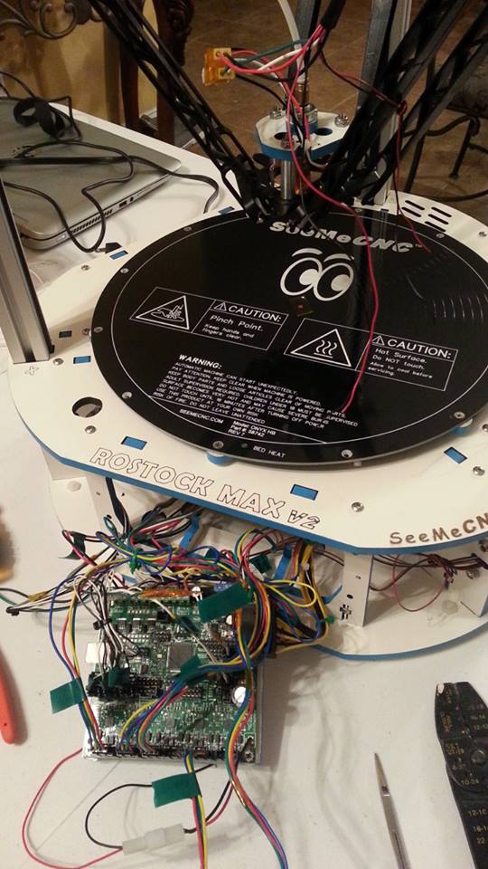

What a beautiful mess, what a beautiful mess I've made...
So, here is a pic of the pre-installed RAMBO board. It feels like wires are flying everywhere despite my efforts with lots of kapton tape to control the madness. (I love that stuff by the way. Best. Tape. Ever.) Maybe, just maybe, I'll be able to plug it in here soon and hope to everything electrical and holy that it works. If you can smell the electronics, then you have done something very very wrong, (at least in my experience).

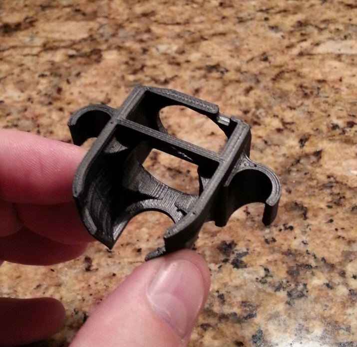

I printed the PEEK shroud successfully. It came out pretty close to flawless. I am absolutely blown away by the print quality of my first print. What a great manual! Thanks Seemecnc! Now, onto the layer shroud so I can use this roll of PLA I have.
Re: Agisis's Blue Build
Agisis wrote:I printed the PEEK shroud successfully. It came out pretty close to flawless. I am absolutely blown away by the print quality of my first print. What a great manual! Thanks Seemecnc! Now, onto the layer shroud so I can use this roll of PLA I have.
A great first print! Your build and calibration is excellent!
Thanks for proving that it can be done.
