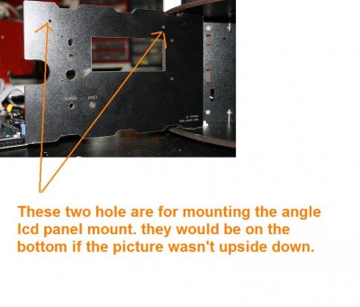

* Examined mounting the LCD panel when I noticed the LCD door was upside down and backwards!! Sonofa..... I ended up deciding to rest the printer upside down (yikes!) and loosen the screws on the base plate around the door. Took a bit of effort and some knicked up wood, but I got it out and flipped around. What I thought would be a catastrophic event, wasn't so bad, maybe 5 minute setback. phew!
[img]http://farm9.staticflickr.com/8245/8579 ... f30f46.jpg[/img]
Despite my experience and soldering practice extending the Z motor wires and the PCB connectors with this new iron, I somehow managed to melt the center pin of the power switch, thereby shorting the switch!
Of all the things to mess up on, it was a simple/cheap power switch
- phew, thank god. I contacted support to see if I can get a replacement for that, but in the meantime I had a spare toggle switch to get me by for now, but I'd rather install the original switch.
Another hour or so tonight to connect the hotend wires, and this printer will be ready for final assembly! Finally, I have a whole weekend to power up the machine and start calibrating it!
Does anyone have a link to a manual or pictures of installing the LCD screen at an angle? I can't figure out how the lcd mounts to the angle brackets.

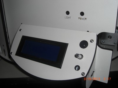

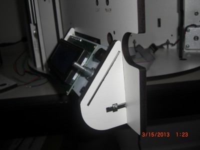

Re: Cassetti's black Rostock MAX build
Cambo3D's build contains the best pictures of how he mounted the LCD at an angle. That's probably the best source that I have seen.
Finishing up the final assembly tonight, powering up tomorrow afternoon!
I have been looking all over, but I still can't find any info on how to physically mount the LCD panel to the standoffs - I have seen pictures of the standoff's in their proper mounting position, and the lcd panel mounted, but there are no screw holes that match up wth the panel itself...
Edit, now it appears to be a ressure fit, but then how does the wood panel fit? How is that secured?
Also I just noticed my LCD cables don't reach from the LCD door to the electronics door! Guess that means I need to move the Rambo board, any suggestions where to move it? I assume it must be mounted on the LCD door?
my photo lcd slides into the slot in the angle mountscassetti wrote:Finishing up the final assembly tonight, powering up tomorrow afternoon!
Thanks, but how does the wood face plate mount? The holes that match up are covered by the standoff
And my lcd cables are too short - need to find a new mounting position

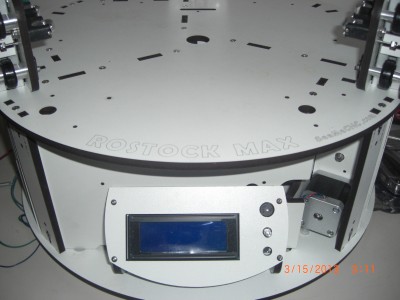

i drilled holes in it to match the holes in the lcd, then screw the faceplate on through the mount and into the lcd holes.
If you do this, be careful not to split the angle standoffs, get them aligned as best u can so all your holes will line up.
there are small 4-40 phillips screws included for mounting the faceplate.

I was afraid of thatcambo3d wrote:i drilled holes in it to match the holes in the lcd, then screw the faceplate on through the mount and into the lcd holes.
If you do this just have to be careful not to split the angle standoffs, get them aligned as best u can so all your holes will line up.

cambo3d wrote:yeah not my favorite design either. They should have the lcd mounted to the faceplate. Then make a standoff that mounts the faceplate to the door.
I did mine a little differently, I used the bottom two holes that the lcd would mount to if you put it flat in the door. I had to drill them out, but the standoffs then slide over the board holding it in place. If I can get flickr to let me upload, I'll post pics.
