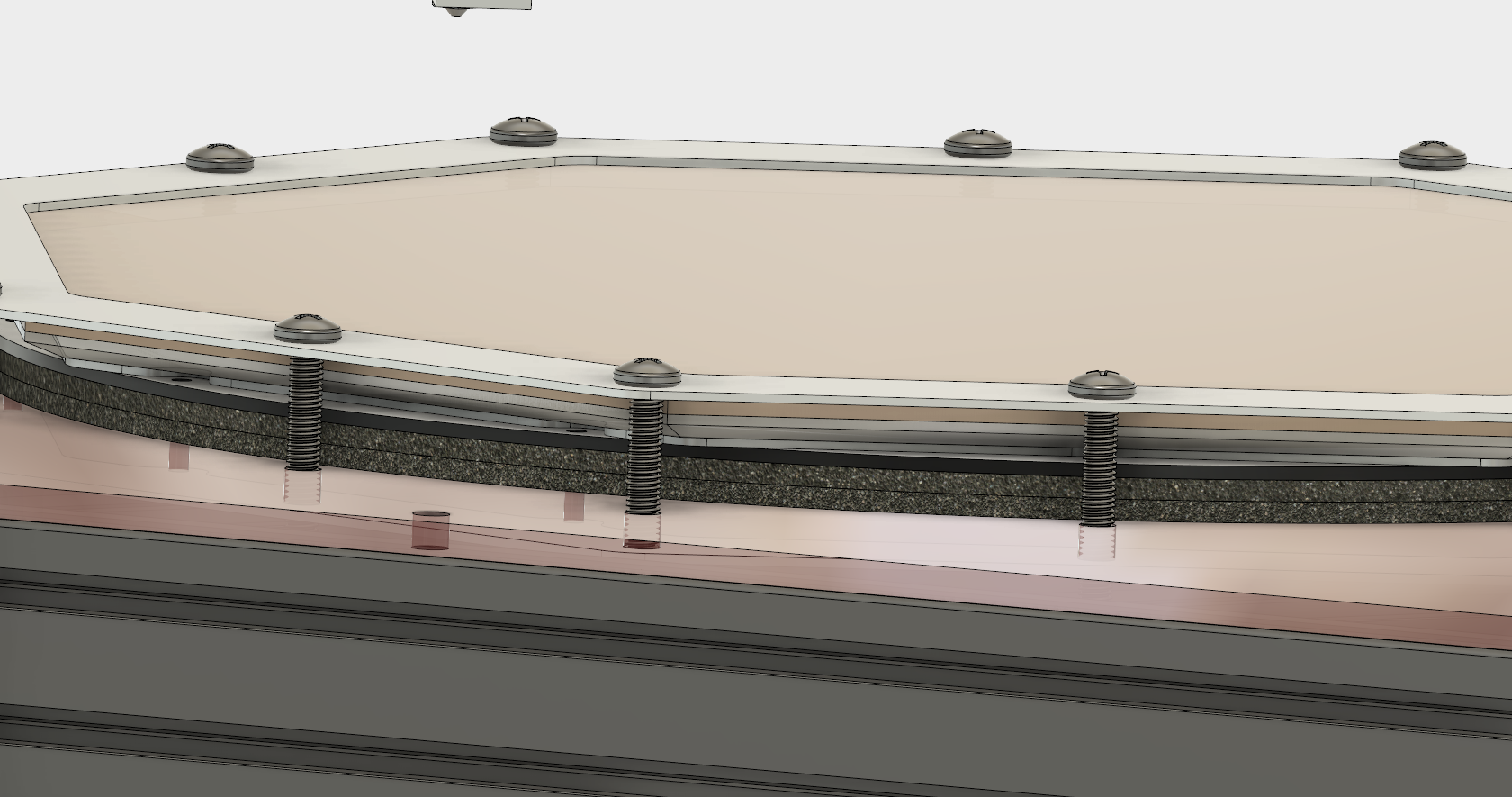

Let me know how that goes. I've been designing a delta machine, and a lot of it is based off some of the experiments you've been doing. So thank you, you're very inspiring. Speaking of layers:
From the top down: Aluminum retaining ring, PEI, Octagonal mirror ($10 at michaels), aluminum heat spreader, Onyx Heat bed, two pieces of cork, and an acrylic (red) base. Second retaining ring underneath that also mounts to the onyx bed. Does that seem like a good heat bed sandwich? Where would you put the thermistor?

Wow that looks great. What I'm seeing is a Onyx mounted thermistor reading of 100c followed by the aluminium heat spreader & borosilicate glass showing 20c cooler at the surface. I believe the temp reading at the thermal conductor in the middle would be optimal. although that should in theory increase the actual temp of the Onyx and I'm not sure what the rated range it was designed for. Right now, if I want a true 100c top surface I have to heat to around 120c.
I like the idea of the cork at the bottom of your layers. Is that to insulate the heat from the acrylic or give fine adjustments to leveling the surface?

Interesting - I didn't know the discrepancy was so big. I run "100" to "110" so I'm guessing I don't even come close to 100 at the surface on my rostock.
Yeah, the cork is to protect the acrylic from temps. No fine adjustments in the bed other than equally torquing the retaining ring. Now that you mention it, I guess that would give me some flexibility to do micro adjustments, by compressing the cork more or less. Hmmm... my original thoughts were that the acrylic will be the fairly rigid and flat surface (.250"), the cork would simply protect it from heat (and help the bed heat up faster), the onyx will be mounted rigidly to the bottom retaining ring independent of the top retaining ring. The top retaining ring is just to hold the PEI flat against the mirror, because I don't like gluing the PEI down and the sheets come with a bow to them.
